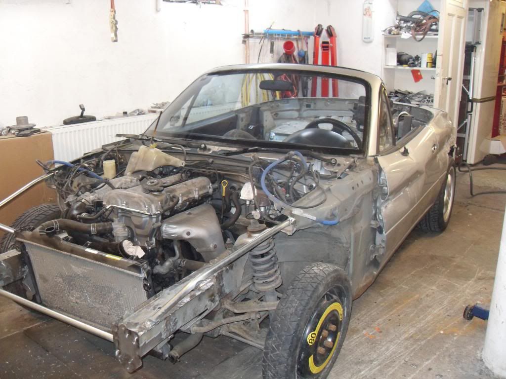

Payed Chris the doposit a couple of Days ago. Found a -91 Miata 1.6 that was pretty low milage (110000km) cheap. But it was used as a test car for some kind of new roadfence, so i started out this weekend bending out the front frames, and fabricating some bars for ridgety. Hope it will work with the body...

Good luck Andreas, that poor Miata looks like it has seen some action so I wish you well.

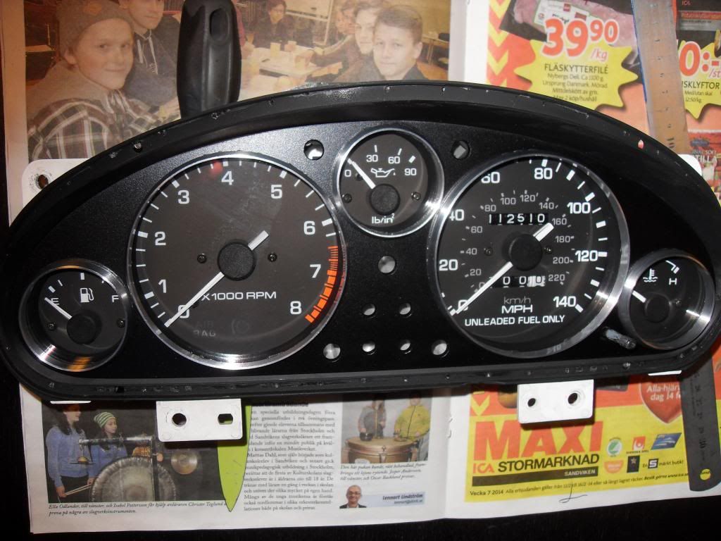

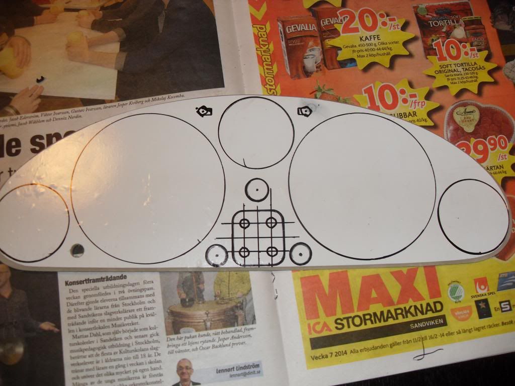

Pulled the guage cluster yesterday. Somehow it doesn´t look 60´s to me. I just want the feel of a 60´s car, and the look of separate guages, not a cluster. So i started working a bit with it.
The standard (pretty ok) cluster
Pulled it apart...
Bended of these from surrounding
Gently bended glass of
Made a template of thick paper. Also marked and punched a hole for reset button
Made a plexi piece after the template(White protective on it). Used a bandsaw
Bended this of as well
Marked out on the plexi using the surrounding where to drill holes for Control lamps
Drilled
Pulled protective of finished plexi. Put it back on where it came from, to be used again
Cut out the circles from protective an put em back on glass
Paint! Used very thin (almost dry) layers to prevent from sipping under protective vinyl
Machined aluminium rings, polished and clearcoated them. Glued them with blach RTV silicone(used for Engines etc). The White protective is on backside only(for scratches). Used very small amount of Silicon. Some sipped out, but can be removed later.
So. Rings on the glass! Just have to wait for lenses to the conrol lamps, ordered them on ebay.
Another... Thats it for today! Cheers

Wow I really like you're attention to detail.
Looking forward to seeing the lenses from eBay as well.
Well done!

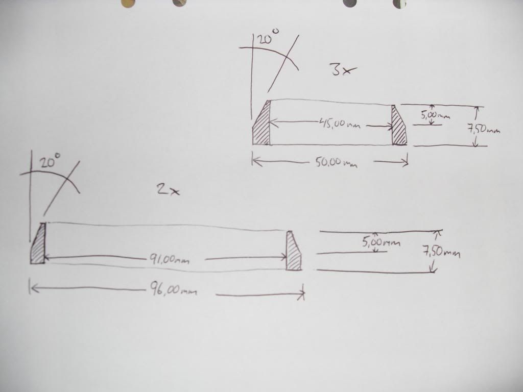

The results are great!, tell us more about the rings, are they an offcut of alloy tube , were you able to machine them yourself (yes I had considered cookie cutters to try to get the same type of result!).
13th February 2014, 07:48
Join Date: Feb 2014
Location: Sweden
Posts: 140
Thanks for the comments!
I machined the rings from alloy tube and bar, then just polished and clearcoated. Se my amateur drawing!
Best regards Andreas!

Lovely dash, really well done. Car should look quite special with attention to detail like you have!
13th February 2014, 18:57
Agree with Scottie on that, dash is looking a whole lot more retro.

Hi Andreas,
I love what you have done. I am planning tu use the MX5 instrument cluster on my Sammio and am looking to do something similar. Did you need to put a small spacer between your black plexi and the original black plastic? On mine, the centre of the instrument needles sits slightly above the black plastic, so I cant just put a piece of flat plexi across the face of the gauges.
I hope this makes sense!

Glad you like them!
Thats terrific Chris i´ll cal u tomorrow!
No i didn´t need spacers, but just put some there and your ready to go!

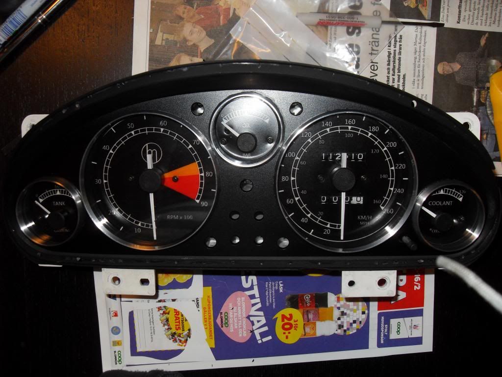

Looked at guages and yes, new more 60´s needed!
So started making new faces, scanned stock ones and modified them in paint.
New faces!

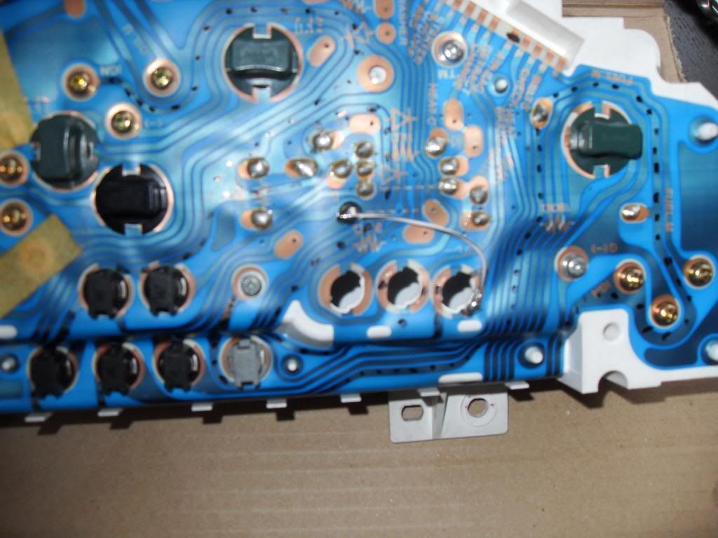

Had to reroute a wire on the back of cluster. It is the airbag lights. This is not possible this way if you got abs as i think it uses this blank light that i used on mine. Got a no ABS car. Reason why i did this is because of the hanging needle on tacho. The Airbag light is on the bottom of Tacho face.

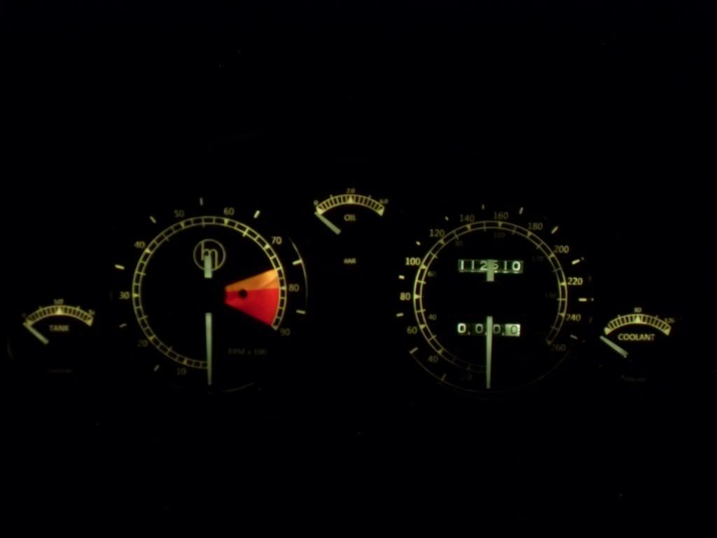

This is how it looks in the dark. Guagefaces are made of 4 layers transparent overhead film, and a White addhesive vinyl on the back. So it lids up as the originals...
