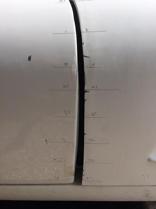

The door/bonnet gap
As you can see from the picture the alignment looks pretty good, it looks good but you can't open the door
Two problems, as you open the door the leading edge of the door (LED) hits the inside of the trailing edge of bonnet (TEB) To stop the LED hitting the TEB I have worked out the best way is to "thin" the TEB and also taper it. Before doing this I found that when opening the door, the face of the door would hit the TEB, you obviously can't remove any of the front surface of the door so it has to be removed from TEB.
I noted where it was catching and ground away at the TEB with a mini belt sander.
as you can see I have ground away about 25mm from the bottom of the TEB tapering up to about 8mm at the top. At this time you start thinking "is this right?"
I then marked lines across the gap and measured how much I needed to add to LED.
I then drilled pilot holes in the edge and fitted some drywall screws, screwed them in until they protruded to the measurements on the door and then nipped off the ends with a disc cutter.
I then placed a plastic L trim behind the screws to give me a need edge and back filled with isopon GRP filler
i did this in two stages as it was easier to get round the bend.
Then mark the gap on the new filler and run along the edge to get the approximate profile.
Then rehang the door skin.
I then turned my attention to the trimmed TEB, the edge is much too thick so I again attached it with the mini belt sander.
From this thickness
To this
The thickness is the white line, the grey is the taper.
Refit bonnet and this is the result
Obviously I now have to neaten it all up and get the gap the same all along but the door now opens and closes without catching anywhere even with the door fully open.
The GRP filler with the drywall screws seems to have given a really strong bond which I don't think should crack in the future.

This is the only logical way that I could see to get the door to open without rubbing, unless someone has an easier method.
It would only need a modification to the outer doorskin molds, the inner returns could be left the same and the TEB could be reshaped with a belt sander in a few minutes if you had a template.

I should have mentioned that I cut away the first 30mm, I've left the rest as this is where I intend to run a wire cable for emergency door opening.
The thread is here to help everyone so all are welcome to voice their opinions, just try and keep it civil. It's very easy to write something innocently and for someone else to take it completely the wrong way.
If anyone see's something that I have done wrongly please jump in an correct it or suggest another way, I'm old and ugly enough to take a bit of criticism.

Not sure if this is relevant, but would changing the hinge arrangement allow the door to open in a different way so as not to foul the bonnet/wing?
This is the way I had to sort my similar problem on my build, and it worked.

Shame to change the standard hinge as it works so well.
I was surprised how much modification has been needed as nobody else seems to have reported any problems, but I can't see another way of doing it.

I think it would just add another problem.
I gave the front of the door another bit of GRP paste that has closed the gap up further without catching. A bit more sanding and a bit of filler tomorrow should see the first door almost finished.

He has not hacked bits of the door, he has added to them to make them longer to close the large gap up.
The hinges work fine.
