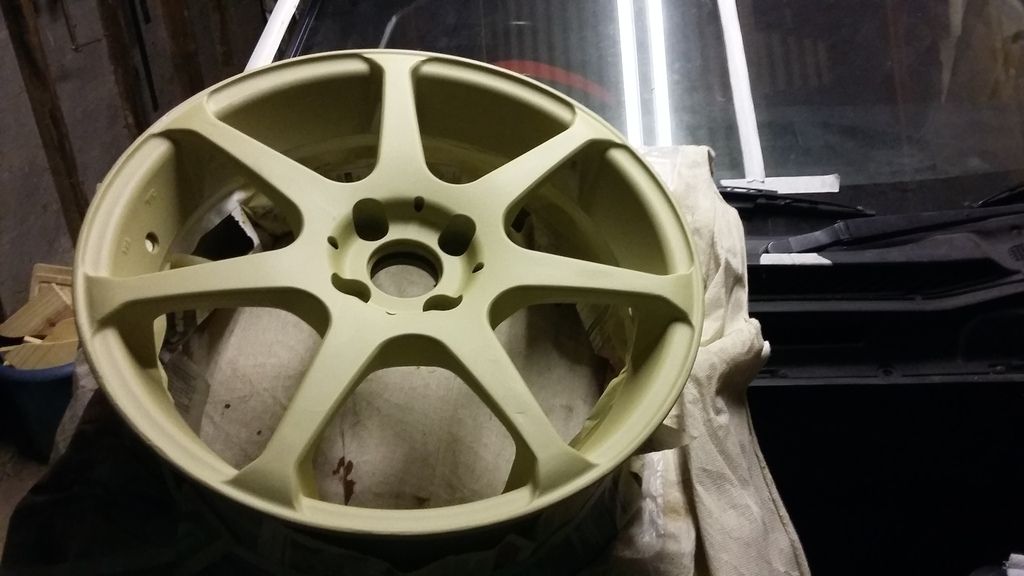

2 x prepped wheels. Came out even better than expected! No idea what colour I should so for. I think they can only be gold, white or the rota bronze colour. Anyone?

28th December 2016, 16:05
Join Date: Sep 2016
Posts: 326
They look great so far - I am going with white alloys for mine
29th December 2016, 06:33
Join Date: Mar 2016
Posts: 26
Your choice... but personally always liked white wheels on rallyesque cars.
