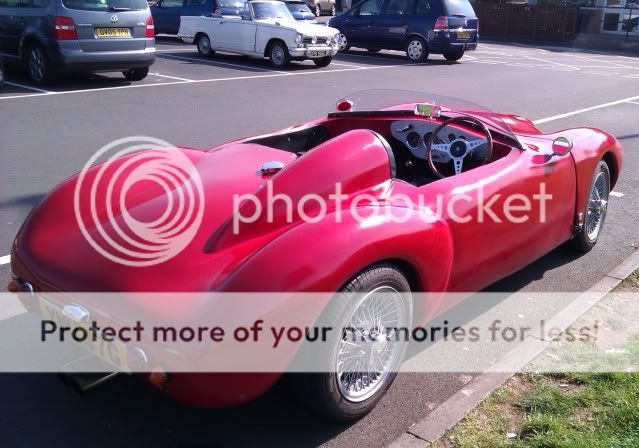

I also stopped on the way back to meet up with Lee (a prospective Sammio owner) and it was nice to see an un-Sammio'd Herald roll in
Next trip i think should be southbound to see if i can find and other Sammios "in the wild"

Before and after
I thought it was ace that when I was talking to you that old guy drove up, stopped and got out with a camera and then started photographing your Herald! He would have had a breakdown if we'd told him what you were considering
