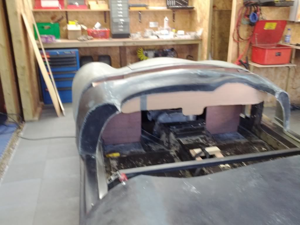

Templates
Good thing about the forum is that now my son Charlie and fellow builder has gone away to work for three months I can keep him informed of the progress whilst he is away, so Charlie and all others this is what I have achieved over the weekend.
Making templates, cutting, fettling, screwing, sawing, adjusting, drilling, bolting etc etc. I do like templates and have kept them for any other G46 builder who may need them into the future.

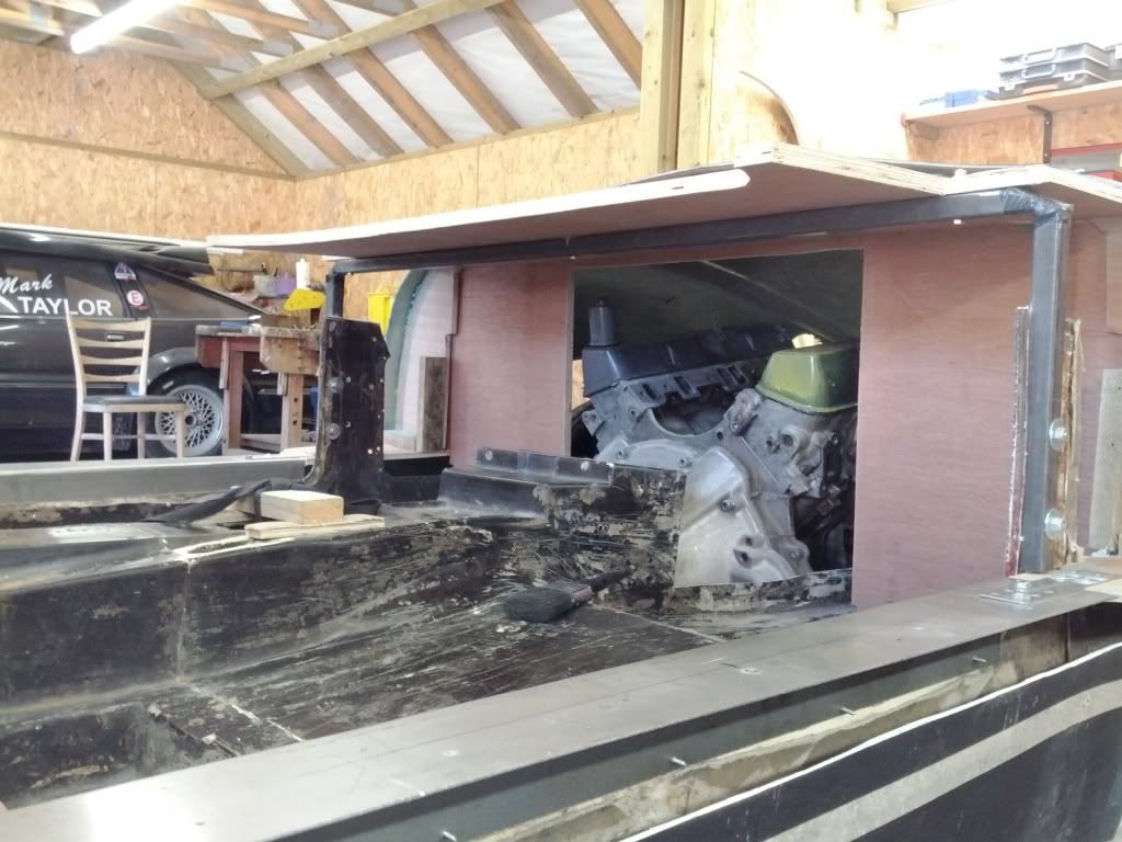

First I made a new bulkhead on 20mm ply to replace the one cut out in the last post.
[IMG] [/IMG]
Still has temp support at the back.
Once I had this in place it seemed obvious to make up a top plate also in 20mm ply, this is fixed to the bulkhead and then bolted to the metal H frame which in turn is bolted to the scimitar floor plan, makes the whole front section very very strong.
[IMG] [/IMG]
The ply top plate will also accommodate the repositioned pedal box with the reservoirs bolted to the engine side of the bulkhead, The steering column will also be bolted through this as well.
[IMG] [/IMG]
I was also able to cut the ply top plate so it came past the H frame and then shape around the cockpit/dash curbs.
[IMG] [/IMG]
The repositioned bulkhead also uses the ply top plate to relocate it. All door apertures being checked as work proceeded.
[IMG] [/IMG]

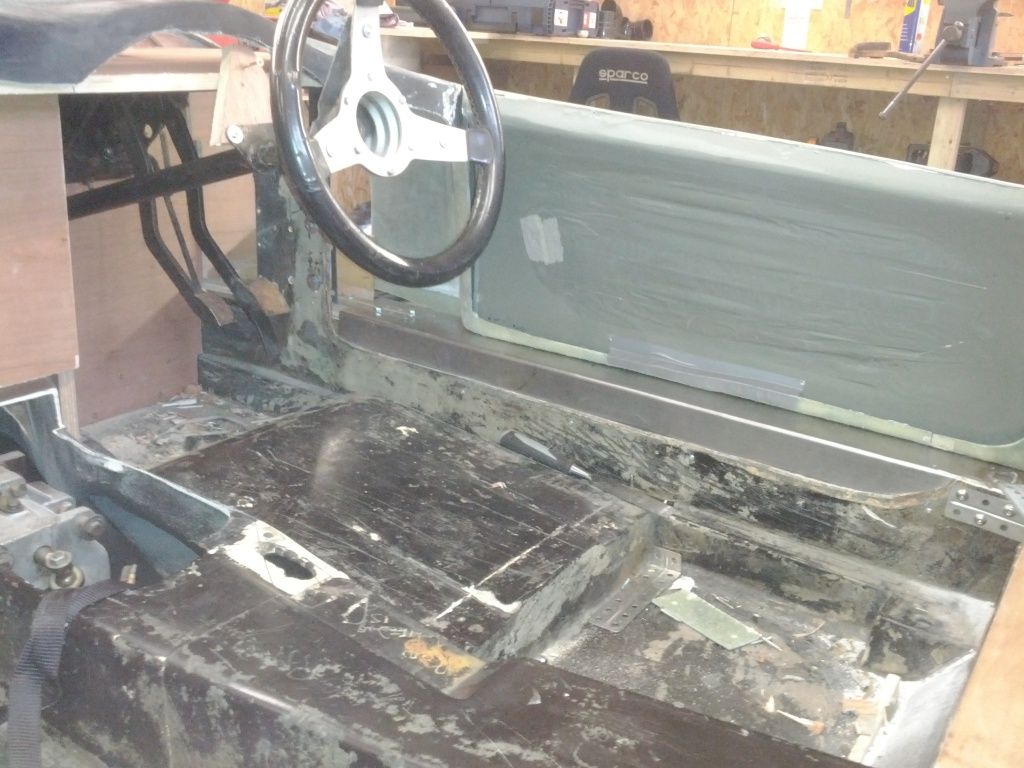

I could not resist making a template for the dash board this was only knocked up at the end of the day and is not the final form, but I will keep it simple like a 289 cobra dash lay out.
[IMG] [/IMG]
Shot of dash from a different position.
[IMG] [/IMG]

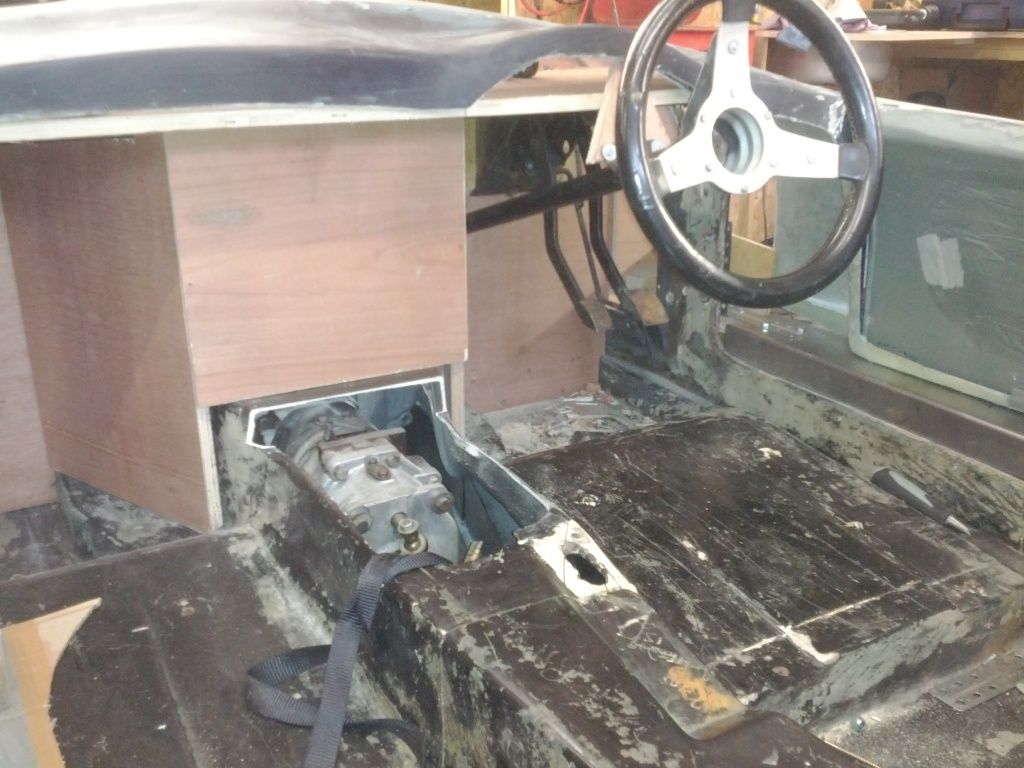

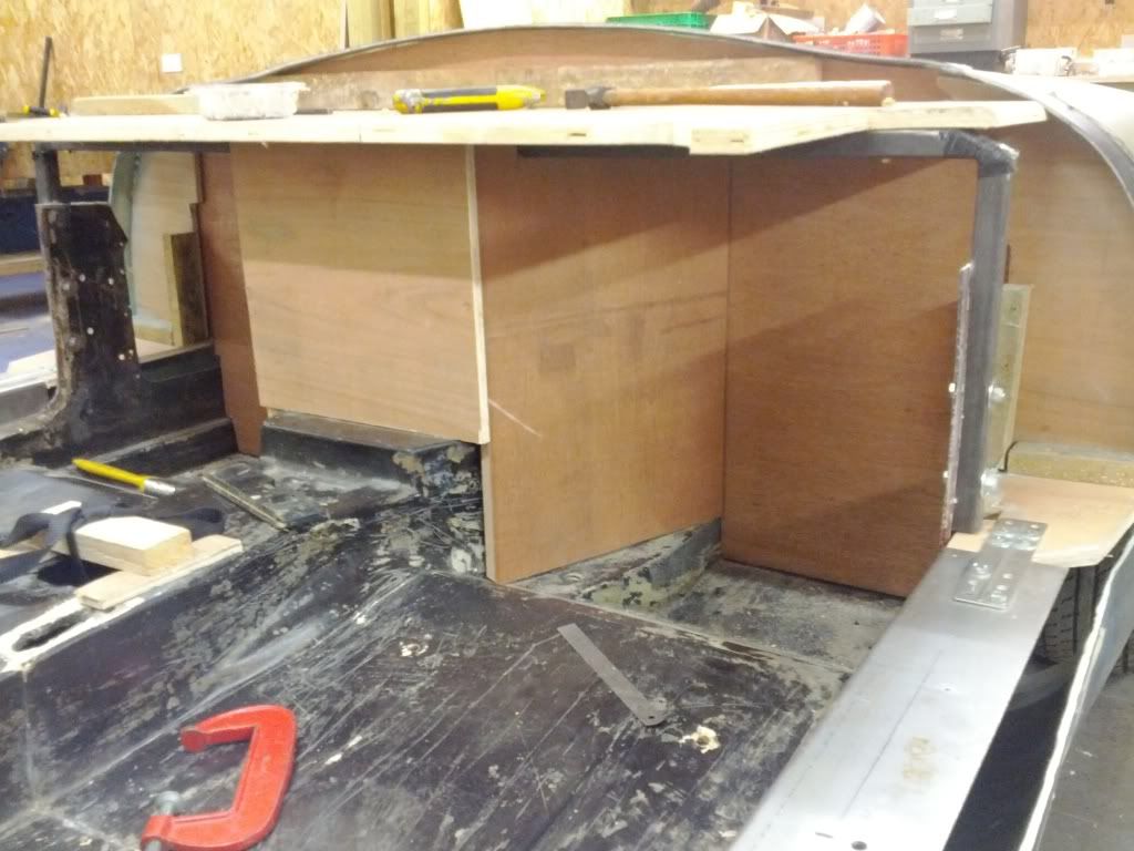

bulkheads

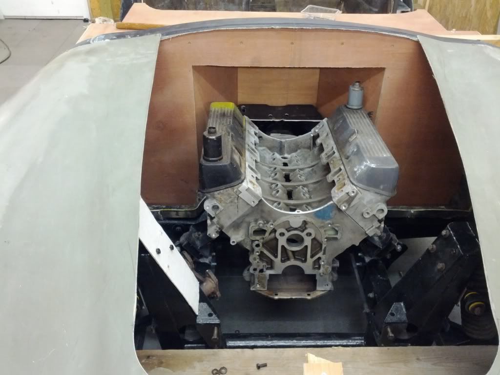

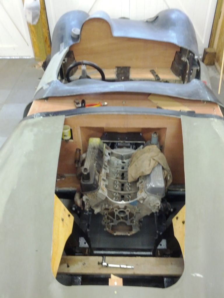

If you see my last post I am now happy the the cut up front panels will all work well so I have taken them off again to finish what I call the front structural bulkhead.
[IMG] [/IMG]
From inside the car sides of tunnel being formed all square, plumb and level. All pinned and glued.
[IMG] [/IMG]
From inside the bonnet plenty of room behind the engine, may use as secure glove box accessed from the cockpit with a little more ply under the bonnet.
I will now concentrate on the outer side footwells and then go to the back bulkhead behind the seats and get all the ply work done before I start to fibreglass.
I also have to reduce the floor pan where there was a hump under the original drivers seat.

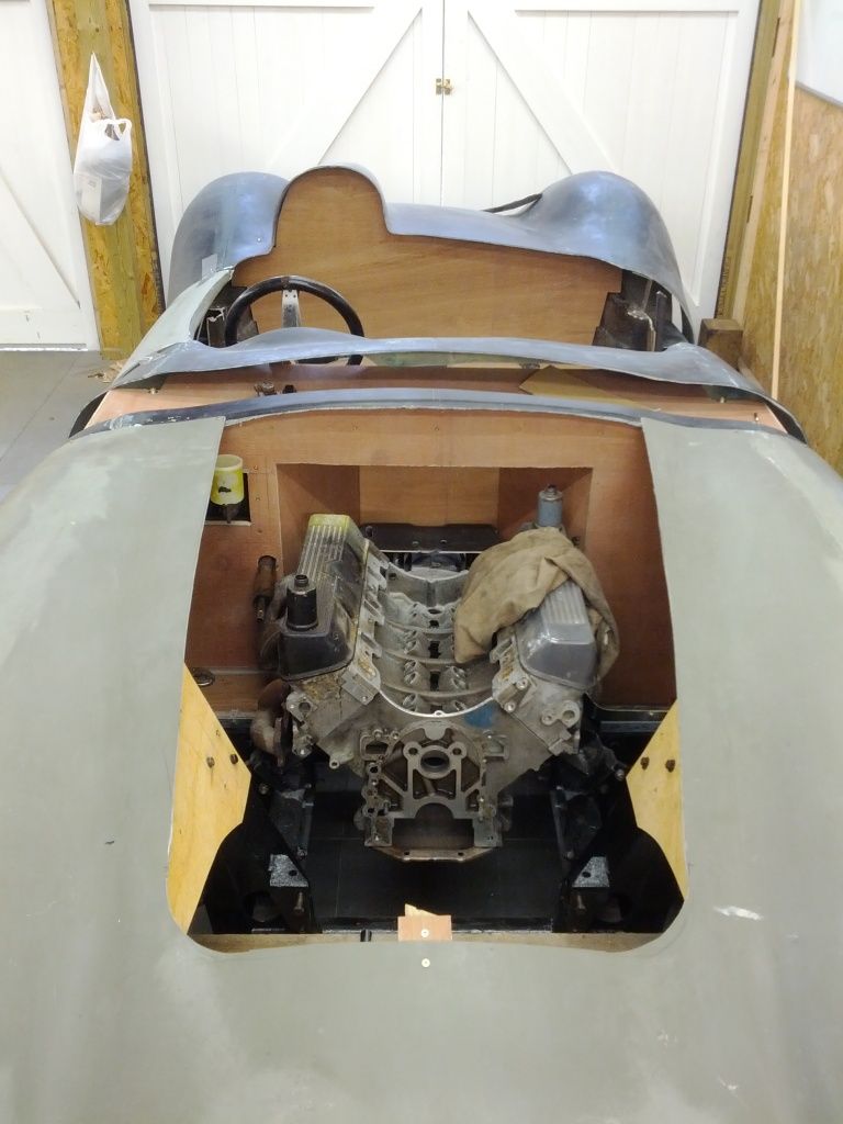

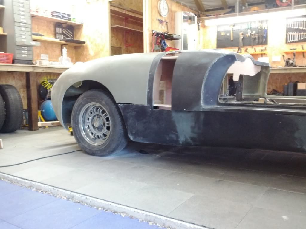

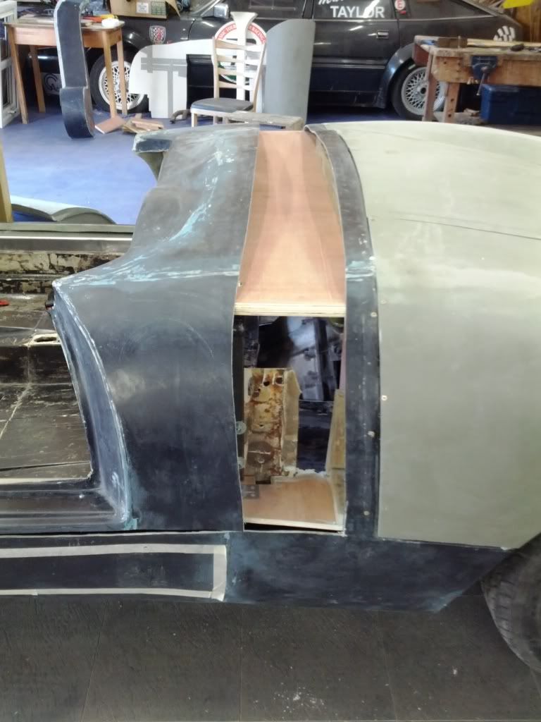

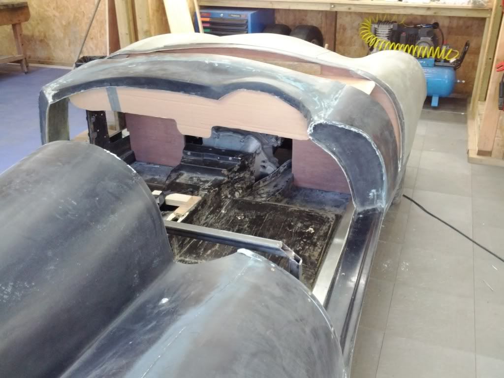

Progress over the last couple of weeks
Progress is a little slow but very enjoyable I am alone until Charlie returns in a couple of months and this update is for him as well.
There is a lot of work with template's shaping adjusting stripping down taking off re fixing etc etc etc.
[IMG] [/IMG]
This shows the front and rear bulkheads cut and temp fixed into position with screws and glue and the body temp fixed back on around the ply sections.
[IMG] [/IMG]

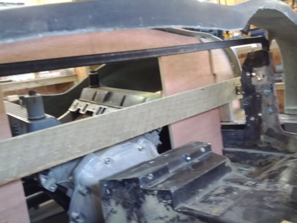

I have now positioned and fixed the pedal box in place, but the floor will need to be reduced under the peddles. I have judged the wheel position by sitting in the car and seeing if it fitted my arms? even thou we moved the bulk head back 200mm I am only going to need to extend the steering column by about 150mm
I have also worked out the route for the manifold and exhaust so it misses the brake & clutch master cylinder and steering column, meant changing back to an alternative manifold and a lot more cutting. You can see in the pictures why a blister is needed to gain access to the reservoirs.
[IMG] [/IMG]

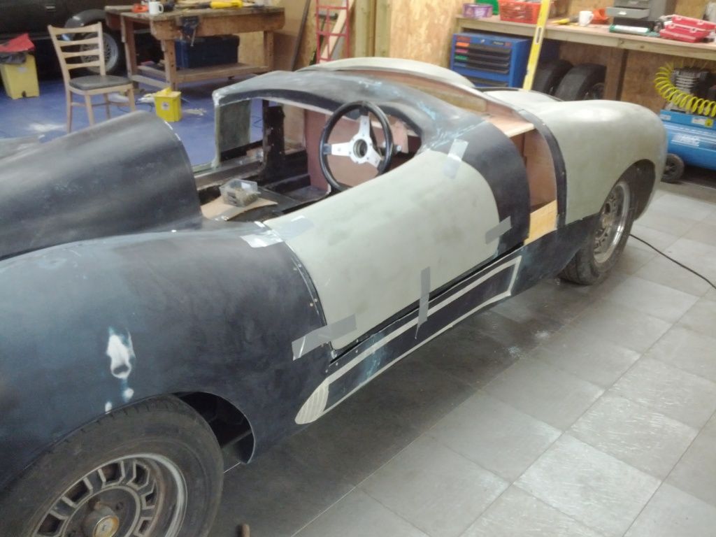

Sowing the inside of the door, the door fit is remarkable good wont take much for a prefect fit, I would like to have concealed door hinges if that's possible used some on the 289 I built which are available from Europa sales, but I am sure they will be challenging to fix.
[IMG] [/IMG]
My photos do not do the car justice with the door taped in the sweep back over the front wing, bulkhead top of door line to rear wing is a delight and accentuates the "coke bottle" shape
[IMG] [/IMG]
I have shaped two swooping brackets template in 4mm ply to be laser cut in steel which bolt to the suspension turrets and will bond to the underside of the bonnet with a cross brace between the two.
My current thinking is to carry on with the body shell and once I have everything shaped then to let loose bonding all the play to the existing fibreglass tub. The engine and gear box are only dummies and I think once the body is complete to hoist off the car, it is all integral on the tub and then fit the engine box etc etc.
With the body off I will then be able to glass up behind the panels joins I will not be able to reach while it is on the chassis.
