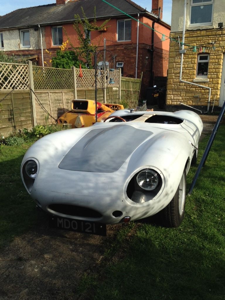

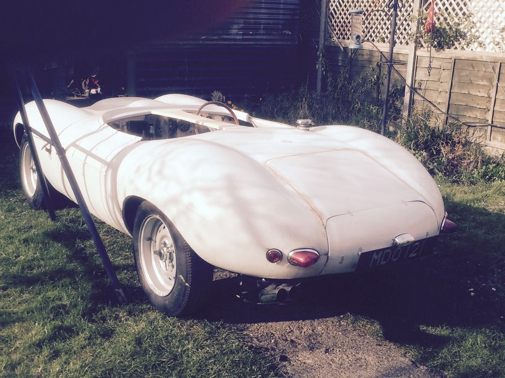

You need to also send a filled in 627/1 form and two pictures , one before , one after , both showing the registration number , if possible ...
1st April 2017, 06:40
Join Date: Nov 2012
Posts: 845
V627/1 Evidence
I only had to send these two pictures of the re-bodied car - one from each end showing the number plate.
It went through without a problem, perhaps I was lucky as the base Spitfire has been registered in my name since 1975?
Regards, Mick
