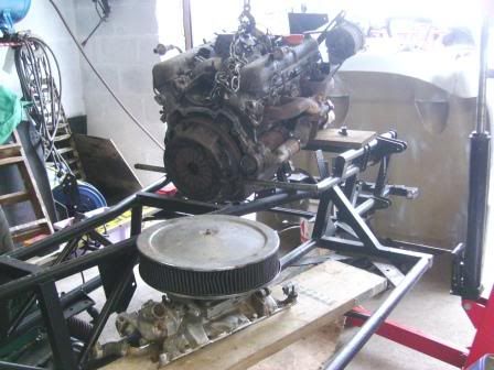

Today I slung a spare V8 over the chassis
Only to find that it dosen't fit
After removing the exhaust manifolds and snapping three of the sixteen retaining bolts off I found that the engine would just squeeze in between the chassis top rails, there being more room at the front than the back.
Problem is that the water pump pulley is in the way and it will not drop down low enough into the chassis at the front as there is a top cross member bracing the chassis where the top shock mounts are situated.
So I decided to remove the water pump and proceeded to snap three more bolts off. Not to worry, I'm not using this engine so not a problem for now.
Next the alternator came off and the wussey power steering pump, well at least it's getting lighter.
Looks like I will have to move the cross member up the chassis a bit or maybe stick a bent tube in so as the crossmember fixing points are the same but giving a couple of inches more forward clearance.
