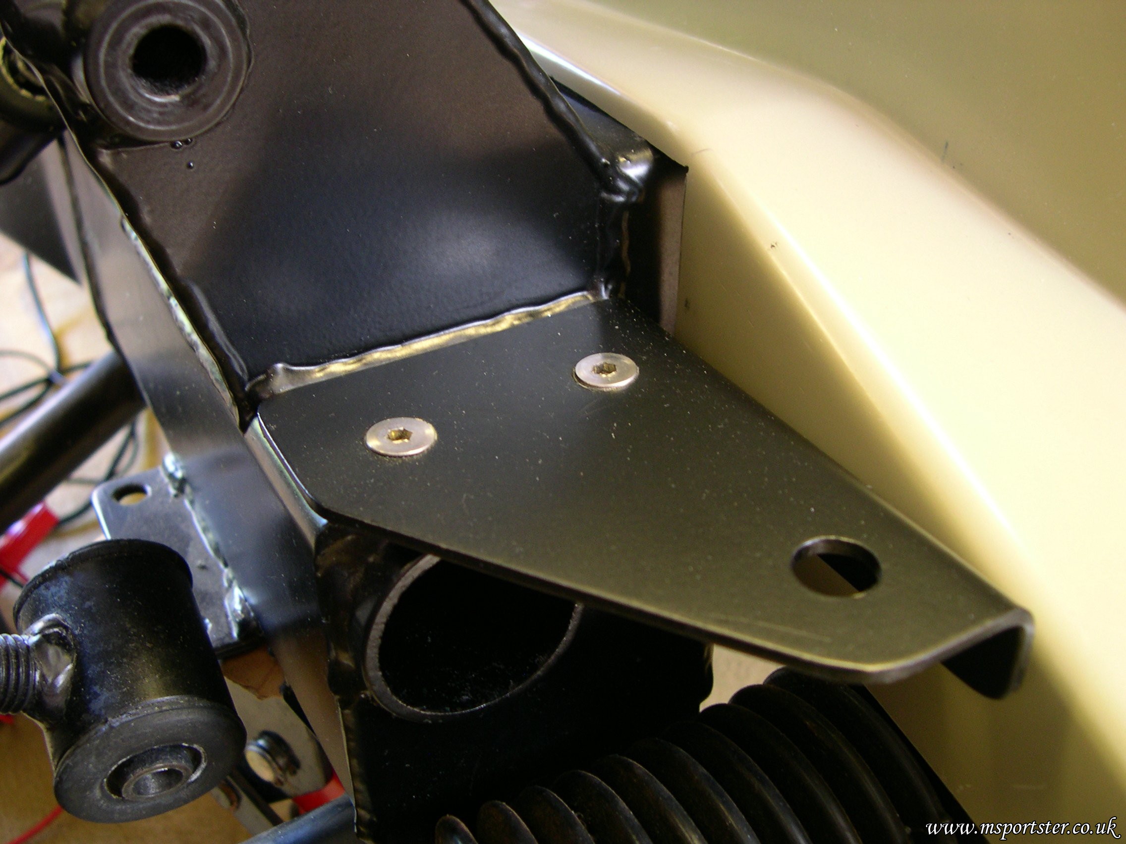

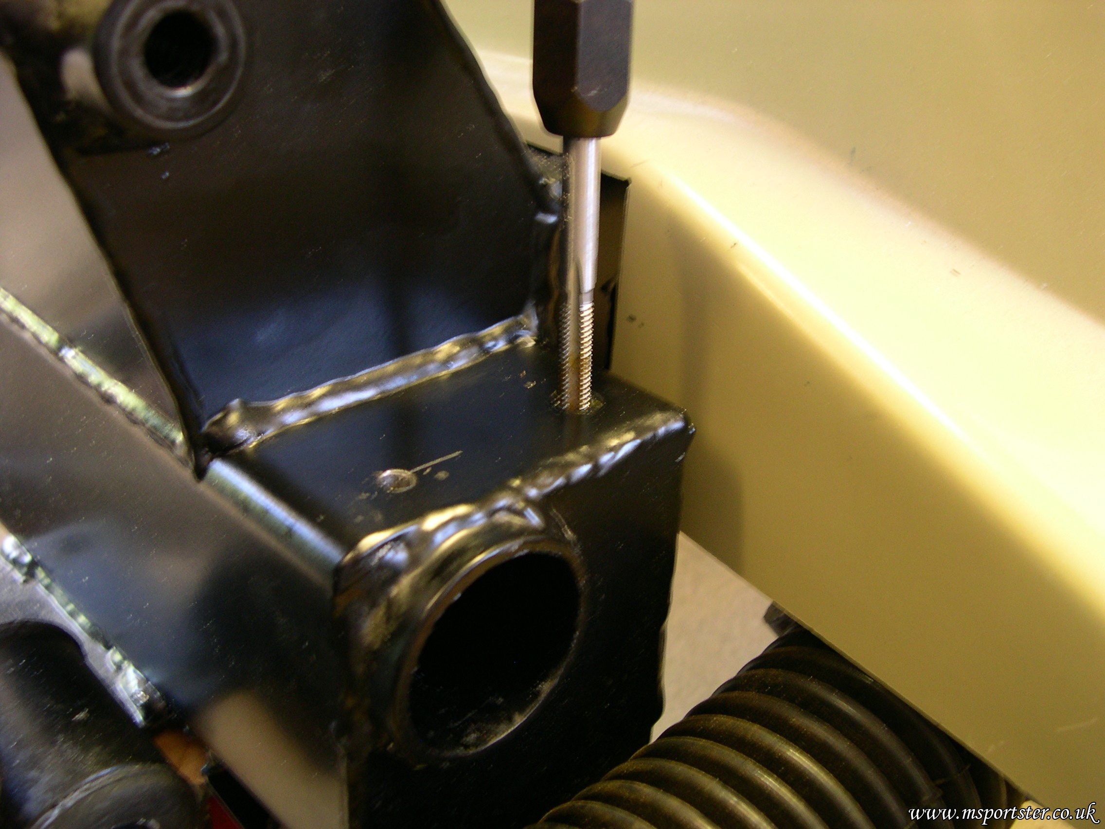

We've not fixed them in place yet, but I think we will go with bolts. The spot light bracket bolts go through where the bumpers slide into the chassis. They will be able to double up for bumper mounting.
