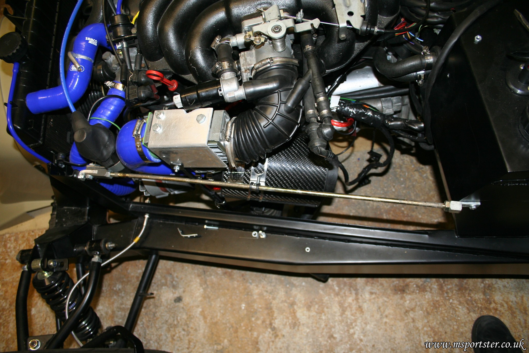

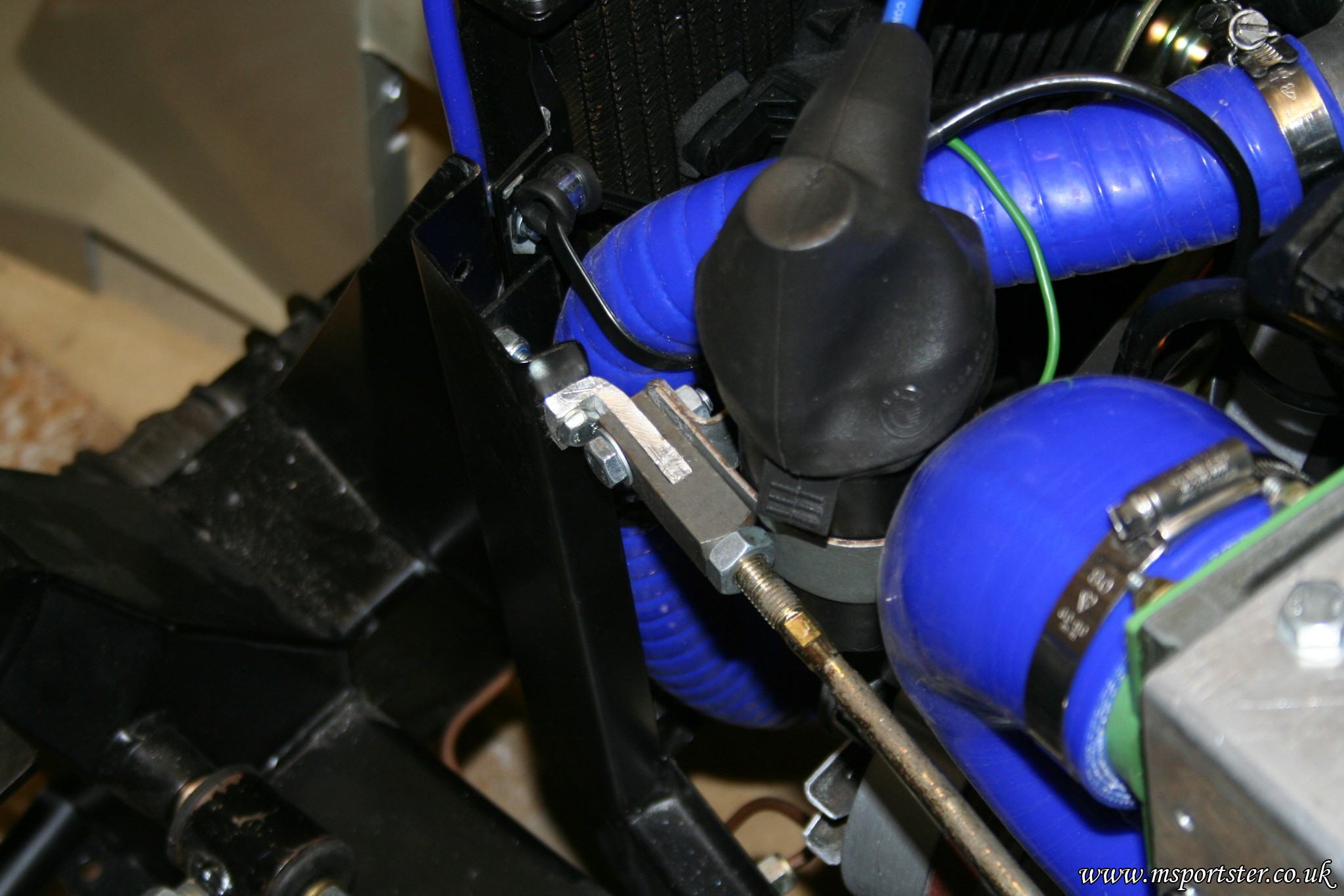

Ours is mounted here:
Plan to put some heat sheild around it. Also the engine wiring loom needed strippping and changing a bit to locate it here.
