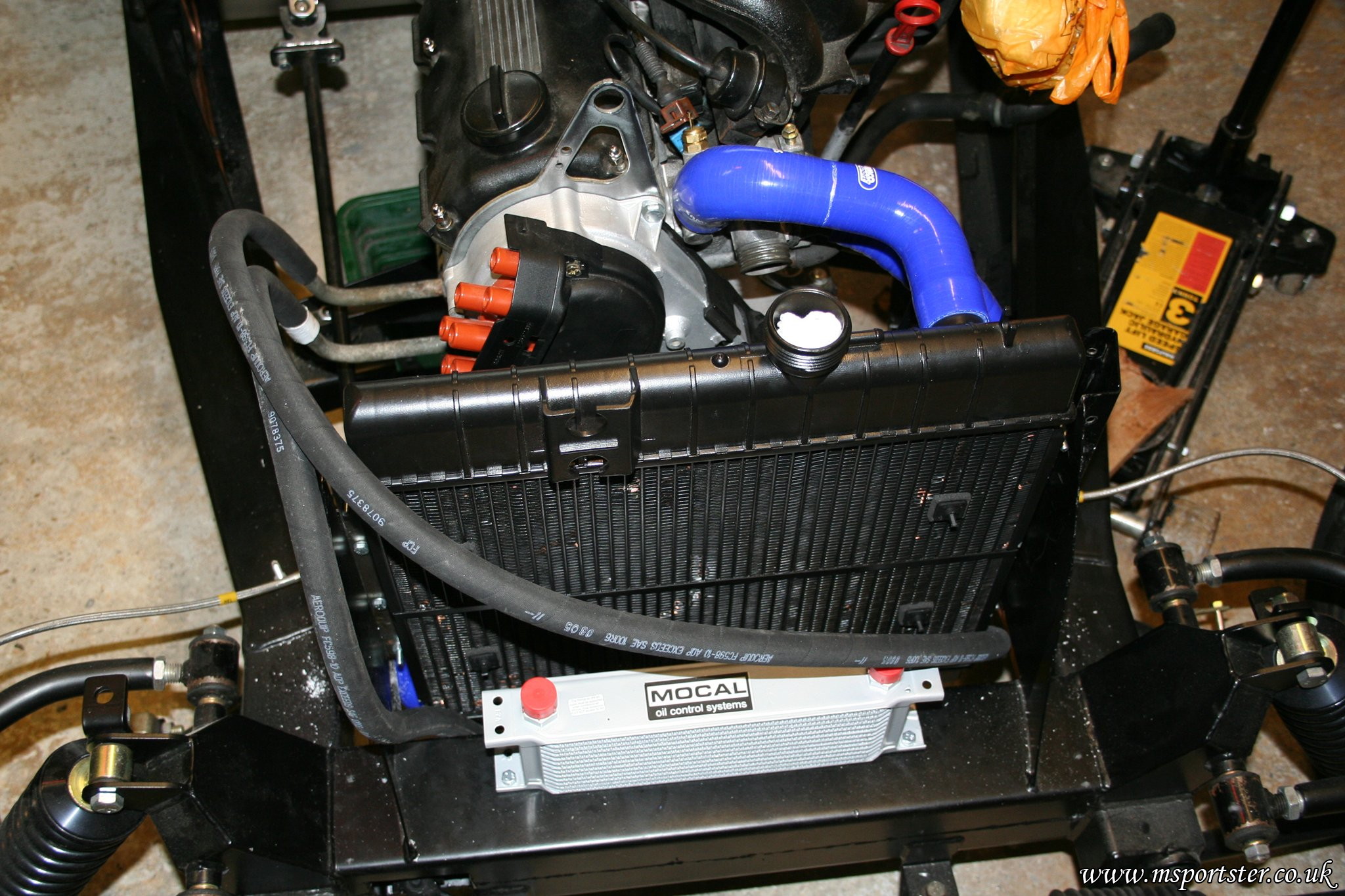

I have decided not to buy Marlin's standard lighting kit therfore I also don't have the little mounting brackets that I assume they also supply. Can anyone post me up a picture of the main headlamp mounting bracket so that I can see what it looks like? I guess it is just an L shaped affair that is fixed with the top damper bolt but it would be good to see a picture.

Yip its a simple L shaped bracket with two holes; one for the head light and one to attach it to the car via the bolt for the damper.
Below you can see the bracket (bottom left side of the picture by the top bolt for the damper.

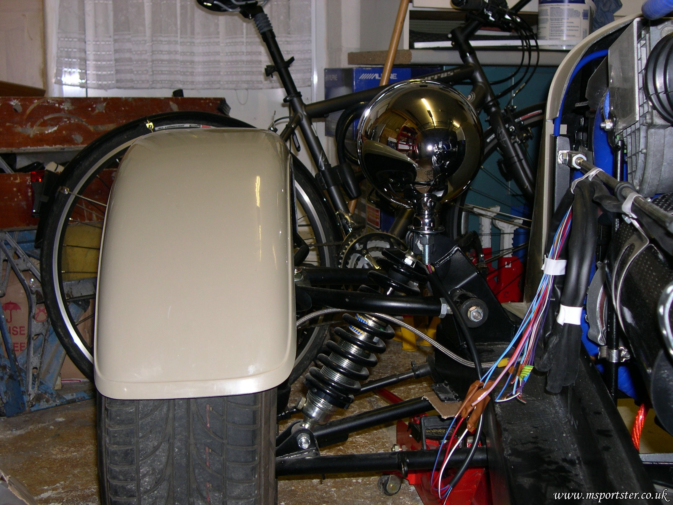

We've gone for rear mounting as its I think its cleaner to run cables, there seems to be a selection of people rear mounting and a selection front mounting.
I put it down to personal taste i think, no right or wrong way :) I think it looks better with that greater staggered look between the spots and the main lights.

I think the "grommet" is a bit of u-shaped rubber to cover the bracket so that it is SVA compliant. A better solution would be to have the bracket small enough so the base of the lamp covers it.
I made a prototype U shaped bracket yesterday but with the weight of the headlamps you get the problem of the headlamp bouncing up and down as soon as any movement is applied to it. I guess the Marlin bracket does the same. So - I might go for something more sophisticated... (Don't know what though).
