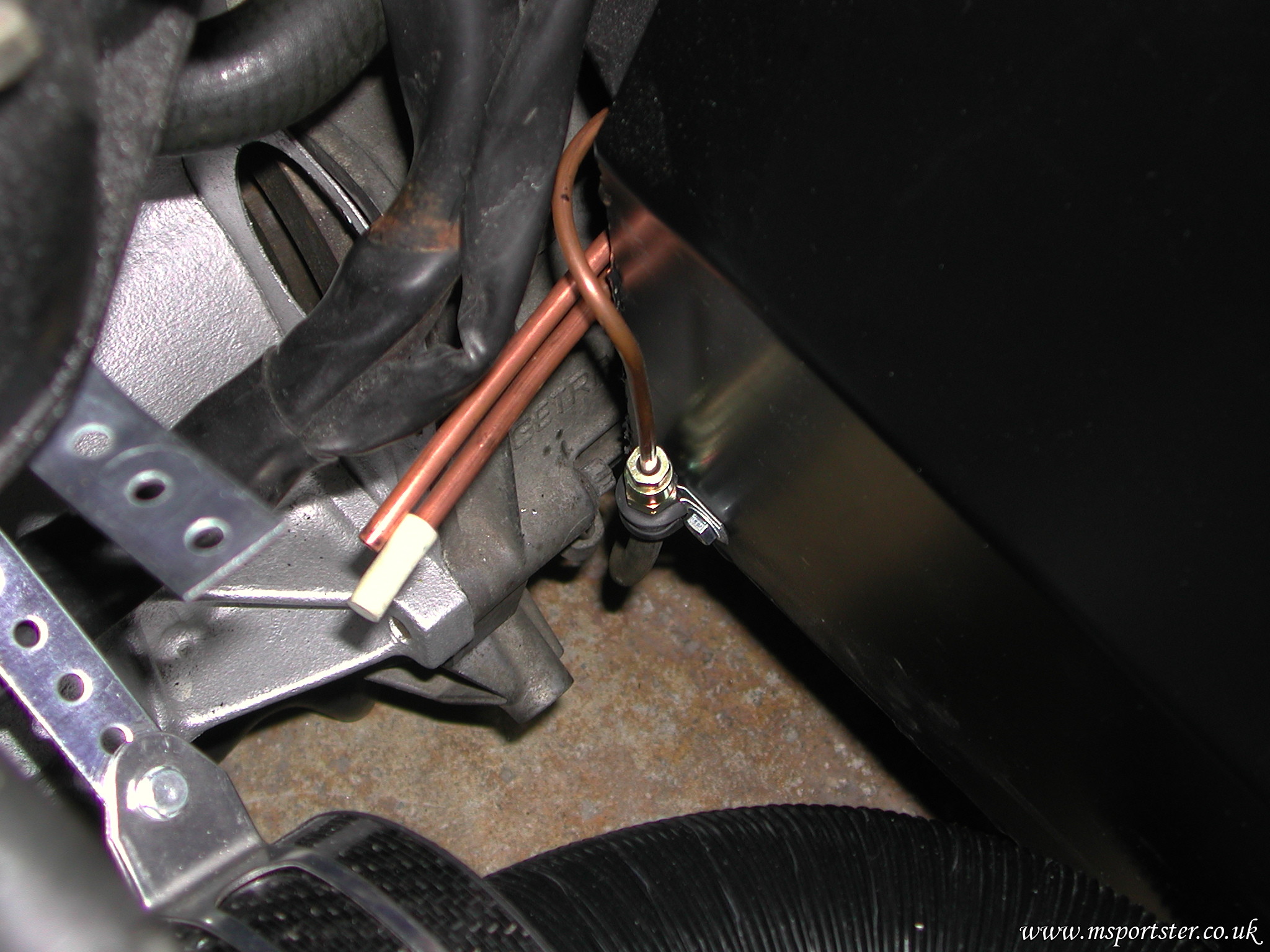

Im using the stock E30, it got damaged when we took the engine out the donor. I think the replacment was about £30 from motormec.
You can see where I attached it to the firewall with a P clips in these pictures:

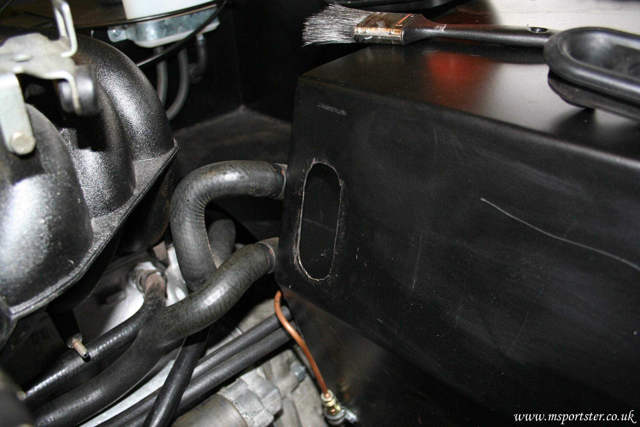

I followed Patrick's lead on this one and used the standard BMW part mounted in the same place as Patrick's car. (I kept my original but it was blocked full of gunge)
The only place i could get one was from BMW and I think it cost about £37 +VAT.
you can see a picture of it on page 5 of my Flickr photo's. Look for the picture called 'Fuel Filter' and you'll see it there lurking in the background.
