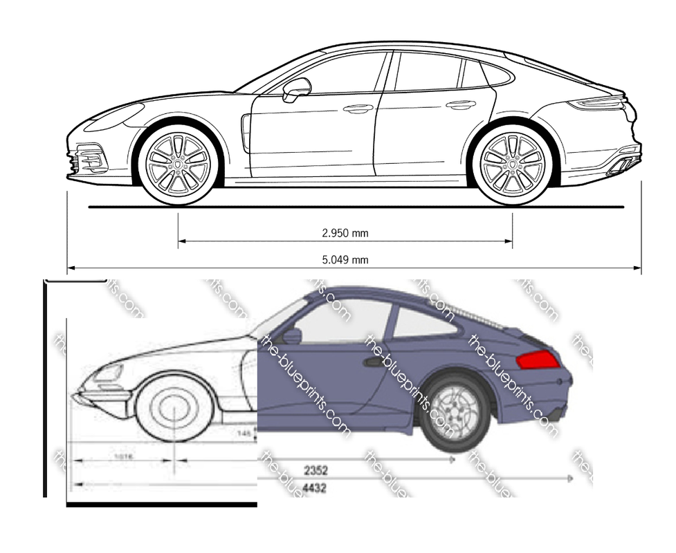

The Panamera is considerably larger and has the awkward bulging roof line to allow passengers. Those renders are just what I could find online so not the exact thing I have in mind but as the image below shows, I may not be the master of CAD and rendering models but I am not making a Panamera look-a-like

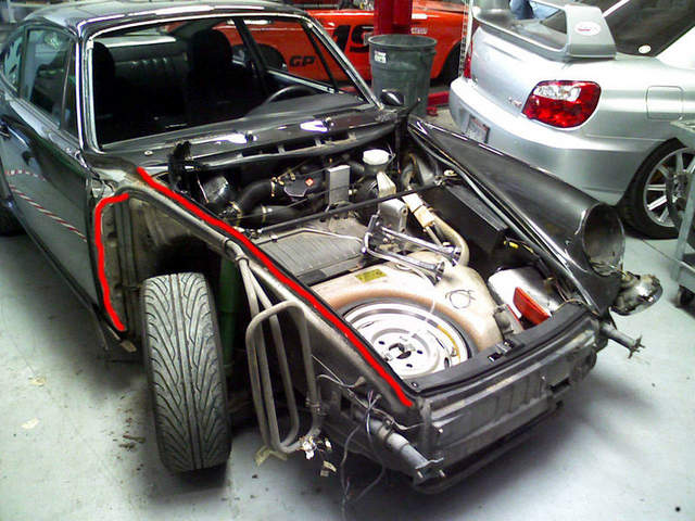

The door is the only panel that will be skinned over rather than remade. For this a single layer of fabric can be used to wrap over the edges so the gap will only shrink my less than 1mm. The front and rear wings can be formed with bigger gaps than I end up wanting so the end result should still be good gaps.
I am actually thinking of making moulds/profiles based on the existing panels but just for the first few inches so that the contours match exactly when they join the door. I will then use these to ensure that the former I build will be the same as the doors. This further complicates the issue with panel thickness but I am sure I will work it out.
