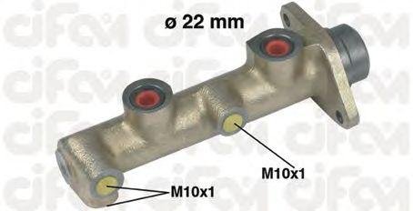

My Ford Sierra master brake cylinder is leaking ( fitted to dual brake booster) , struggling to find a replacement, everywhere is out of stock for Cifam ( 202-099) or Metelli ( 05-099) , its the 22mm bore , TRW have equivalent PMH173 but at cost of 260, of course has to fit adaptor plate, did anybody use a different type that fits the adaptor plate and the tight space available

6 Jun 2022, 9:56am
Problem is that these appear the wrong way round
This is the correct Cifam part No 202-099
and this appears

I will be interested to hear your feedback. It’s a job that’s on my preventative maintenance list too and I also found the OE 22mm bore master cylinders are out of stock everywhere. I suspect that for those alternative parts the brake pipes may need re routing as the side bosses could be facing the outside of the car. Not a major problem, just a bit of extra work. Also worth checking that the bolt holes in the mounting flange are the same pitch or you will need to modify something there. Finally worth checking that the depth of the rear piston hole ( relative to the flange face) is the same as your existing one, to ensure that the servo plunger has the correct clearance to work correctly. Peter.

I suspect the new Sierra master cylinders from kit parts (featured above) are likely to have m10 connectors for the pipes, and it's worth checking with kit spares to ascertain the bore size.

So I received the Ebay Borg & Beck master cylinder which I was unsure about due to the photo not looking like the Cifam model. However holding the two against each other it appears to all intents identical, although I have yet to check the piston arrangement. One small bonus is that based on its very light weight it must be made from aluminium rather than steel. Will let you know if it fits next week !!

I bought the same one - it is a direct replacement: albeit a generic body which allows the ports to be LHD or RHD - obviously these are for RHD.

Yes I have now bought the same, for the same reason. With the dual servo fitted the master cylinder is further forward so the front unused boss will foul the bonnet. If it is completely solid it could probably be machined off?

Hi Mike. Yes I had considered that but I don’t like the misalignment that causes, even if a ball joint clevis is used. If you put a wire down the opposite port it only goes half way across the cylinder so I am pretty sure the redundant outer boss is solid. If it could be Xrayed it would confirm that immediately! Peter.
