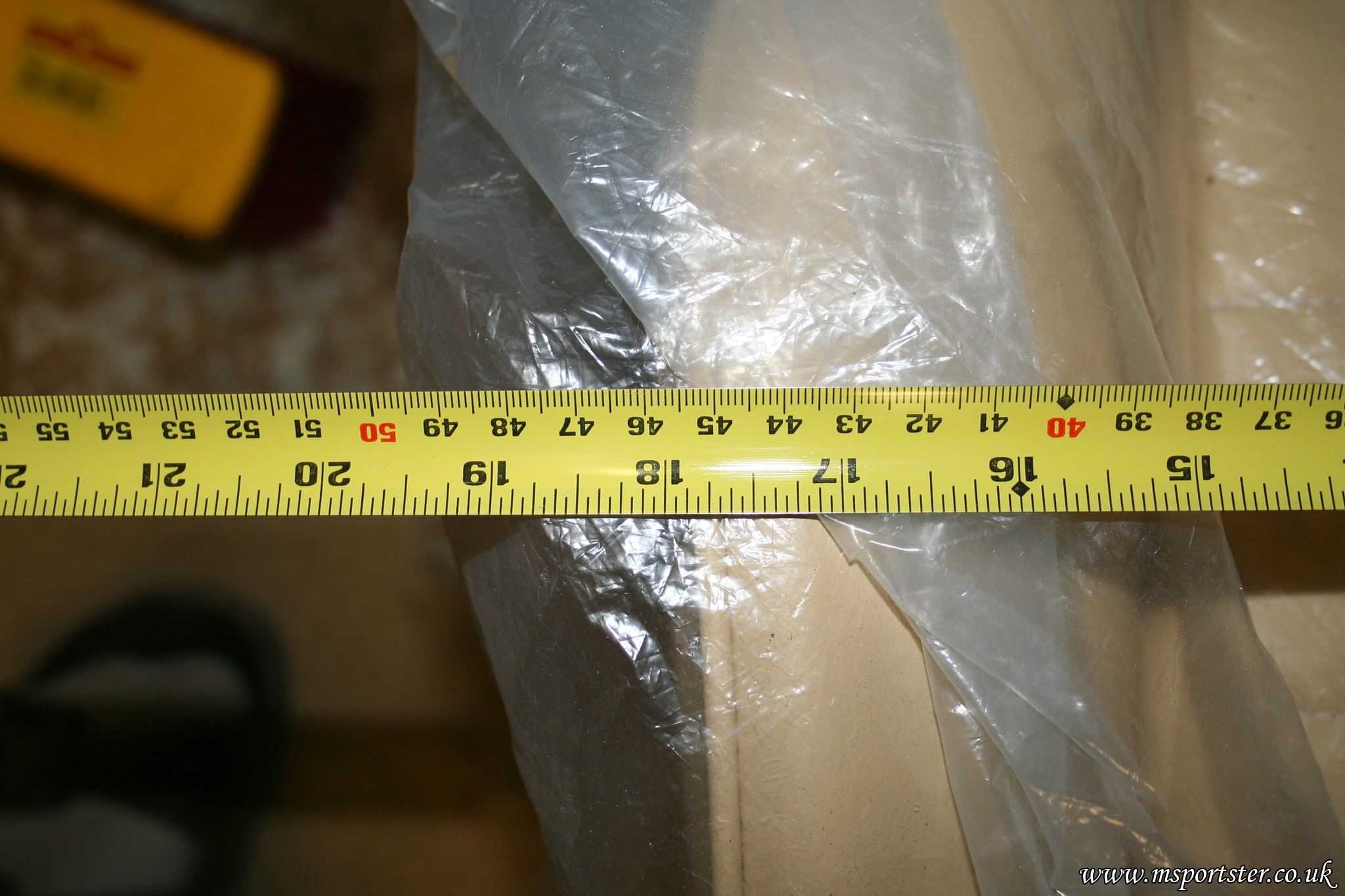

The seat is 445mm across at the wide point at the top:

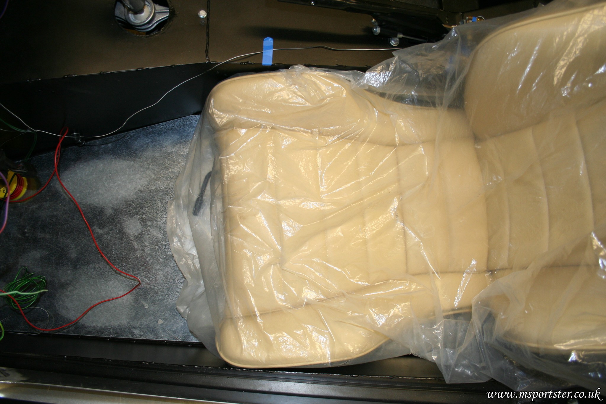

The is the seat as far back as it will go:

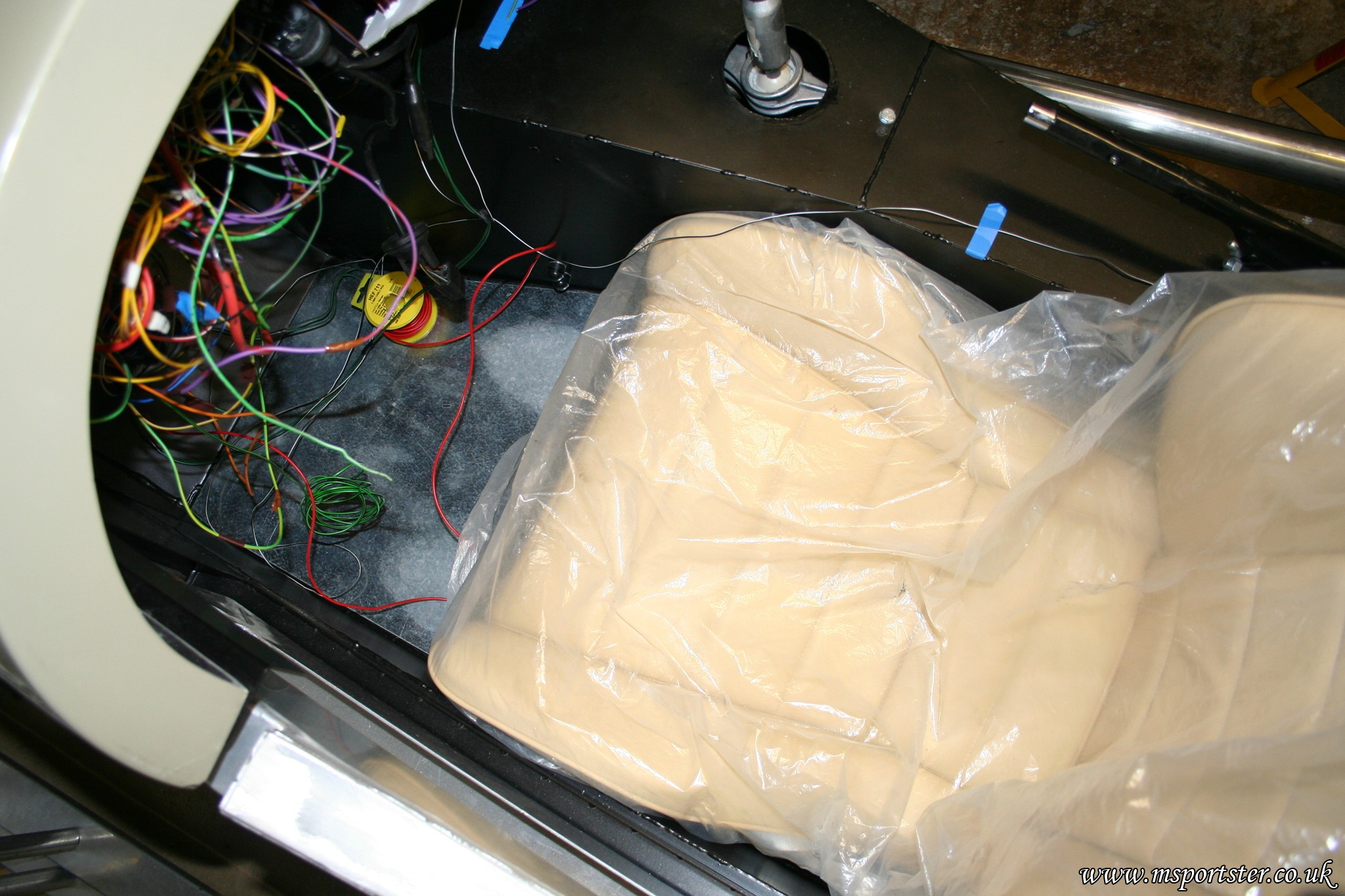

This is the seat as far forwards as it will go:

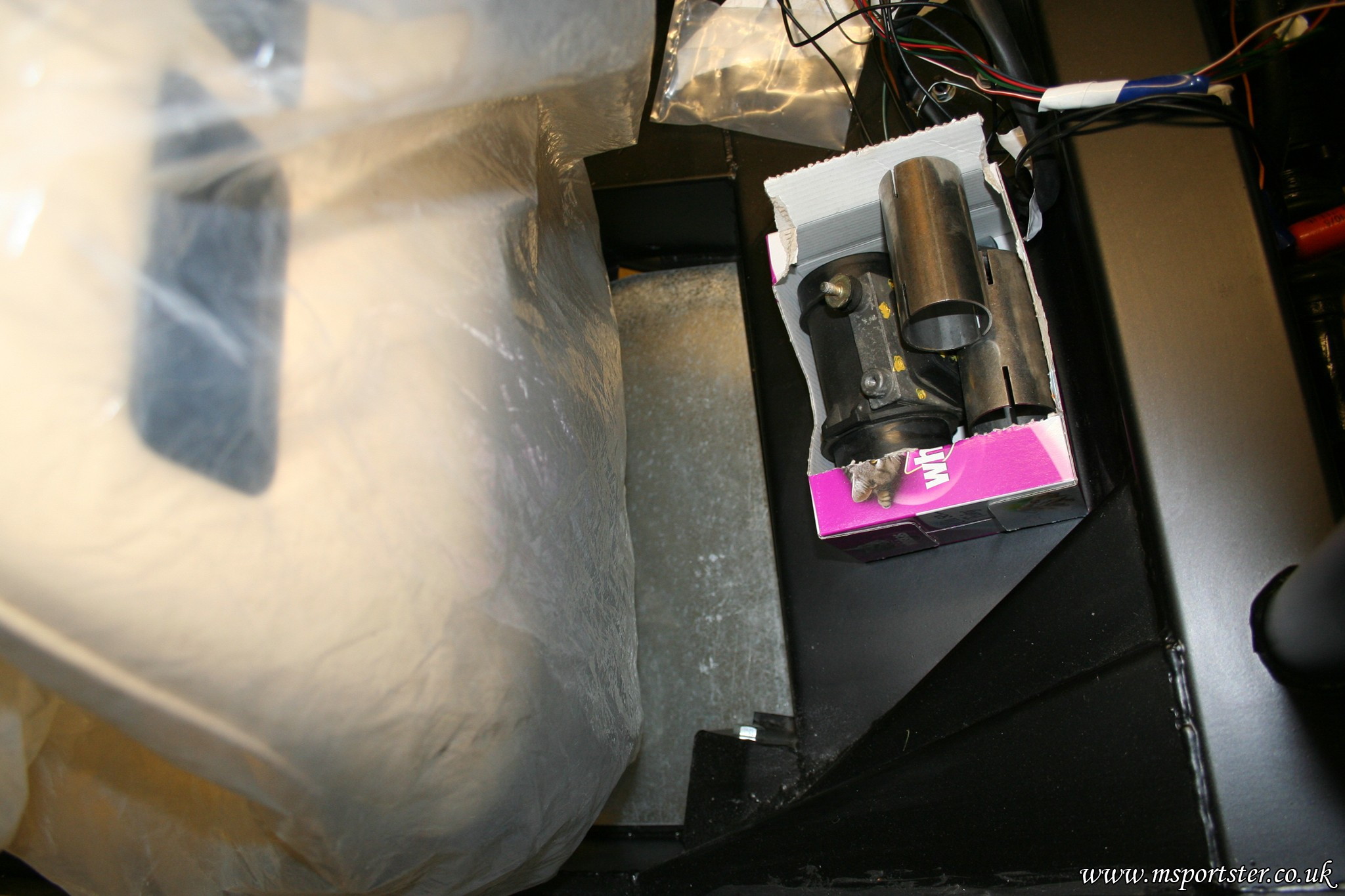

This is the space behind the chair with it as far forwards as it will go:
