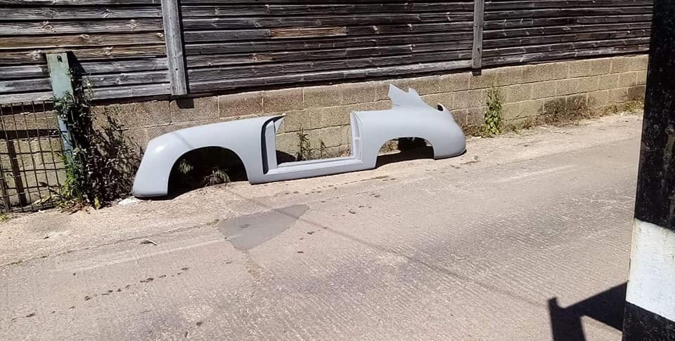

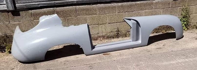

I do like a project I am on my 6th tribute build with one on order but always wanted to have ago at my own kit /rebody.got this today with the doors not sure of the plan one thing I do know is I am going to need a lot of fiberglass and possibly some wheels :laugh:

could not afford the middle so I just bought both sides I have got the doors that will keep the draft out lol

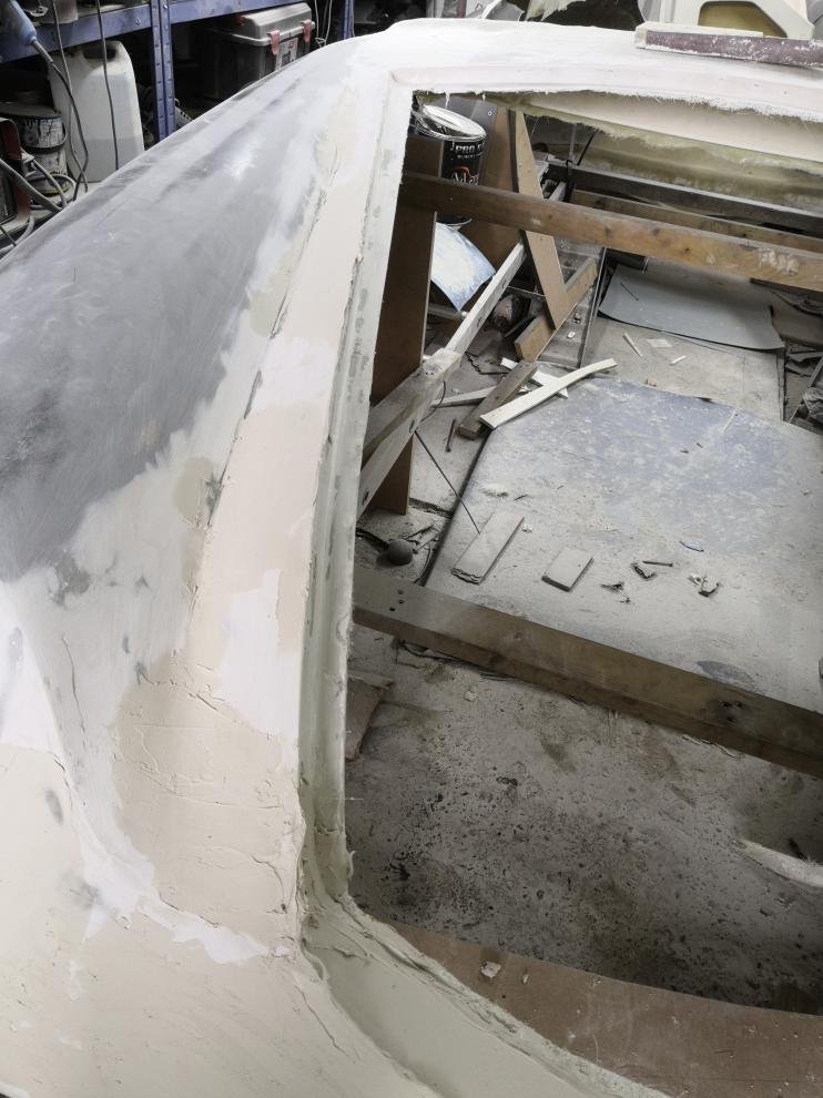

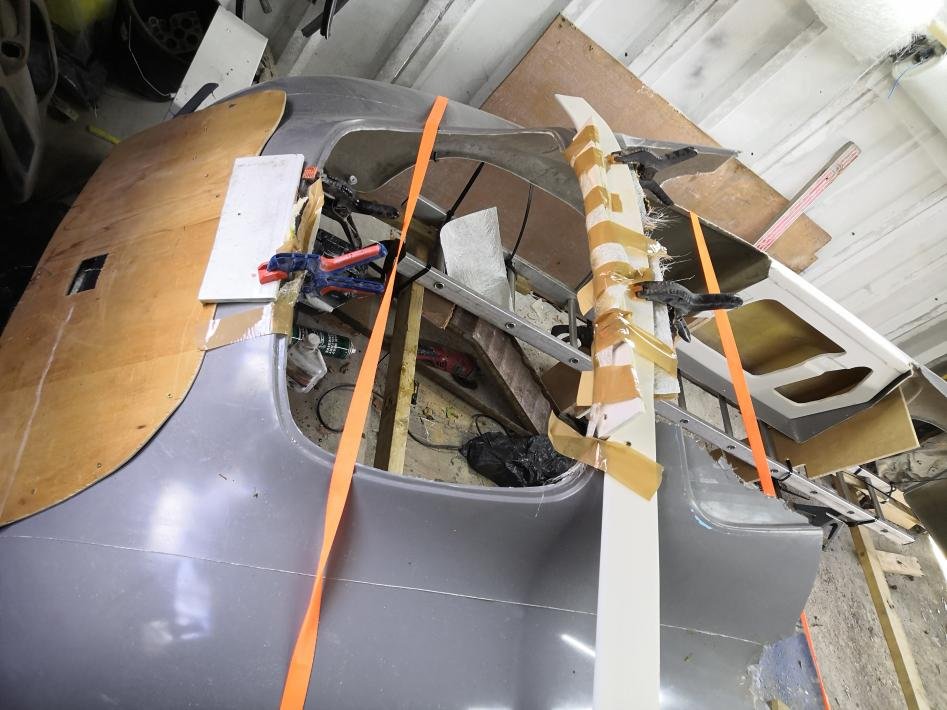

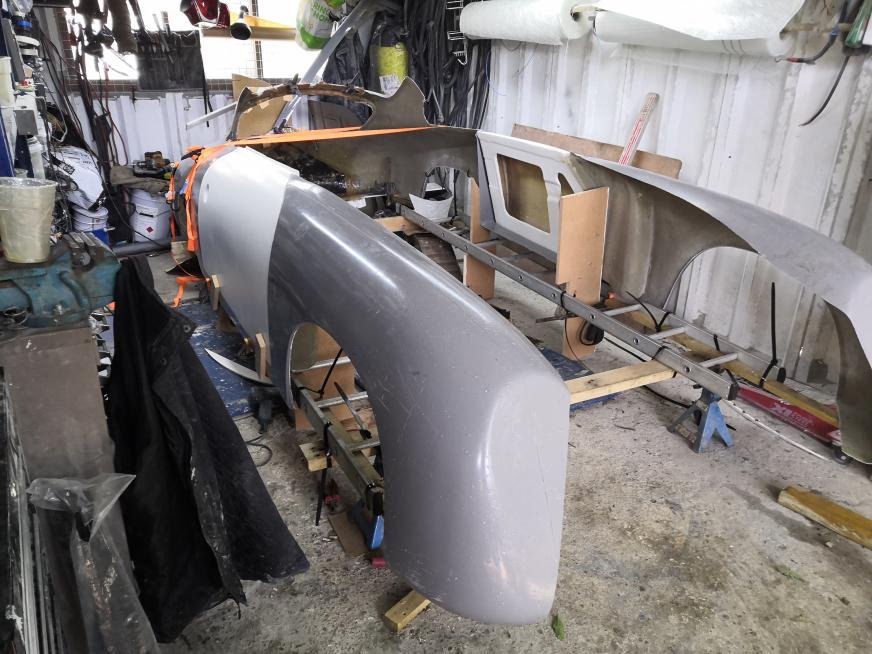

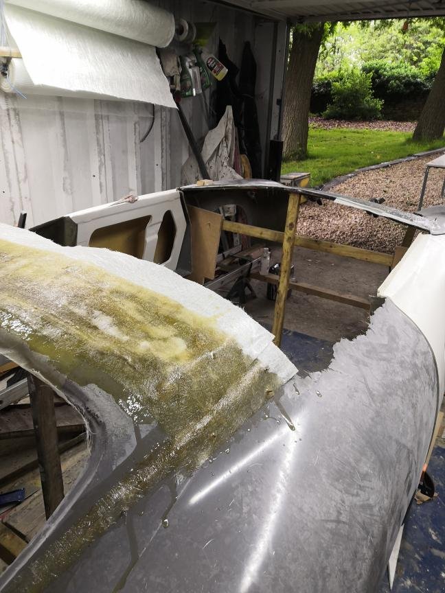

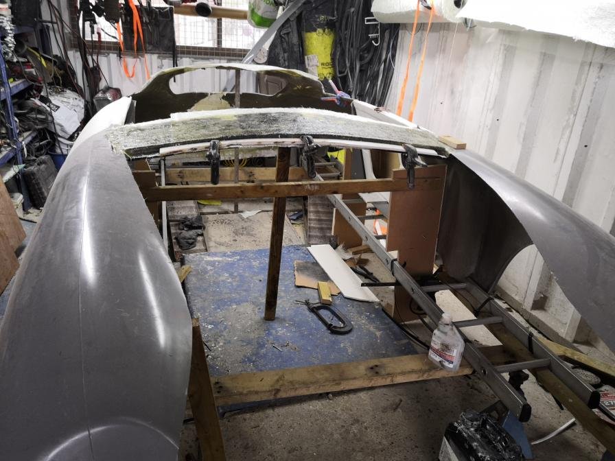

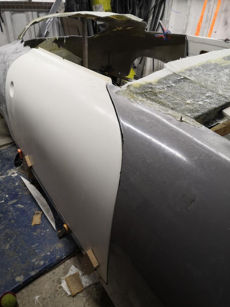

body arrived Thursday so I hit google for measurements to start having a play this weekend. because the car is just two halves it was like a jelly out the mold .it took forever to get it something like in line measure and move umpteen times door gaps are pretty spot on so I am hoping the rest is far away.
I set it up on ladders guessing I could use them as level ground and looking at pictures of a speedster its pretty straight all round the sills
next job try to rough in some structure to the body, I wanted to work inside out so as not to build on top of what I have got but under it. if that makes sense. it can be cut and modified latter when the body is stronger. I left the edges of the fiberglass mat clear of resin so when I am ready to add structure it should tie in better.
I latter cut a V each side of the engine lid opening to pull it down on the soft top its not as steep an angle this body would have been hard top.
at least its starting to firm up the body joining the two halves back together even if it is just roughed in for now. making the boot lid and opening or is it engine lid is going to be interesting one and is going to need some planning.

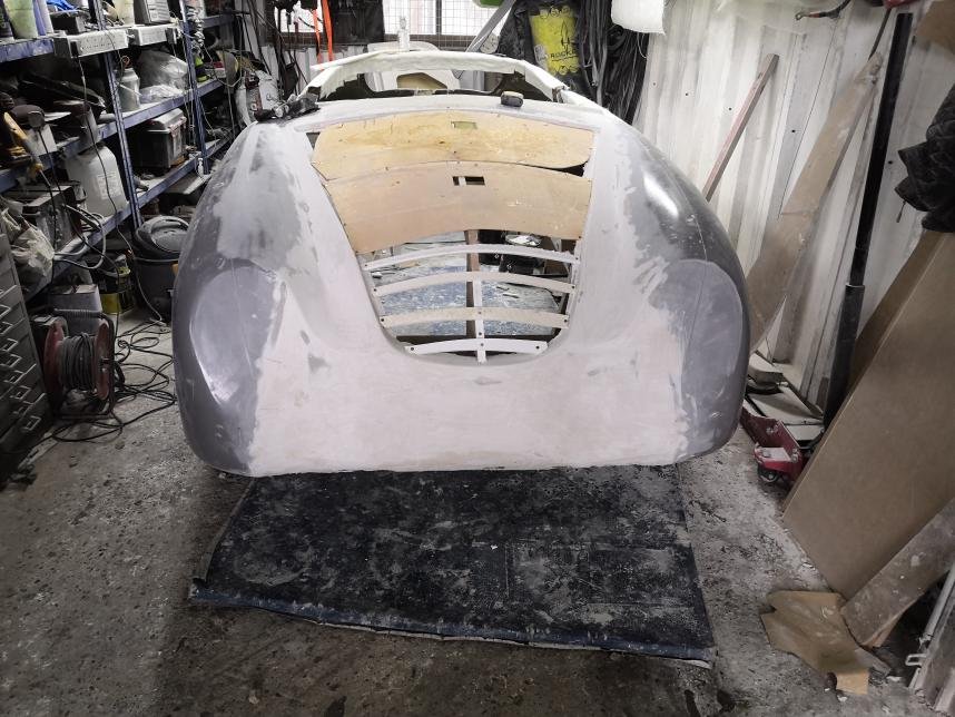

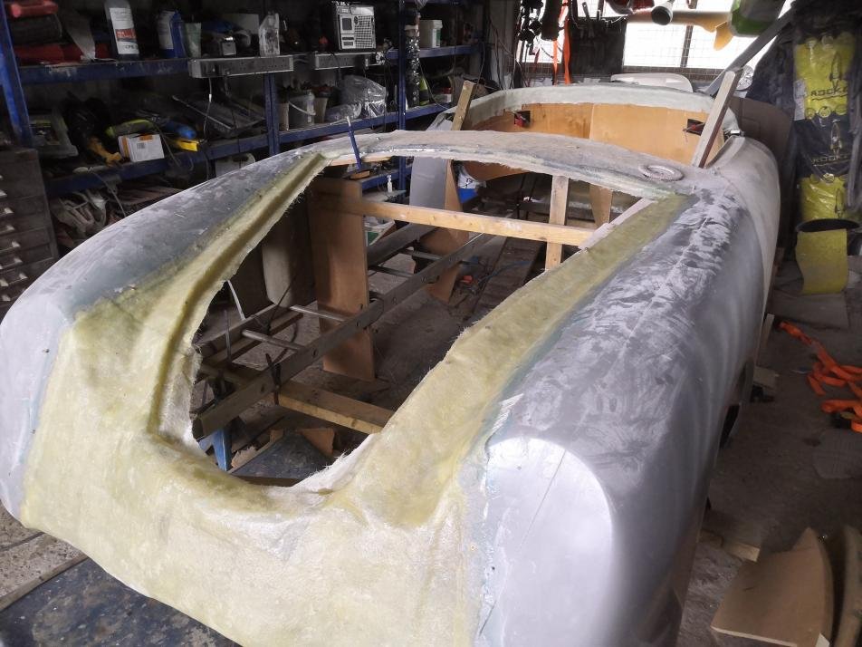

9 Jun 2020, 5:11pm
4 days work and starting to take shape now it almost looks like a car almost. waiting on resin and reinforcing glass to stiffen it up touch wood should be ok to flip it in a couple of days .I was surprised how thin the glass is I am use to tribute builds 6 to 7mm, this can not be more than a couple of mill in most places. when its upside down I will go go over most of it to build it up . best getting looking for a chassis one I had lined up I lost .

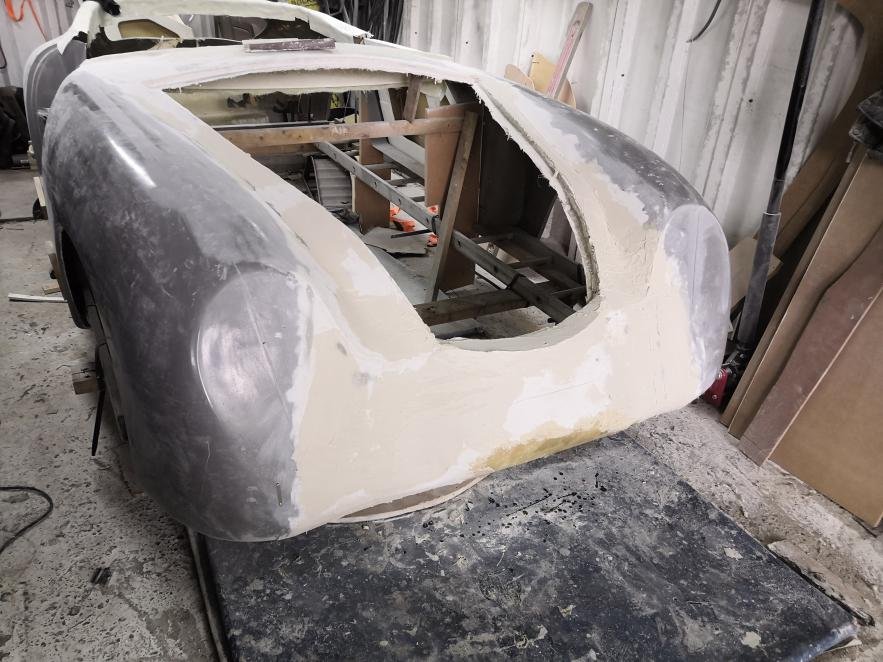

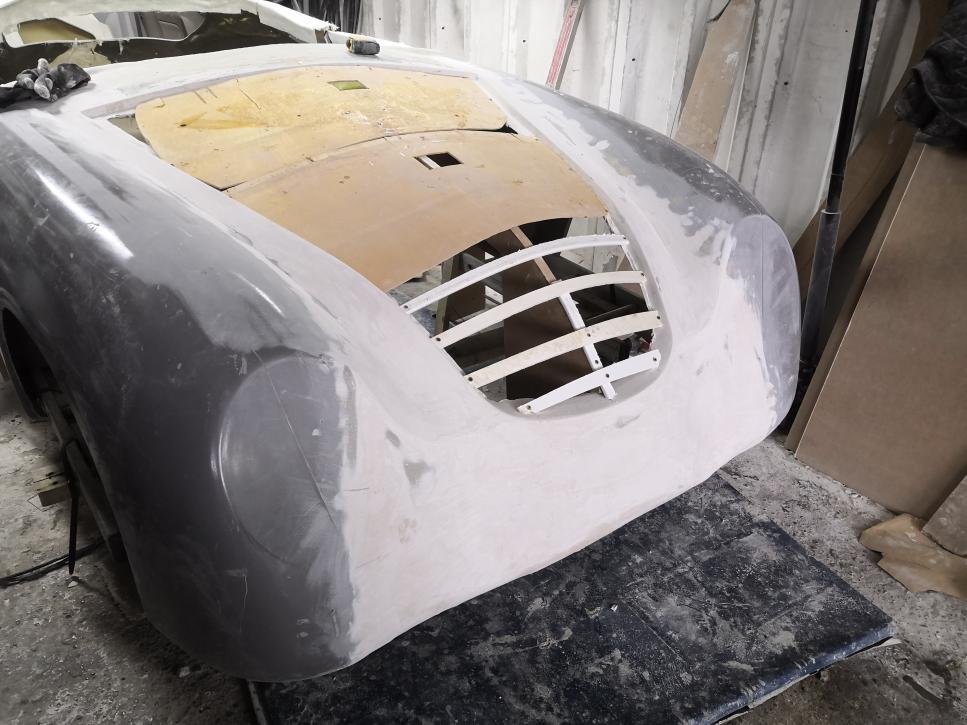

whoop whoop I am at the smile point when you step back to check what your doing. all been well l will have the bonnet made tomorrow bare bones ready

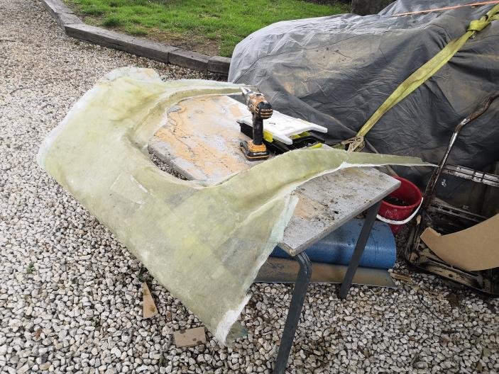

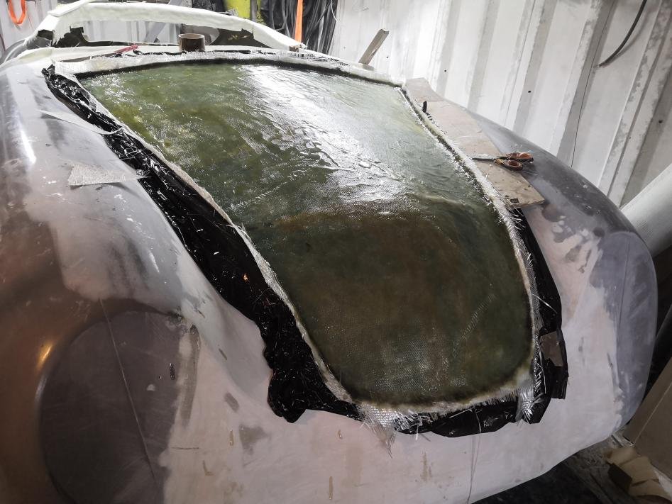

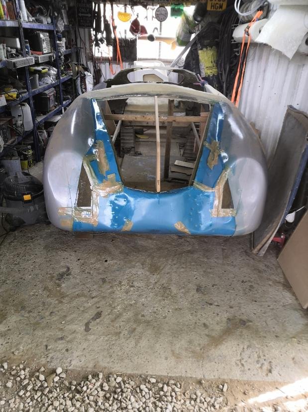

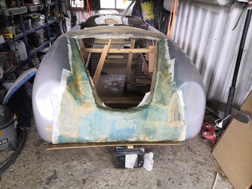

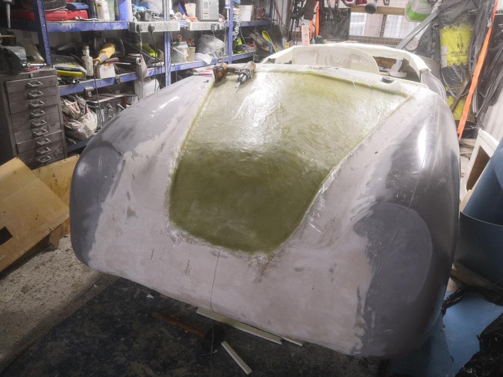

bonnet inner skin sorted, I have some 6mm high density foam that I am going to lay on the top and skin and glass over it to crate a sandwiched. I will have a look tomorrow its was already pretty stiff two lairs of 300g Woven Roving 2 of 450 csm and two of 300csm

[SIZE="3"]Holy Fibreglassing Batman![/SIZE]
andysharrock – Great work, you really are making something from nothing. :cool:
A few questions about how you made the nose…
What is the blue material and how did you shape it?
Hard to tell from the photo, but is the blue set a few mm lower that the side pieces?
(Allowing you to join the new piece to the sides from underneath.)
Or was the blue material there to form a mould to make the nose from?
Just seeing the rolls of fibreglass matting on your garage wall is making me itch. :icon_wink:
