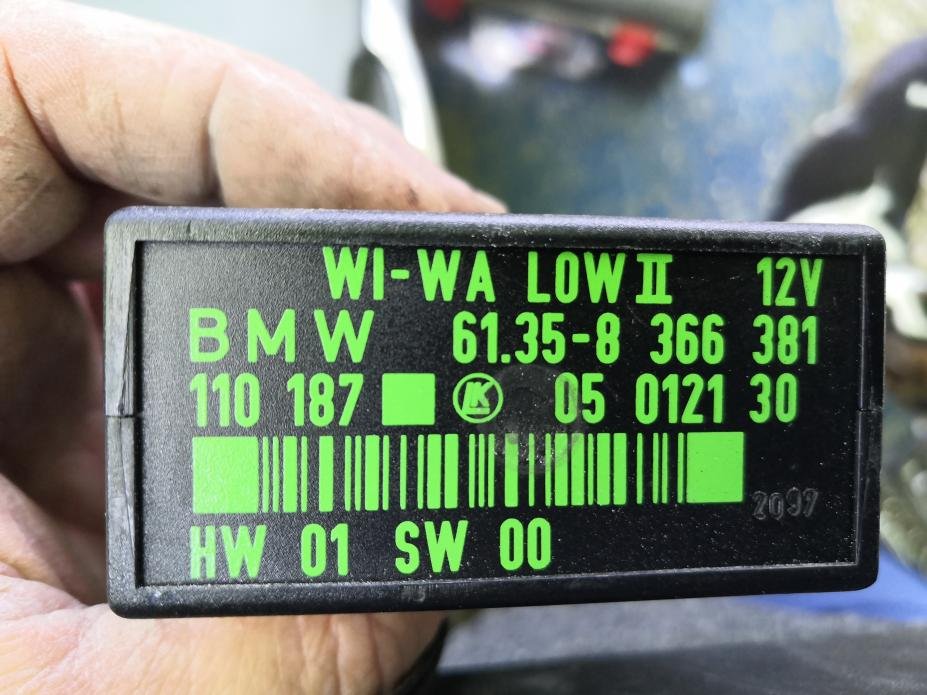

yep seems a common fault if you google it although it's a first for me ,just need to find it my car is a 1998 .some threads say above glove box it could also be the relay .will look into tomorrow

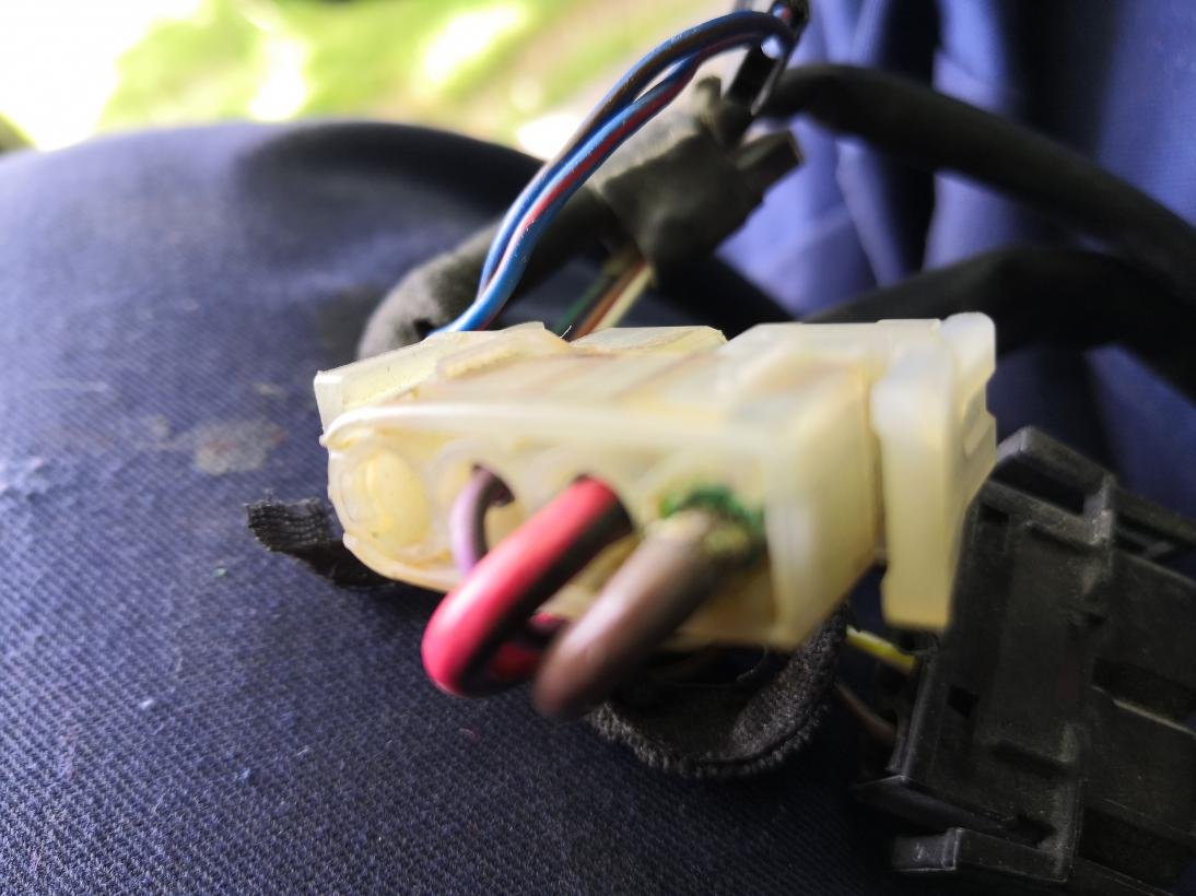

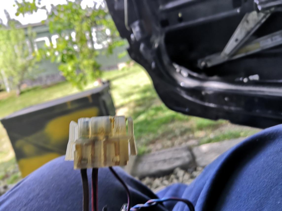

sorted it was the relay dose help having another z3 parked on the drive. I checked some of the earths that could cause it and found that the power supply to the seat was shorting wet carpets again. So I have pulled all the fuses that are now not needed roof seats etc . going to use the live feed to the seat to feed my DRL vier a switch so I can turn them off. next job
