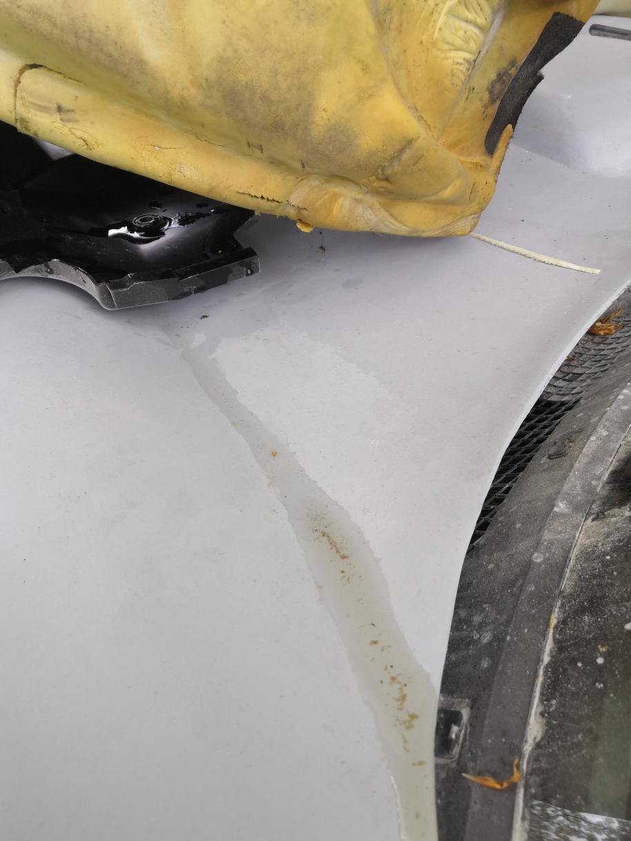

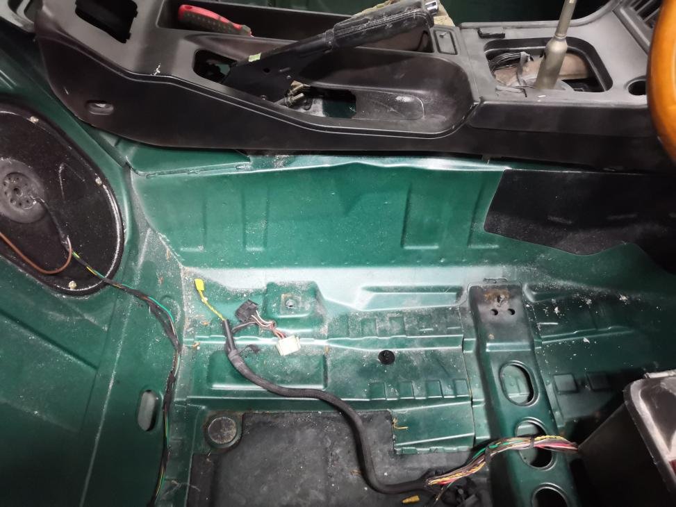

well that was hard work all carpets out and dripping happily in the boiler house. I have got some black dye on order so as soon as they are dry I can wet them again.
unbelievable the amount of water running out of them atleast it left the car nice and clean
