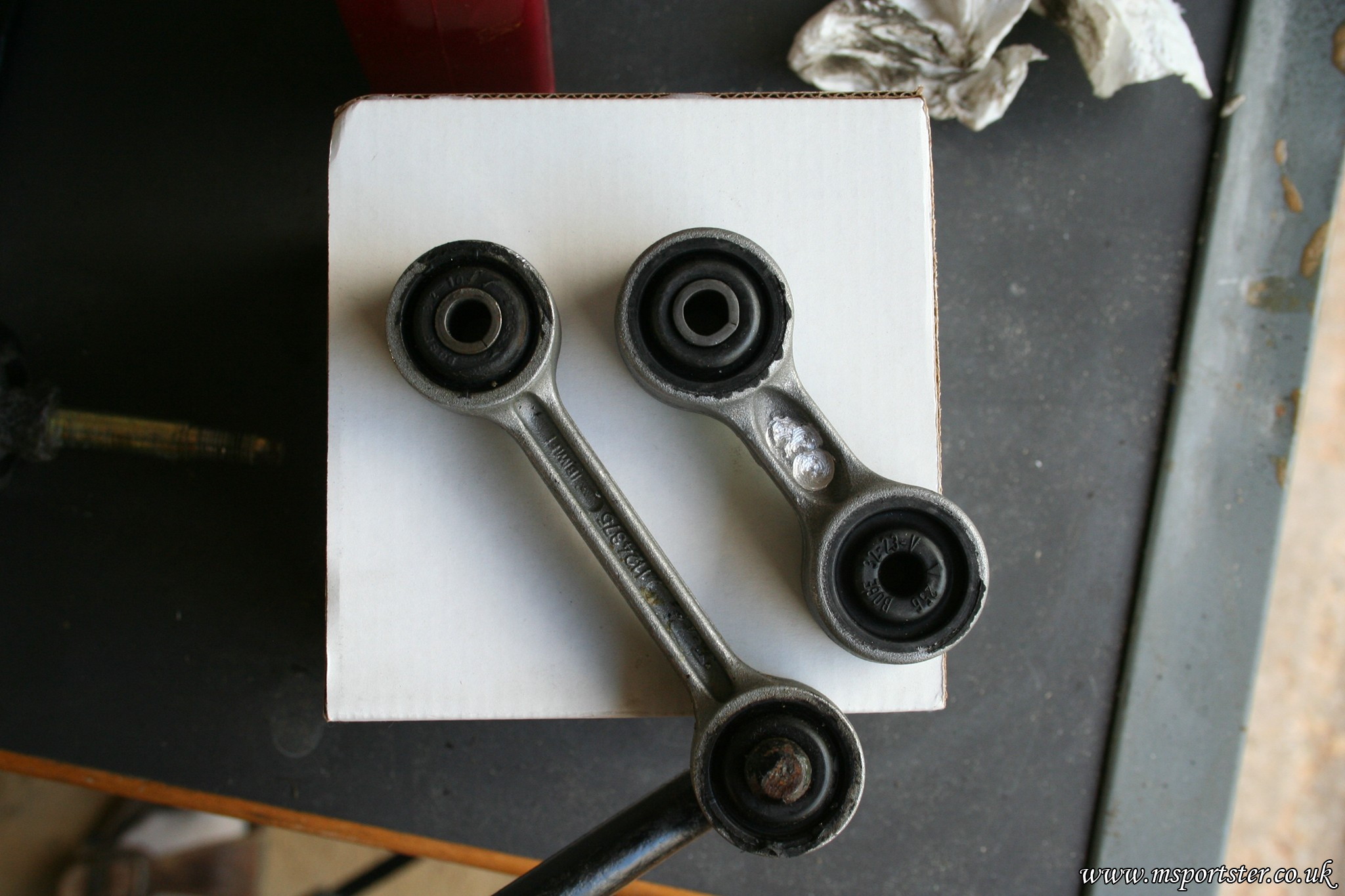

I installed a rear arb on my brothers compact last weekend, it is indeed a decent amount shorter than the E30 ones. I've got a set on order from Motormec - Im hoping these will allow the links to clear the chassis as the suspension compresses - before the links hit the chassis before the trailing arms hit the bump stops :)
As for the front I've only got the BMW brackets - these slot in one end and bolt up on the other. I've not worked out how to do that one yet. I've check both E46 & E36 front brackets that bolt both sides but these are to wide by about 5mm. I've not had them on with the wheels in so I can comment on that yet. I have bought some front ARB links off Stuart that orginally came from Marlin but I've not had time to try those yet. I think that I could probably use the standard BMW ones, but they wont look as nice. The other issue I think is that there would be too many sharp edges for SVA - so Im going to leave the front bar off for that.

EDIT: Here's a piccy:
