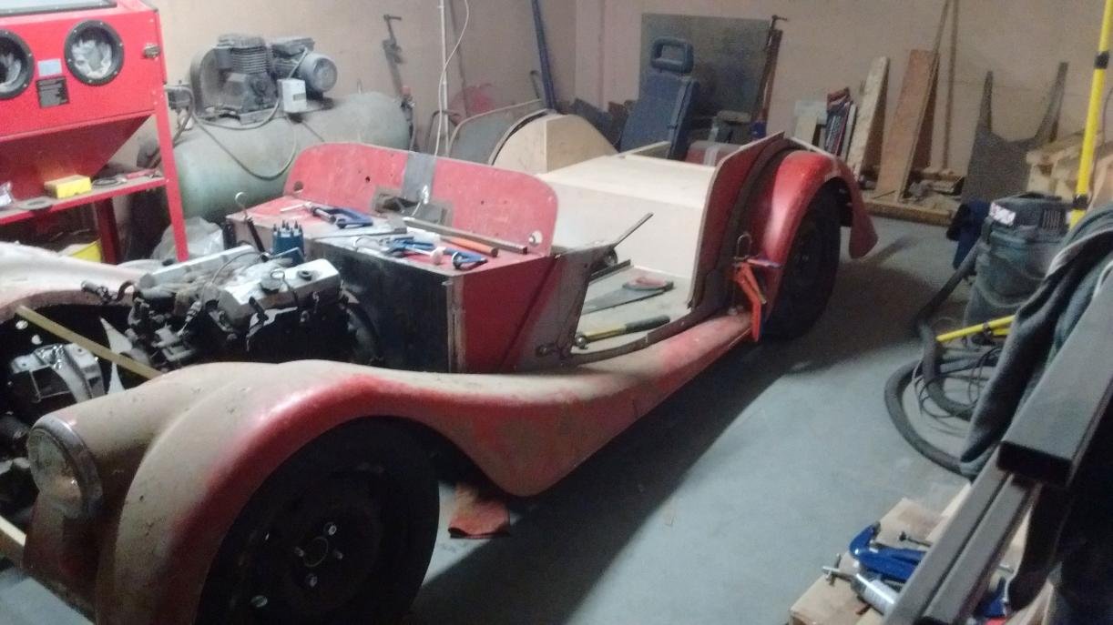

I have started my build after a trip to ebay found what was described as a Morgan/ Moss shell last year. have also got a Triumph Herald chasse with running gear and log book from ebay. Keith

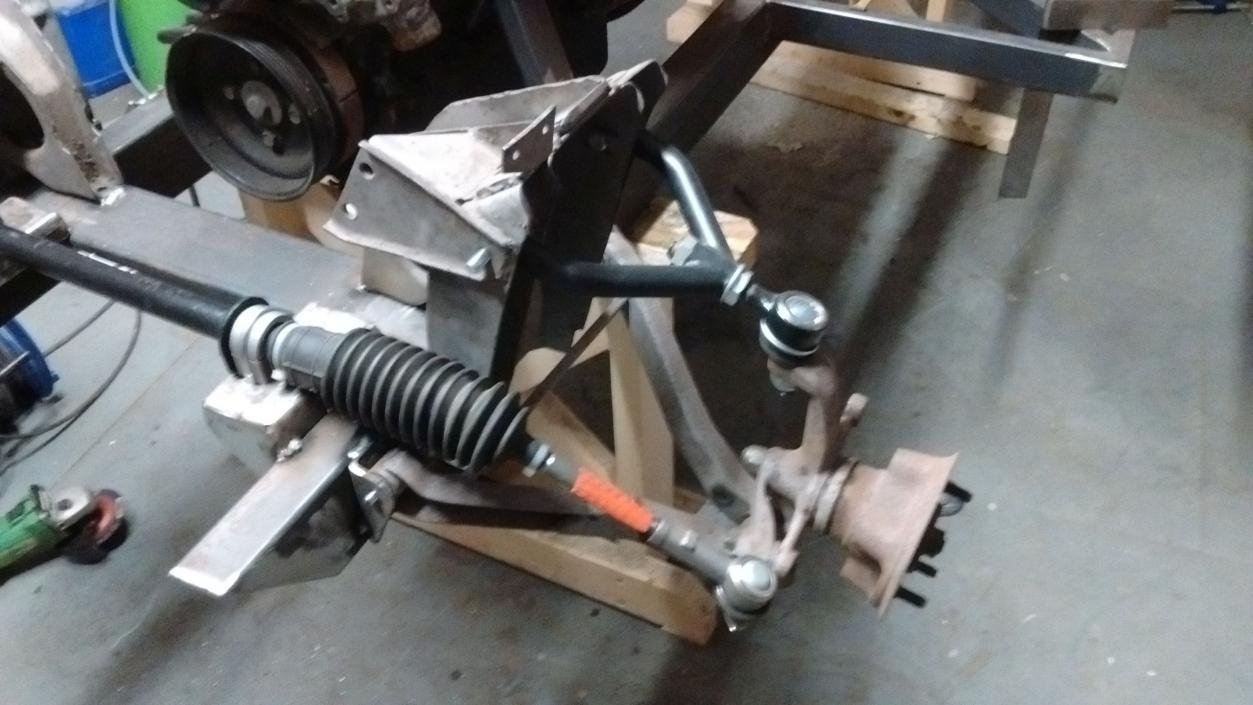

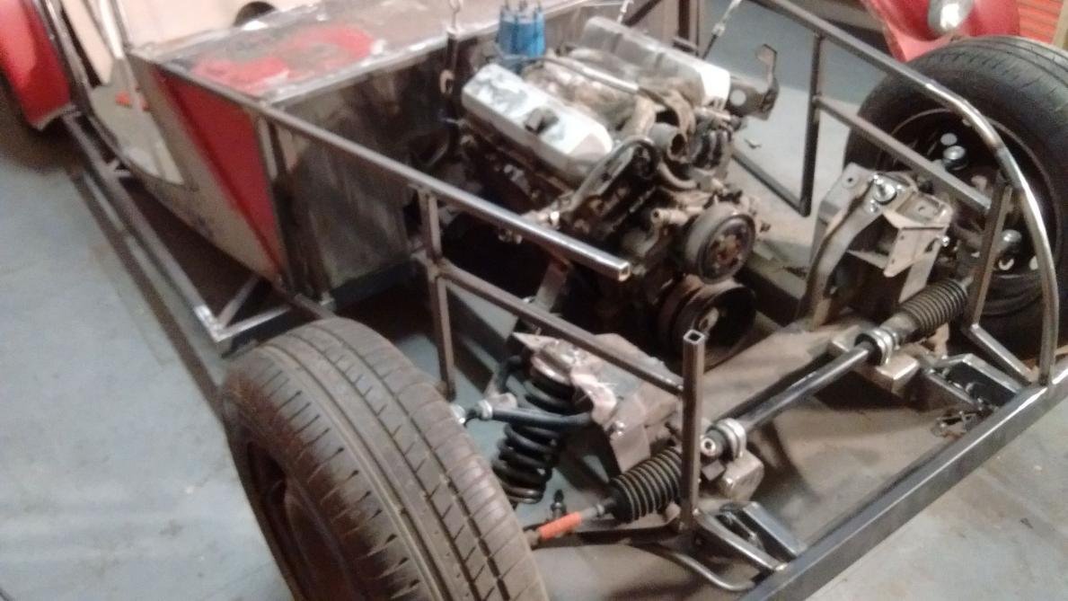

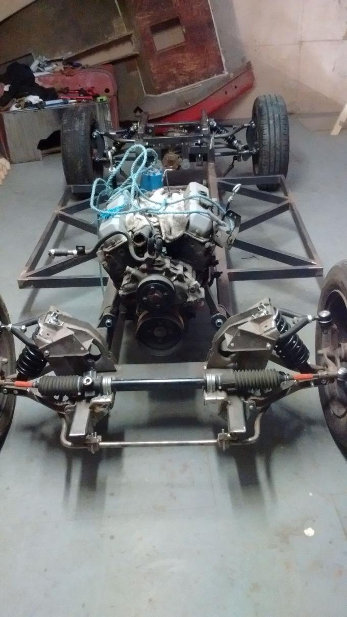

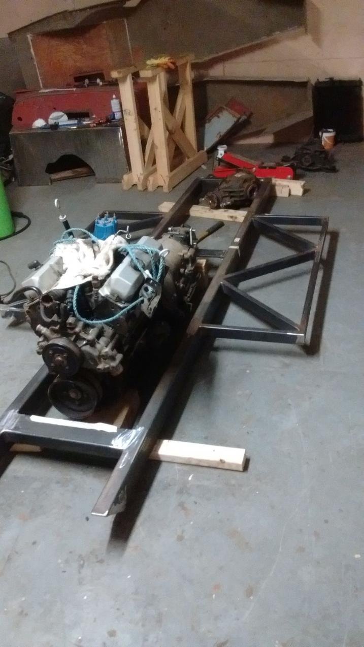

Been planning build so looked at different engines and have got a 2.8l v6 Chevrolet Camaro engine and auto box. This requires altering the chasse to much so have decided to make a new chasse and go through IVA. But use Triumph suspension.
28 May 2018, 5:09am

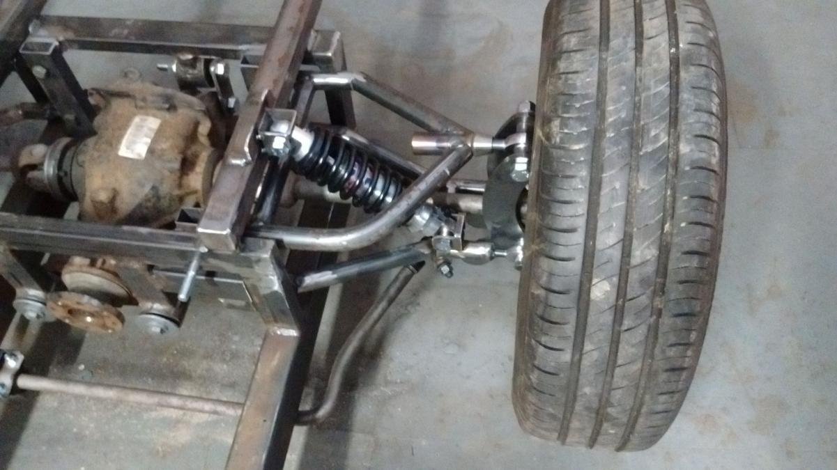

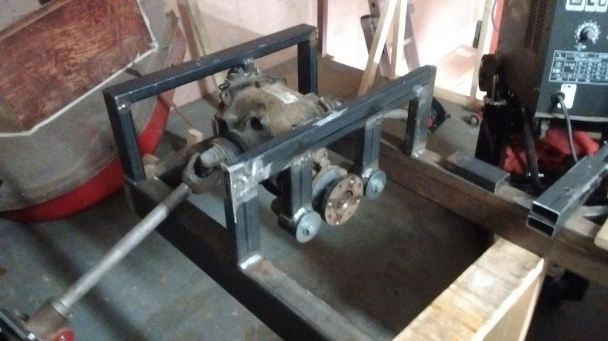

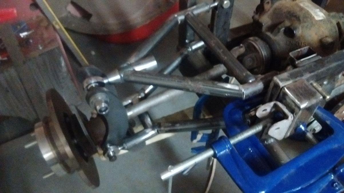

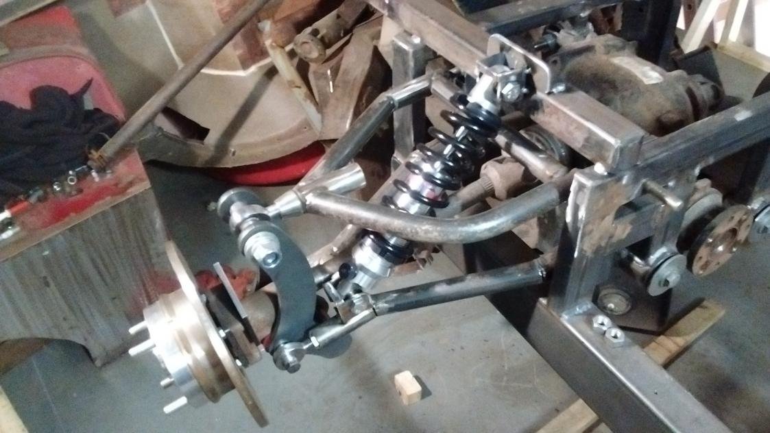

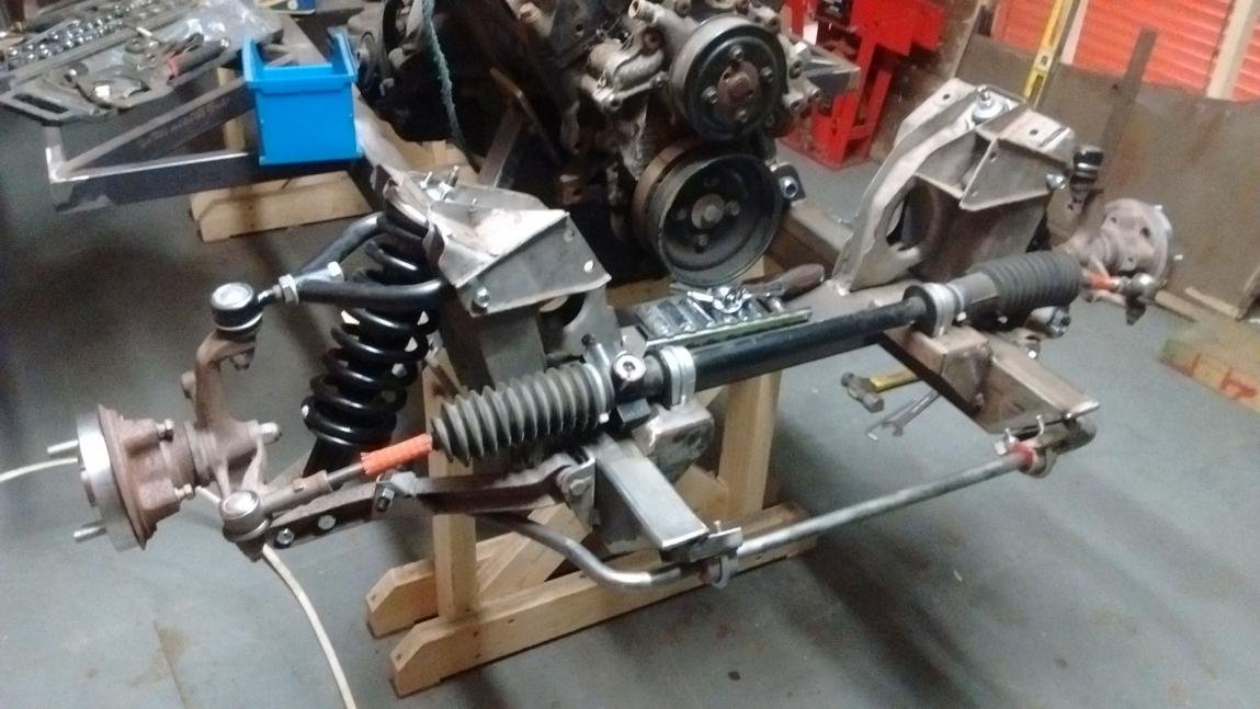

Next turned to rear suspension needed better diff BMW e46 would do so had adaptors cut to fit Triumph drive shafts but leaf spring would not fit over so converted to wish bone suspension part Triumph and rest made. Had to alter top wishbone to get coil over through but rolling chasse now.

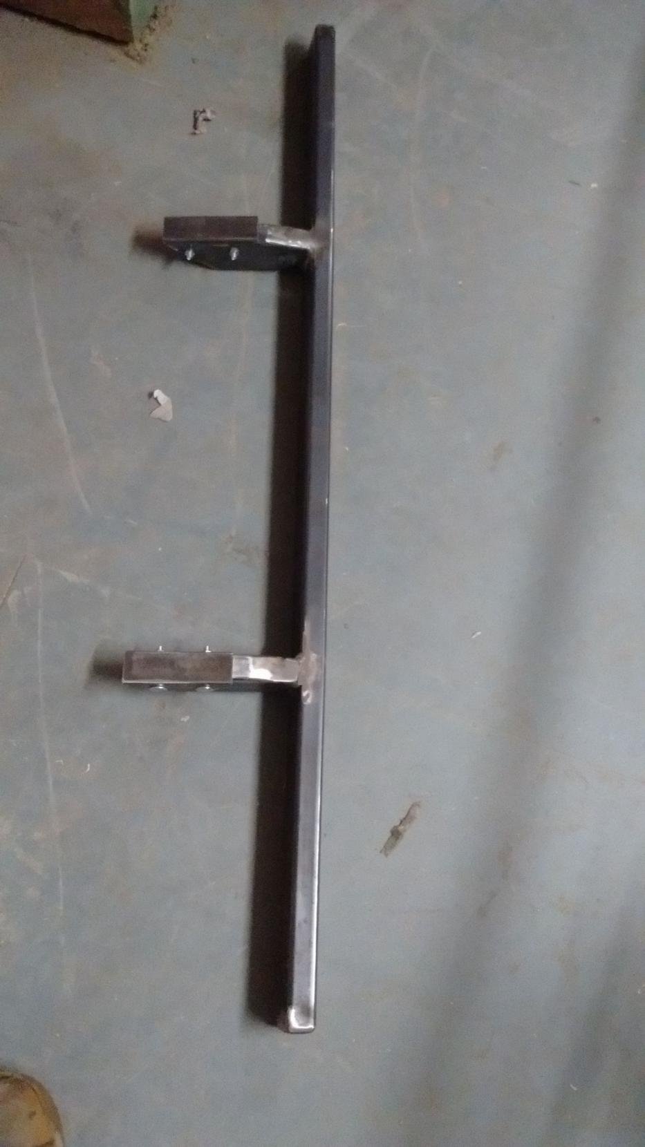

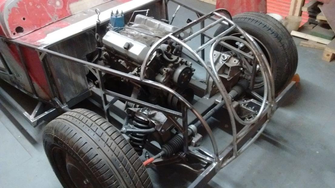

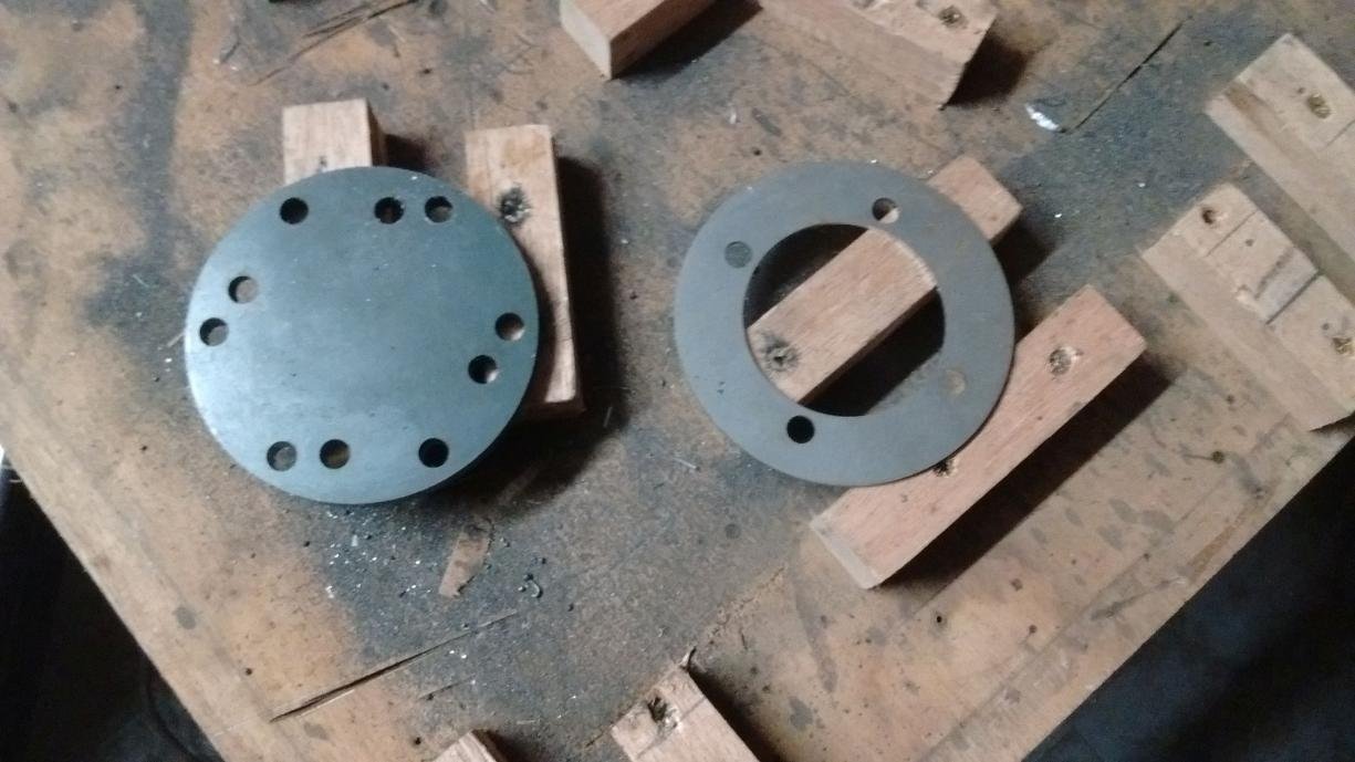

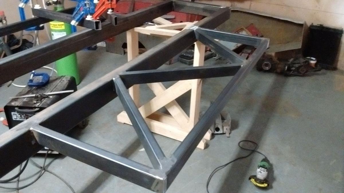

I plan to fit discs brakes all round up rated Canley classics up front and mgtf rear discs with golf calipers and make up carriers and have fitted 1500 spitfire anti-role bar to the rear and standard herald to the front. Also fitting pcd adaptors to give better wheel selection, with the 35mm I made the chasse wider and the adaptors the wheel base is 70mm wider.

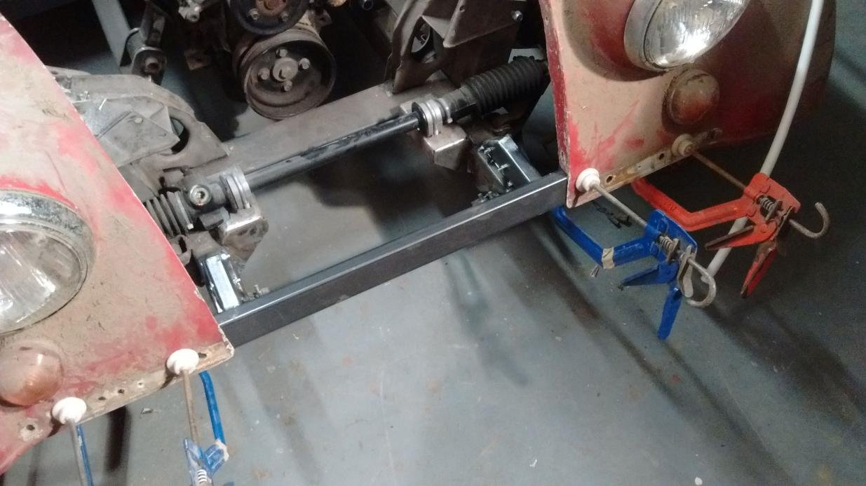

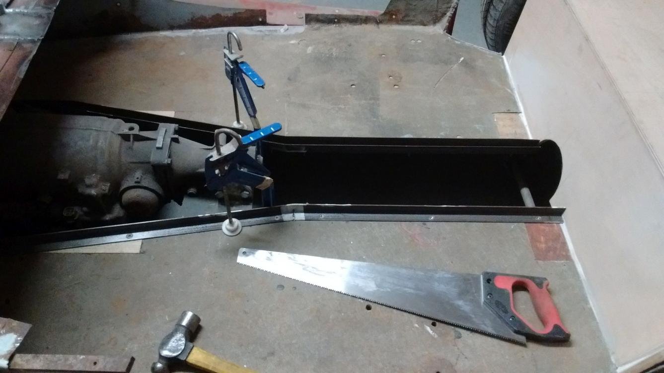

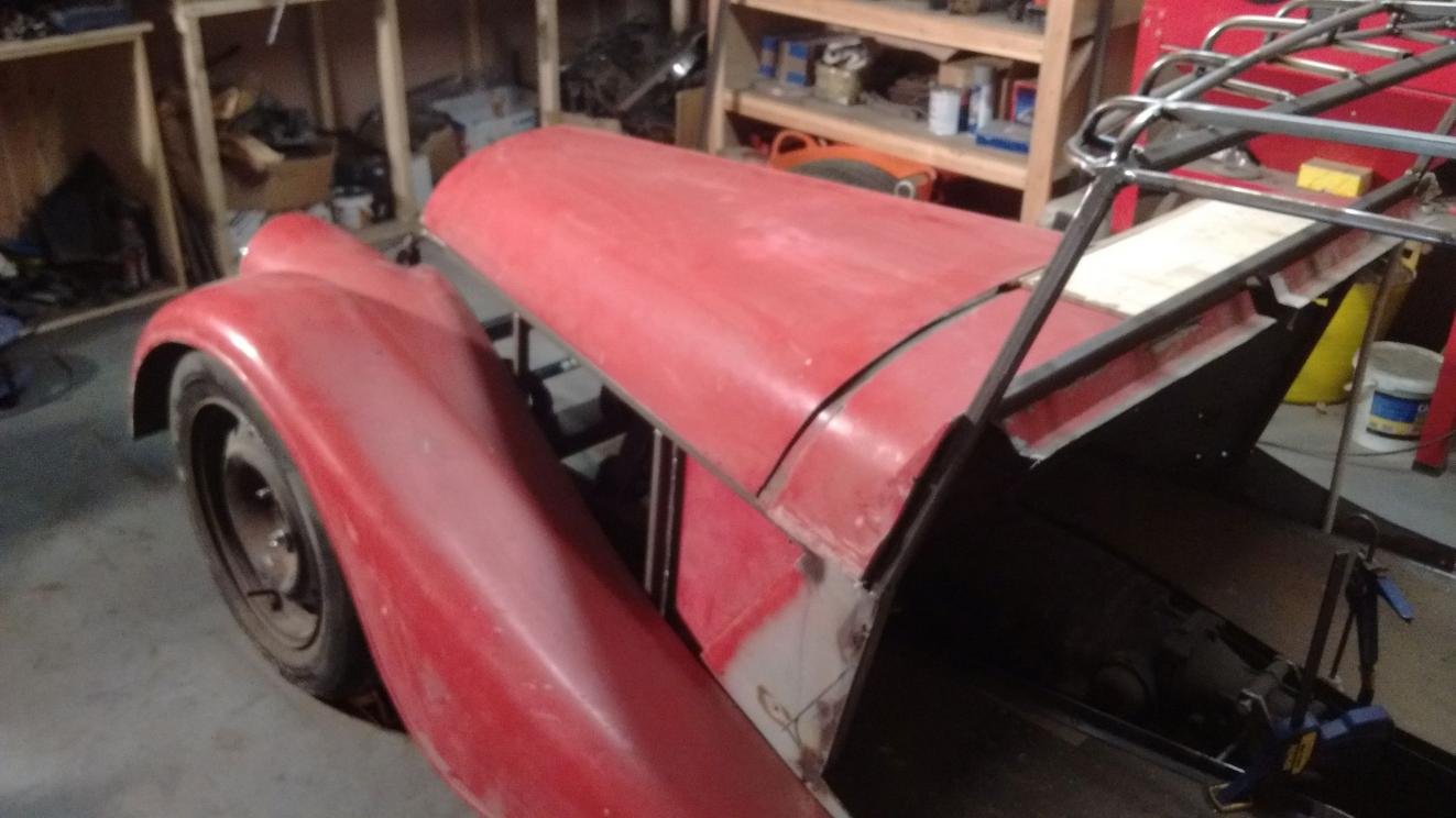

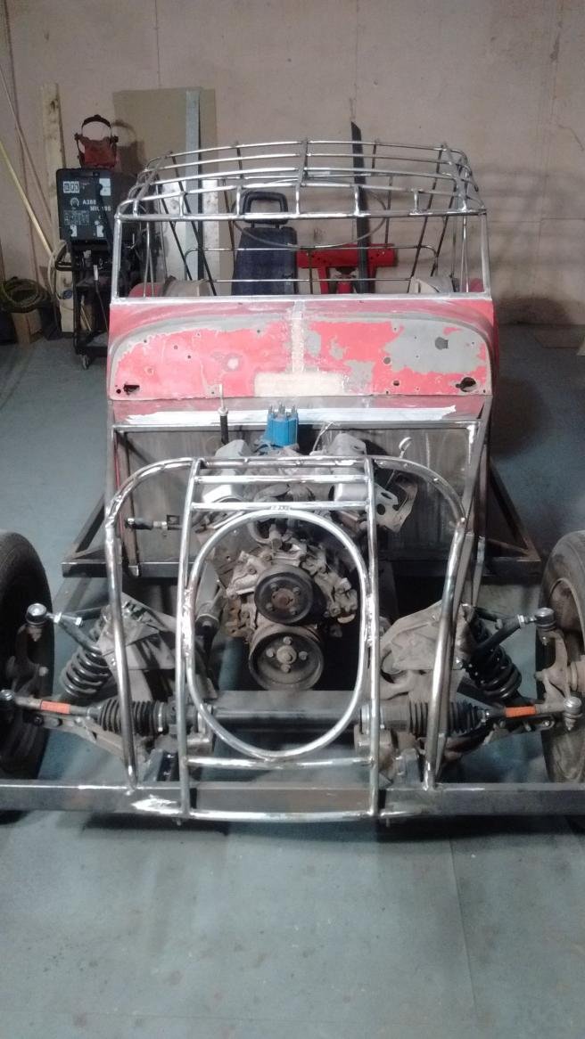

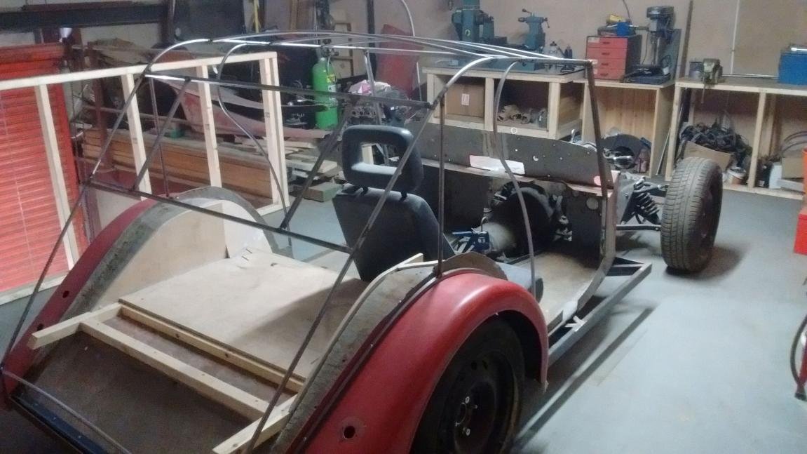

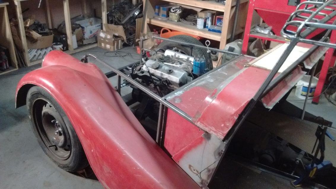

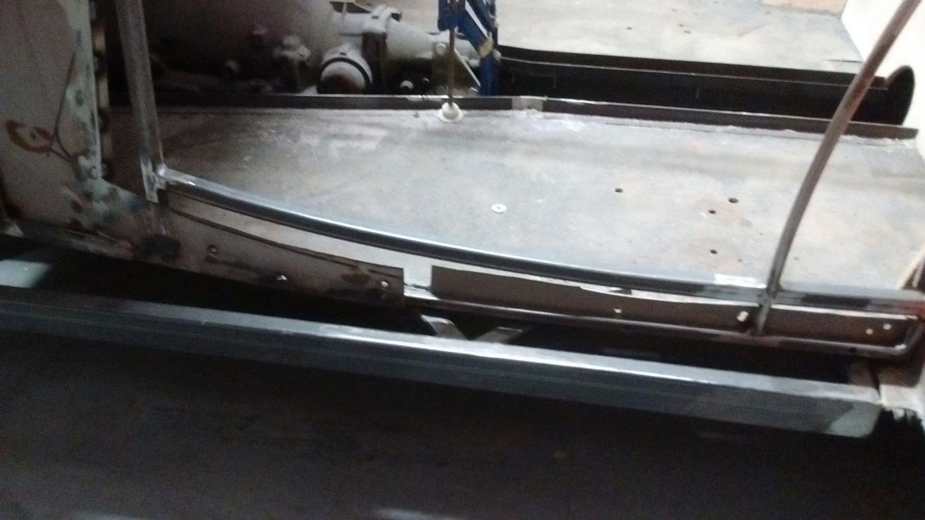

Just found time to add more pic of work I have done over the last 6 months so almost up to date, started the body work had to cut bulkhead d in half and widen by 70mm to bring wheel arches out! alter one thing alter all. Also fitted angle around the floor to give me something to fix the engine tunnel to and a prop catcher. Also made up a frame to carry front of fenders, most parts are just tacked in place and will be fully welded when all fitted and works.

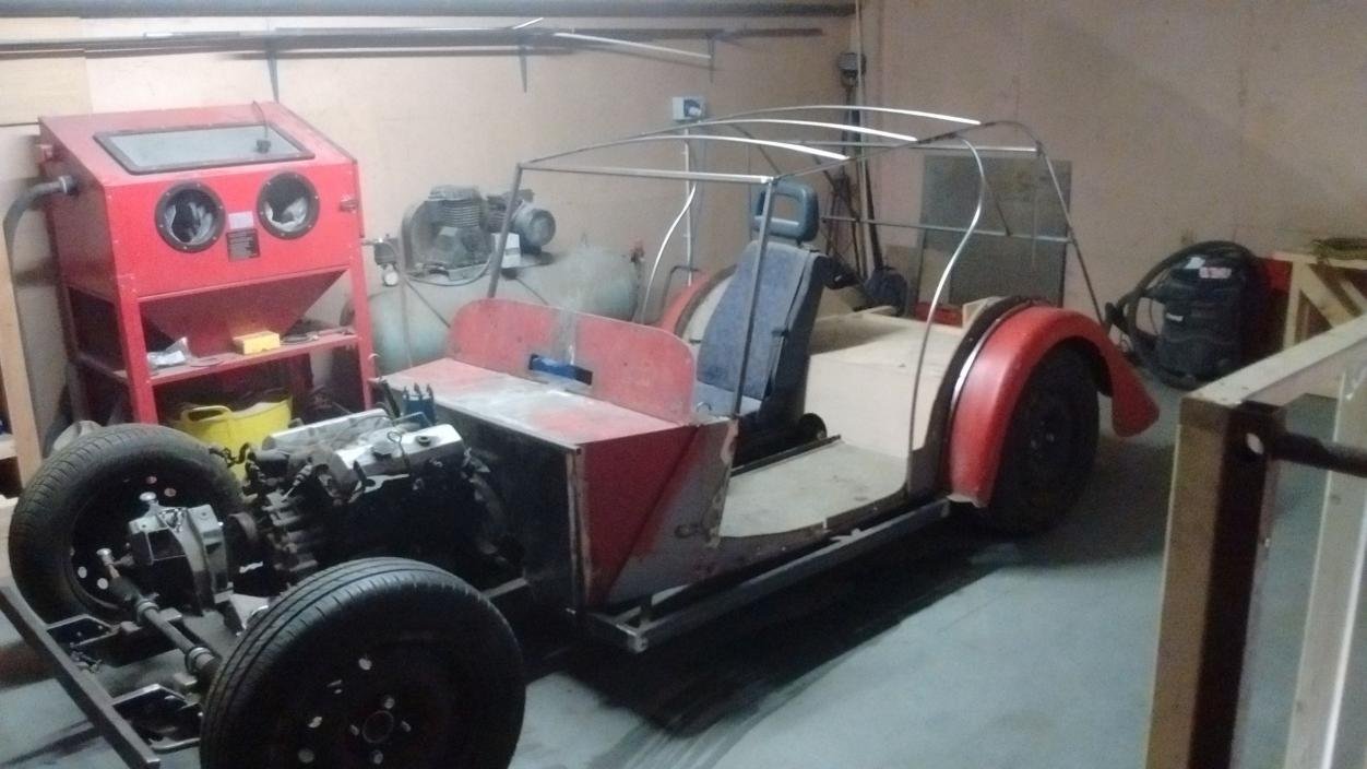

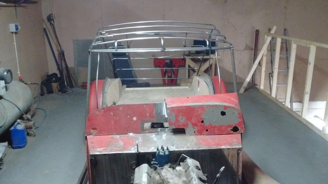

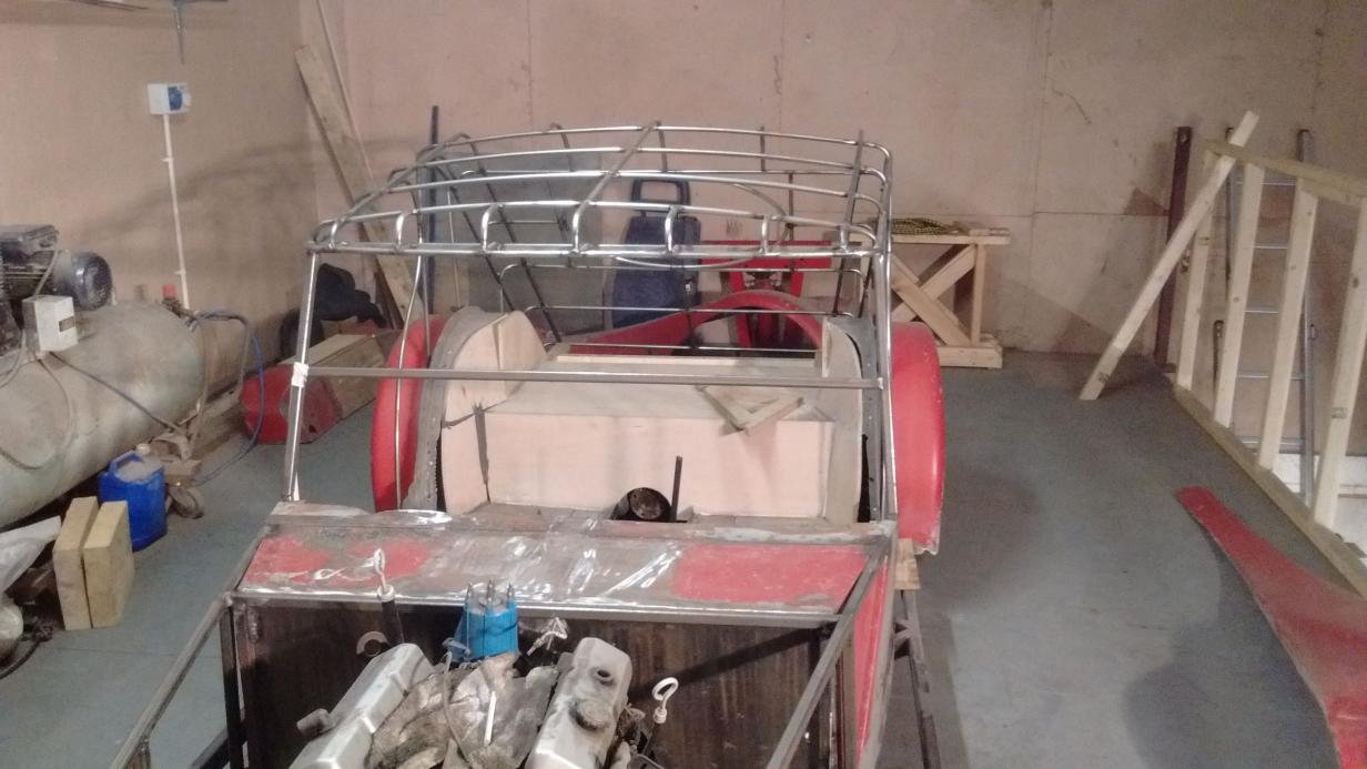

Managed to get a good day and a half on car this weekend and have started framing the roof so good progress.

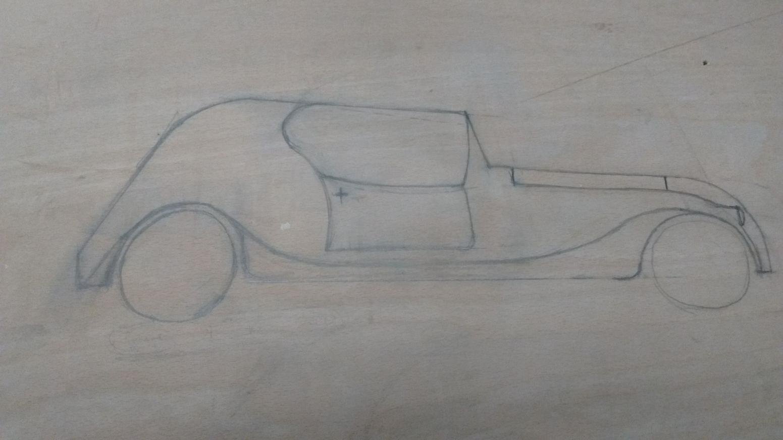

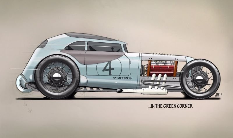

Got an image in my head of where I want to go from a Morgan's April fools seen on line, so this will be my take on it I hope.

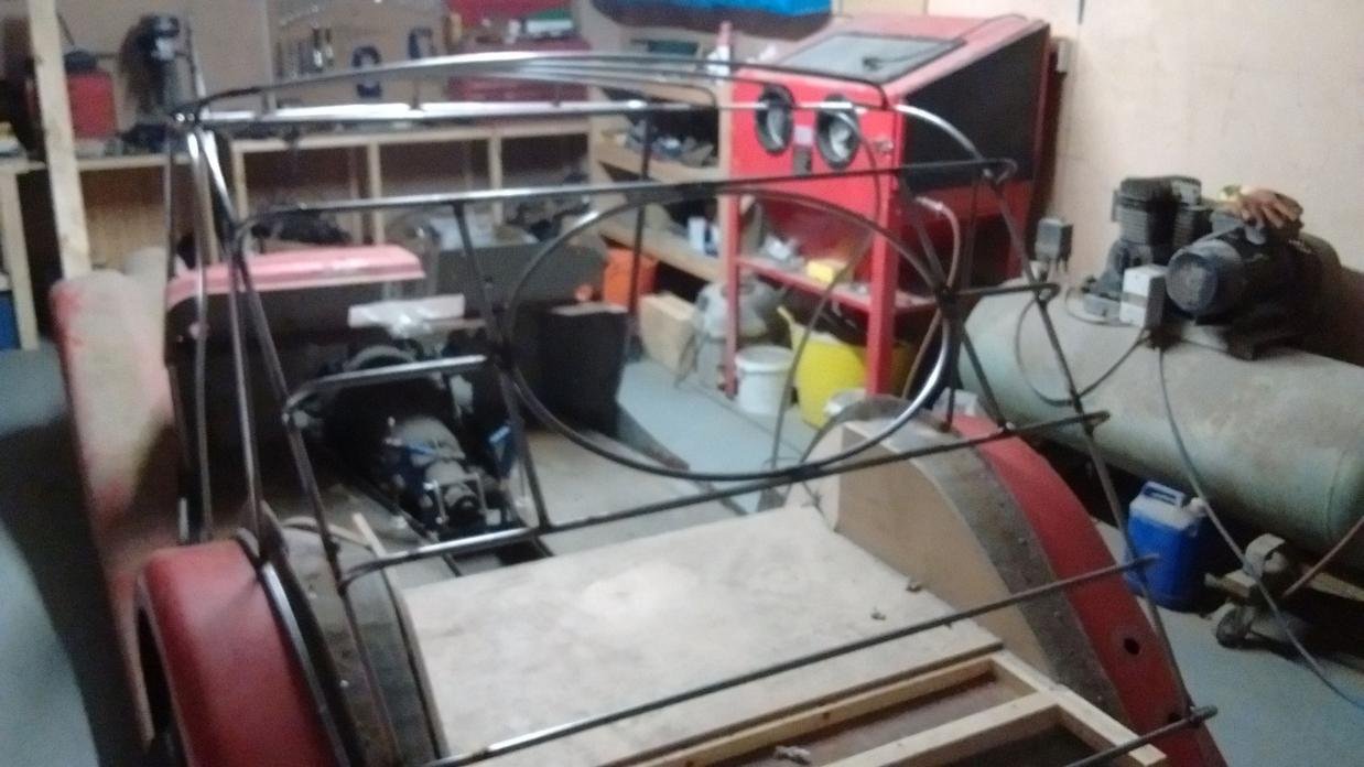

10 Jun 2018, 8:23pm

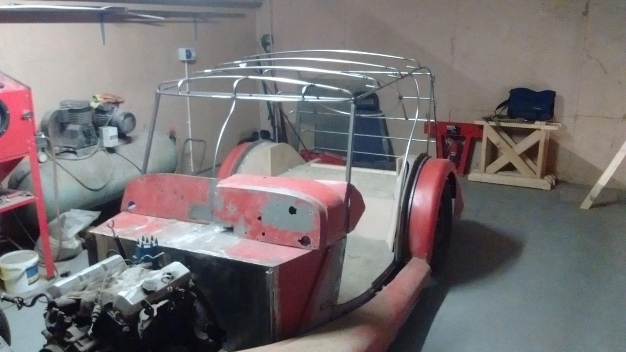

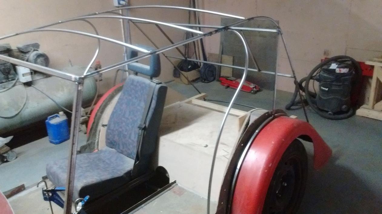

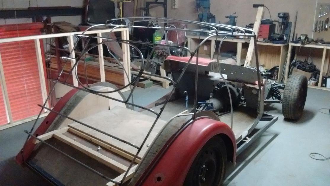

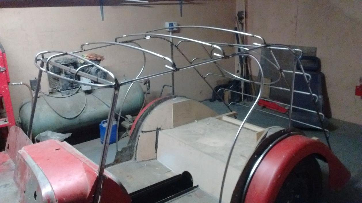

Kept looking at the roof and could not make my mind up it looked like a 2CV so have re jigged it with moor curves, changed the back window and built a sun shield. I think this might work? just need to finish all the rails.

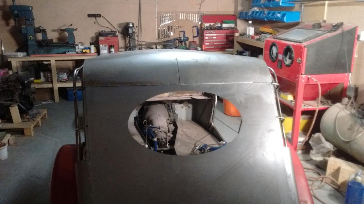

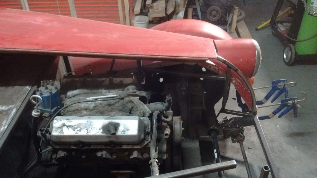

Not got to much done over the last 3 /4 weeks keep looking at the roof still some thing not quite right so bit the bullet and chopped the roof down by a 100mm I am a lot happier with it now. So have started the bonnet side frames today.

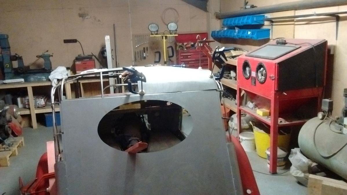

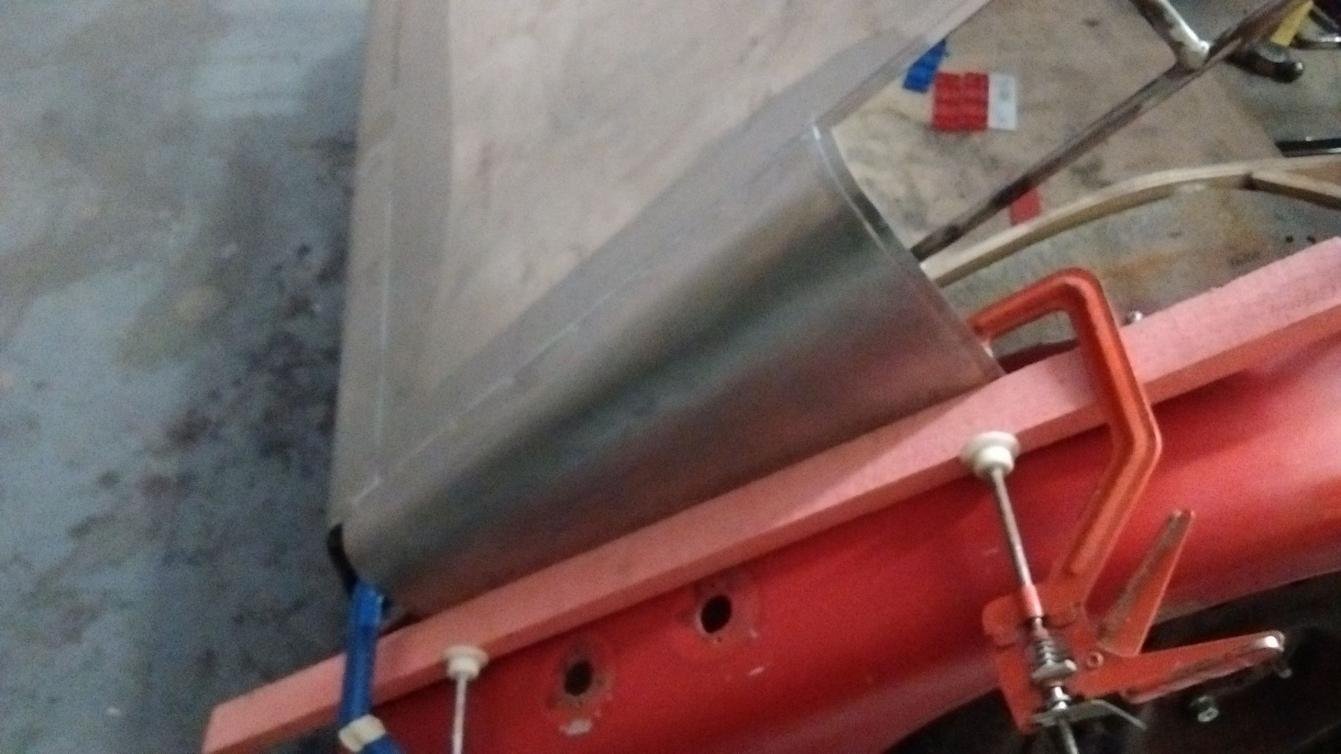

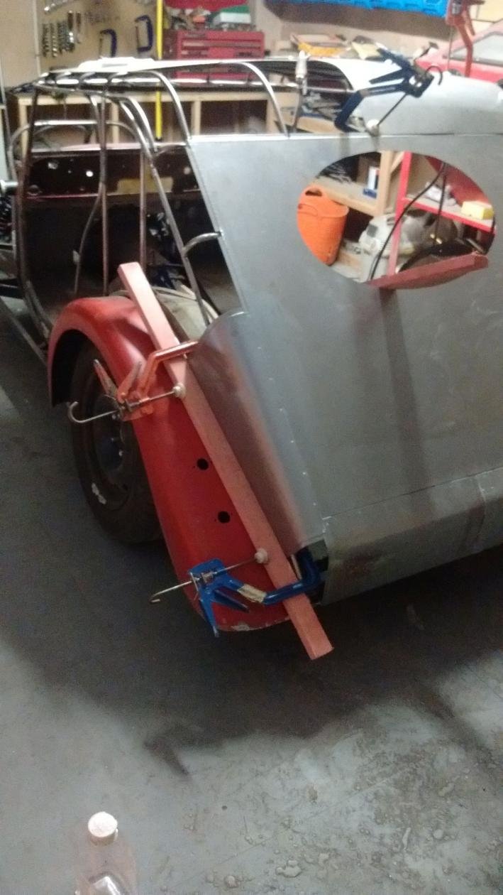

Managed to get all the framing done now and have started with some of the panels. I Have decided to bond the panels on and joggle the joints and will put in some small counter sunk pop rivets in as required, to hold the joints. The panels are in 1mm mild steel I have sanded the backs and cleaned with acetone then bonded with ever build sticks all extreme. So hope this will do the trick.
Attachment “IMG_20180827_145250268 (1).jpg” from the original forum could not be reliably recovered.

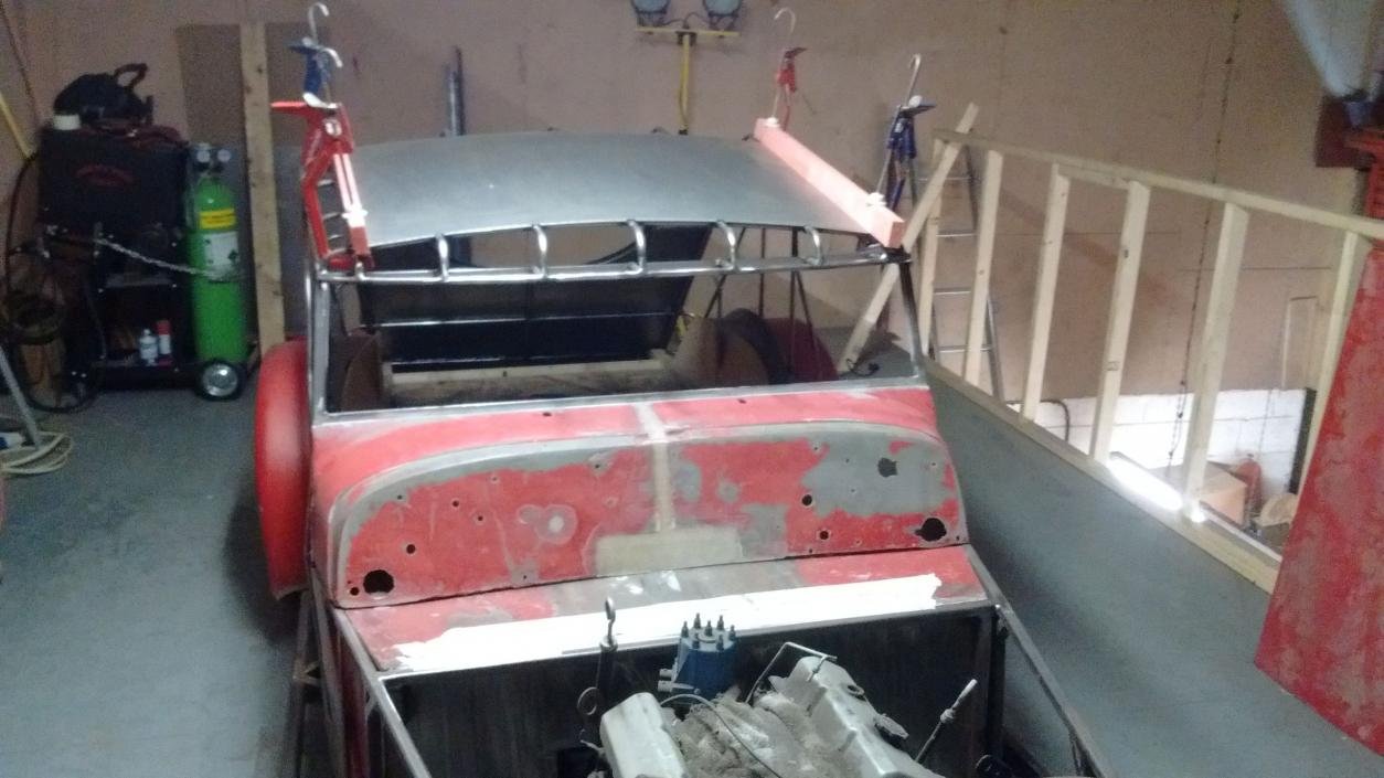

Managed to get a day on the car this week and have made a couple of panels and started a third so moving on if not all that fast, but learning all the way especially on the English wheel

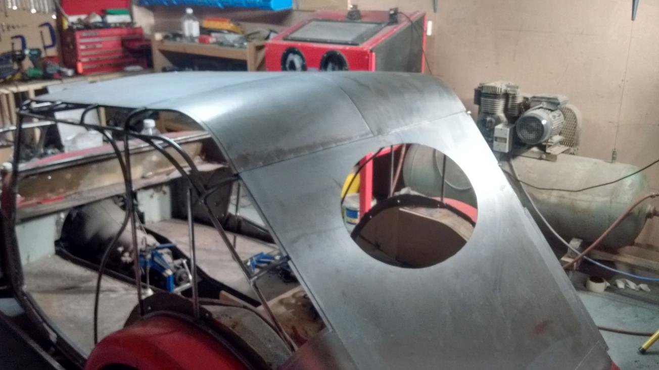

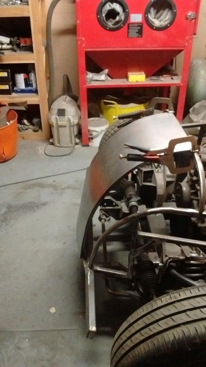

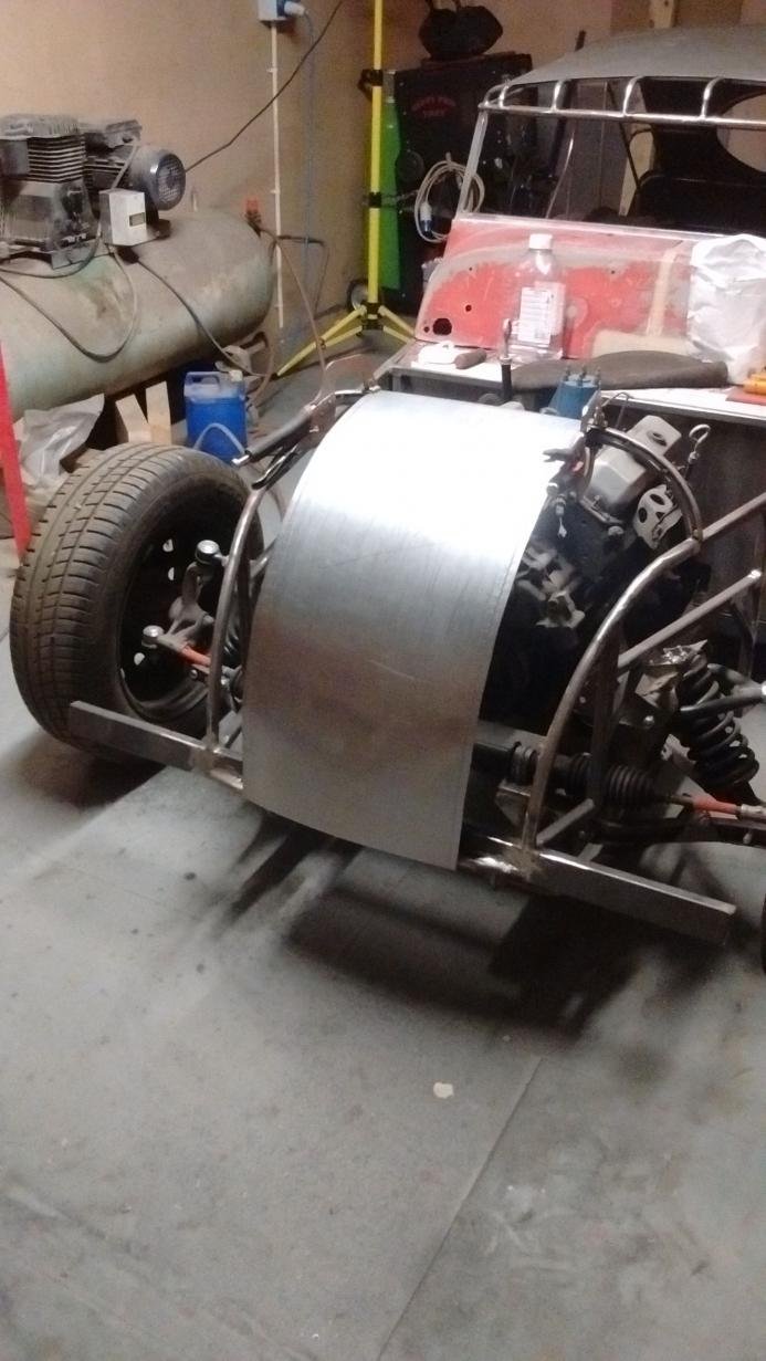

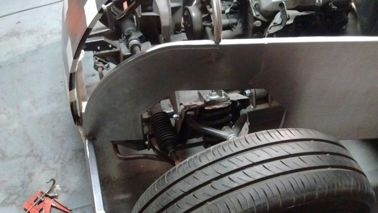

Hi I have had a bit of time on the car over the last couple of weeks and have managed to fit some more panels but slow process very steep learning curve on shaping panels on the English wheel etc. hope progress will speed up but I think the hard ones are yet to come.

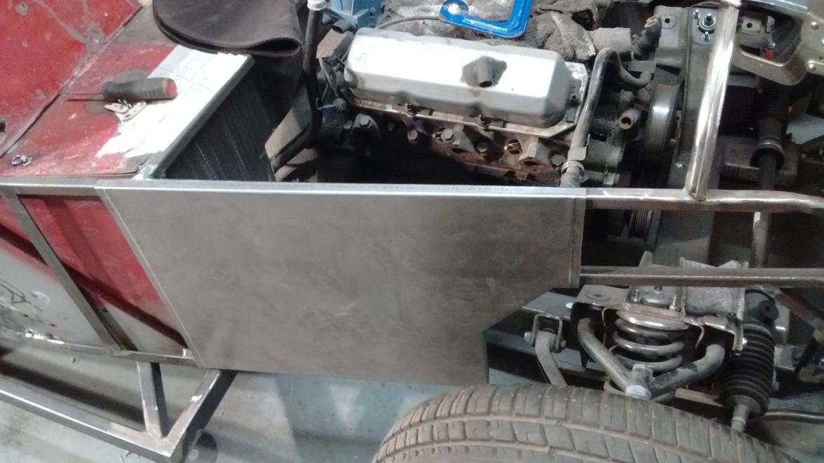

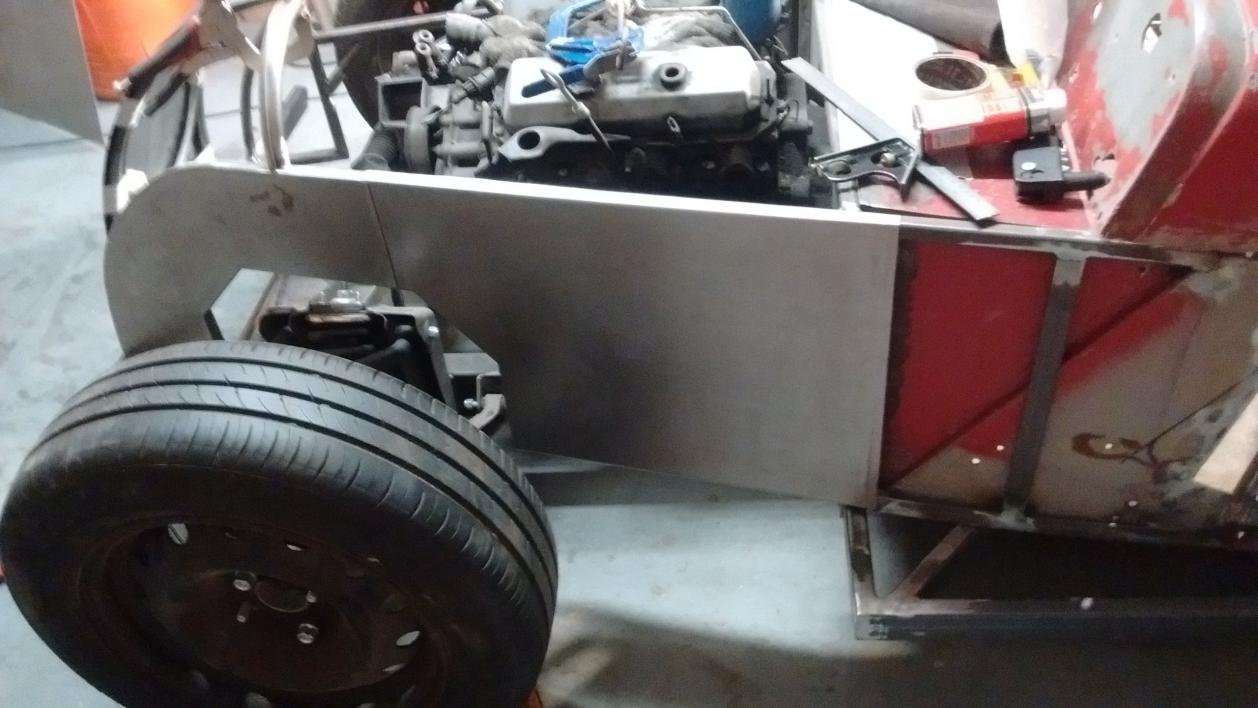

have also started side of engine bay can only fold 600mm long so will be in 3 pieces
