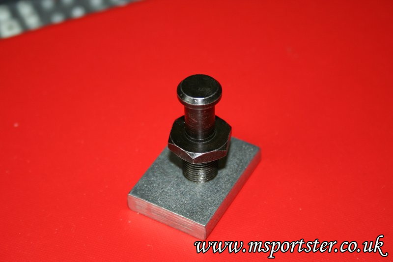

I've been trying to work out how the door latches fit to the fiberglass. In the photo's supplied by marlin it looks like there is a bracket behind. I've looked through the box of bits and found:
This to me suggests that the metal backing piece is glued to the fiberglass then the bolt attaches to that - this seems a bit flimsy to me or am I off the mark?

The rear fiberglass body when sat on the chassis correctly will have sheet metal directly behind the area of fiberglass the striker will fit. Mine has about a 30mm hole in the fibreglass and a 12 mm hole in the metal the stricker fits these and the plate in your picture fits behind the metal of the chassis. I will endevour to get a couple of photos and post them for you.

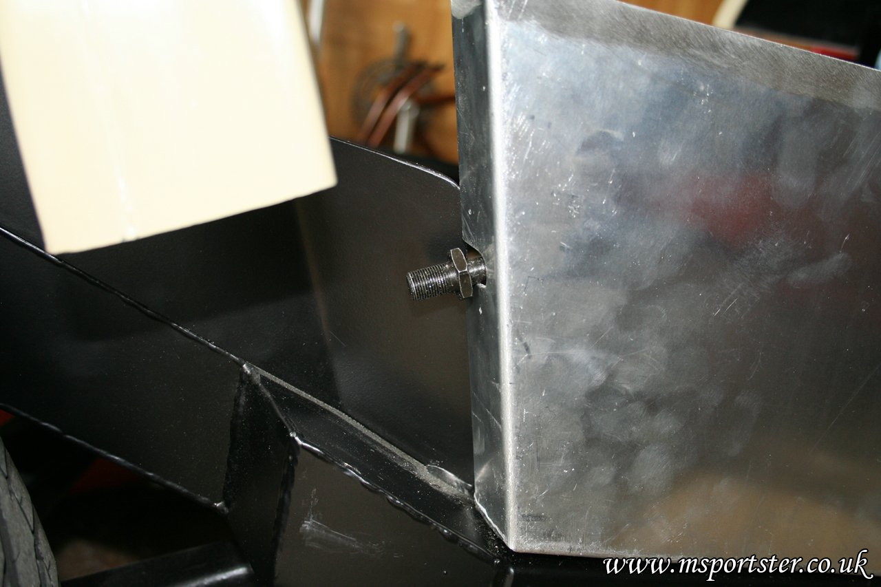

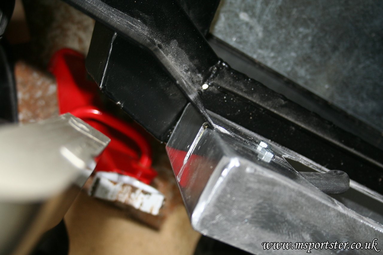

I have a good read of the ford manual and I've put the latches in the doors today. I still dont quite see how the striker pins should attach to the chassis - here's a few pics of where I am:
Unless you need to bend the bit of metal on the chassis where the rear fiberglass attaches?

oh dear, i hope i am wrong but it looks like there is a piece missing from your chassis?
Take a look at this dutch guys website in his section called Building Part 2.in a section titled "Next Milestone"
http://www.marlinsportster.nl/
In his words.............
The chassis missed the brackets to put the door pins on. Somehow forgotten? Don't know, but after some emails, I got a nice pair of brackets from Mark to bolt on. Perfekt Job from him.
I hope I am wrong?
Peter
3 May 2006, 5:14pm
:mmph: I hope not :icon_neutral: guess i will have to send some pics to Marlin to see what they say :suspicious:
3 May 2006, 6:45pm
It certainly looks as if the mounting plate for the stricker is missing from your chassis.

Mystry solved! I had a chat with Terry today - they stopped welding these to the chassis as there had sometimes been fitting problems with the doors and the thickness of the fiberglass. She's sending me some brackets.
