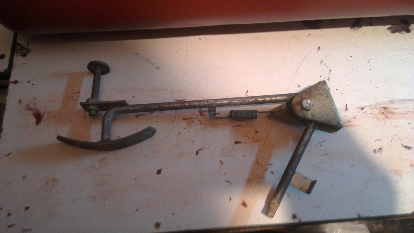

I have started only a few weeks ago and had a chance to go to the garage a few times, so you did not miss a lot - mainly cleaning and painting the chassis and other attached bits, which is probably not the most interesting part anyway. I was very lucky to buy, what I think is a rolling chassis in a very good condition, which should make the build a little bit easier hopefully.
I will try to upload some photos to bring us to a current point in the build.

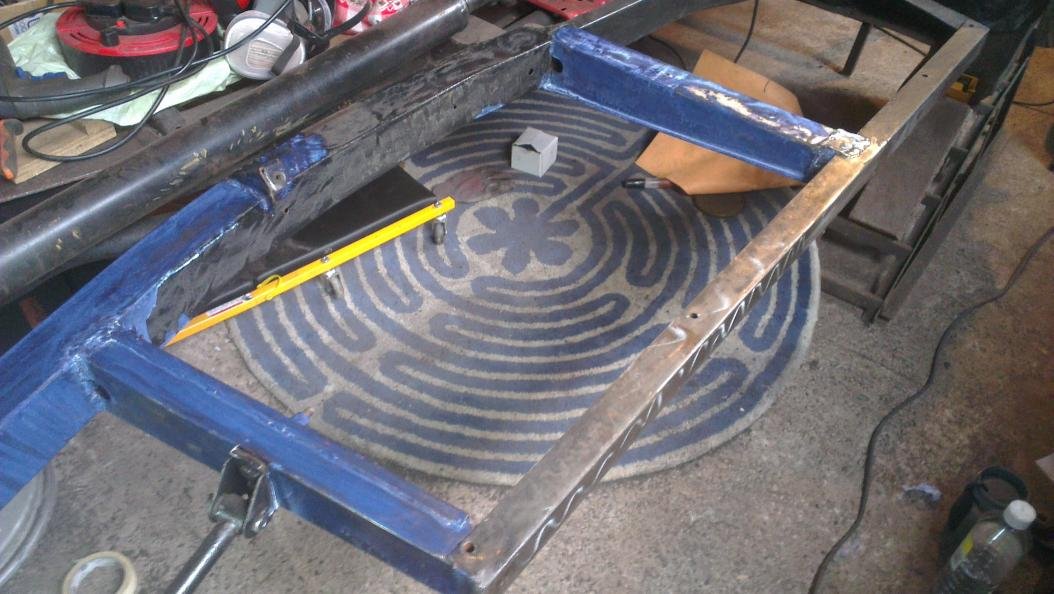

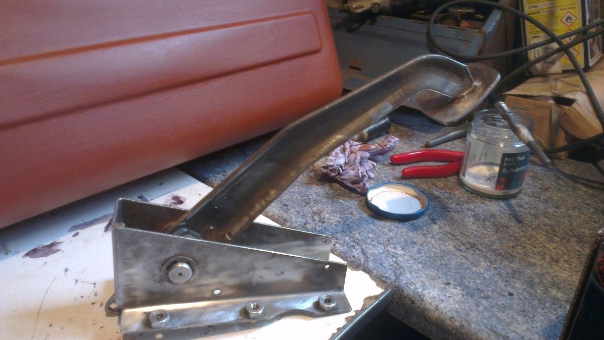

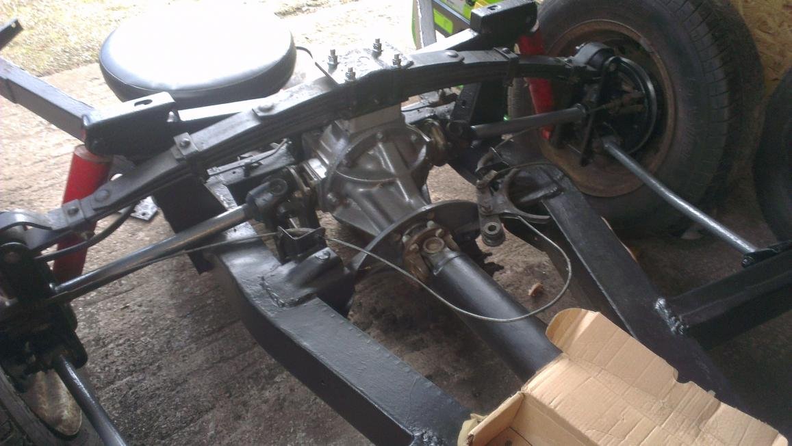

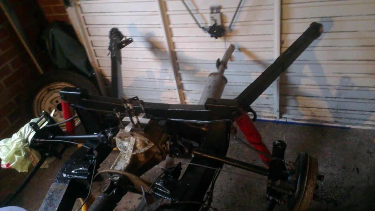

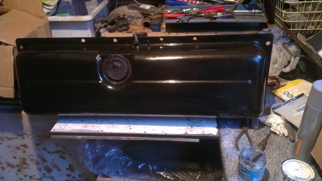

Chassis is paint stripped and treated with Kurust (everything except the main middle bit which was in excellent condition) and everything is painted with 3 layers of chassis black.
Diff casing is also cleaned, treated with Kurust and painted

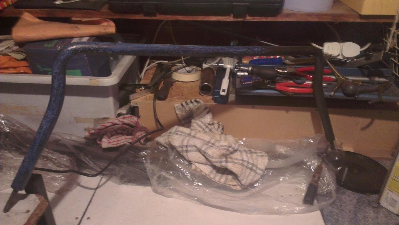

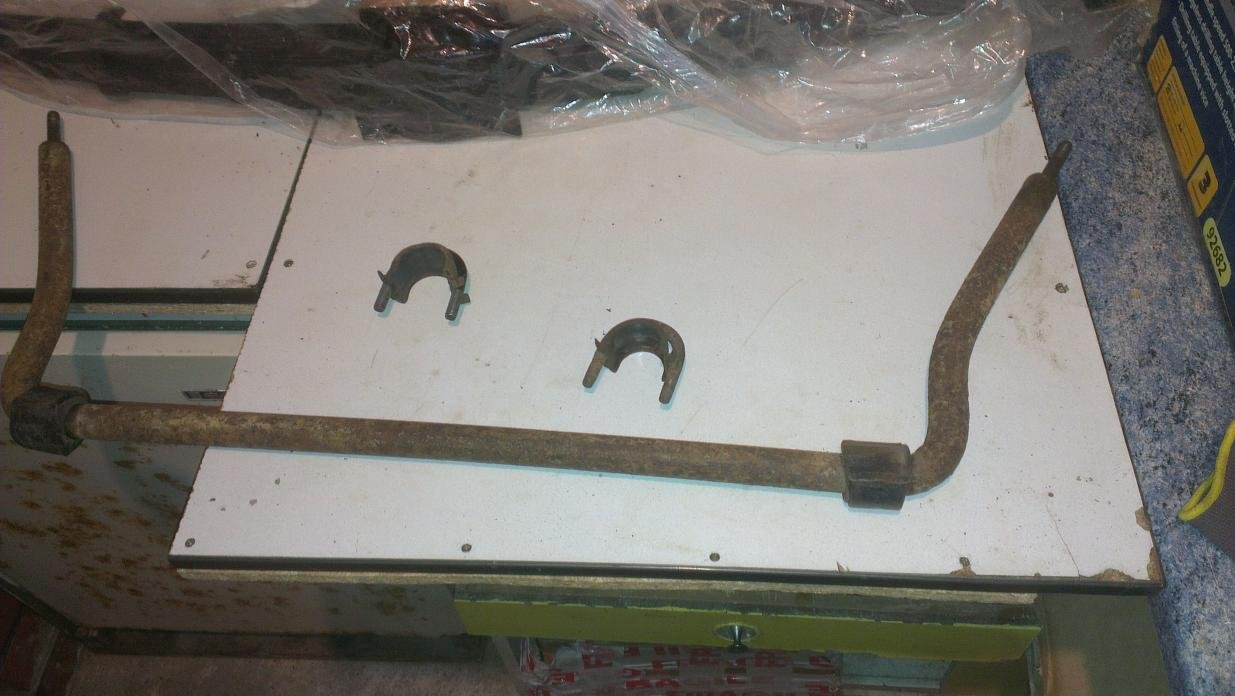

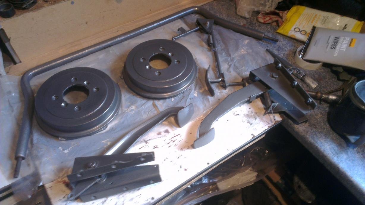

To balance the car handling, the anti-roll bar at the front needed to be upgraded too. I have bought 7/8" Spitfire one and this will replace the original Herald one.
Cleaned and treated with Kurust.

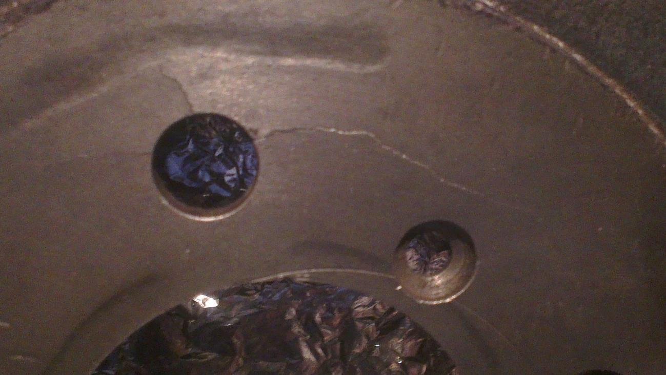

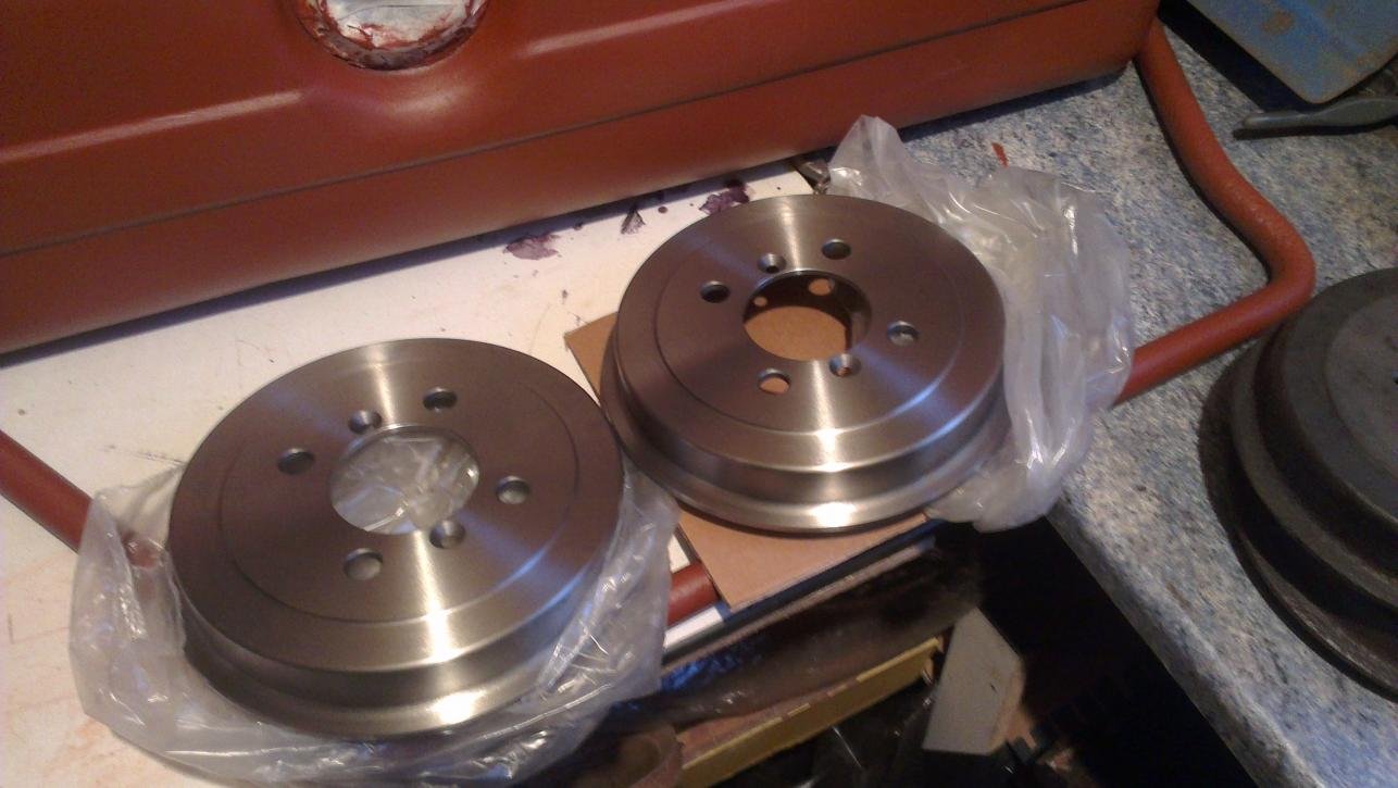

Both drum hubs had some cracking on them and were replaced with brand new ones. I have inspected the condition of the rear brakes and it was excellent.

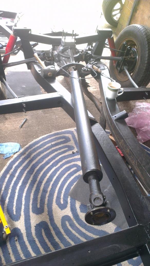

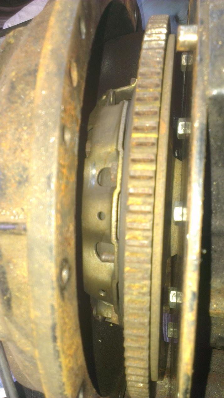

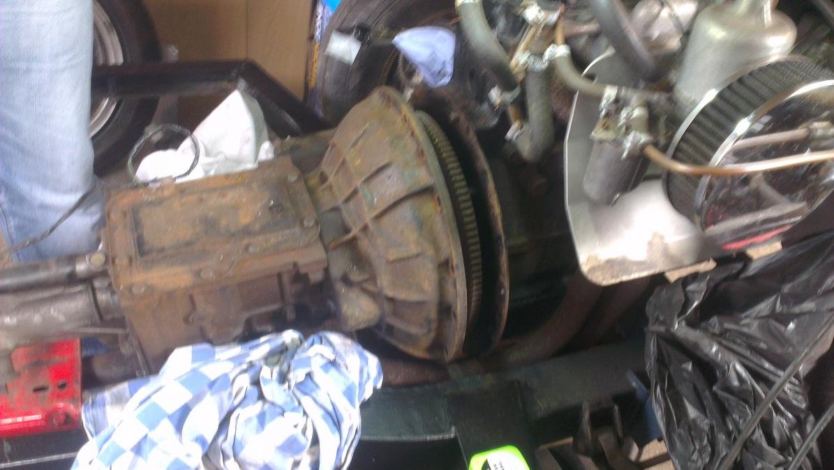

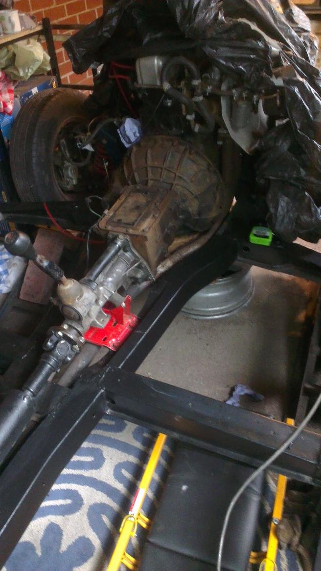

Had a couple of hours on the car this week. My friend Johnny came over to help me with the gearbox removal. I wanted to inspect the condition of the clutch. So, we marked the prop shaft for later alignment, and removed it.
We saw that the clutch was nearly new and didn't have to remove the gearbox completely, which was great news.
Close up of the clutch
Next job is to clean and paint the gearbox and to continue with the front suspension and the engine.

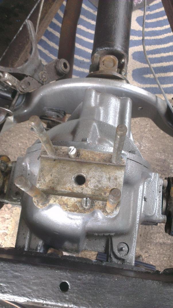

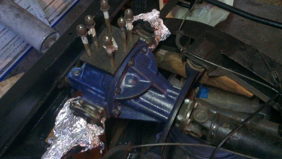

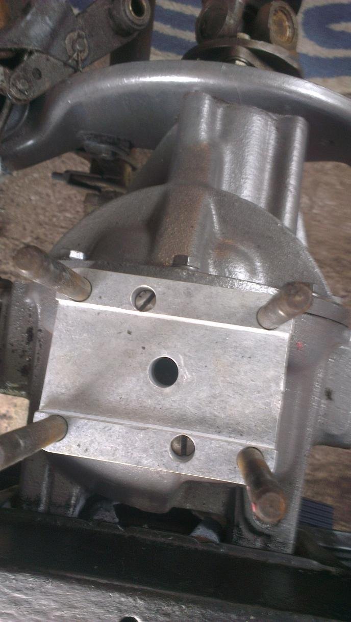

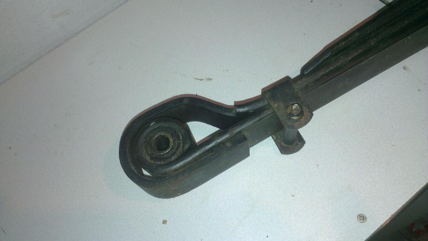

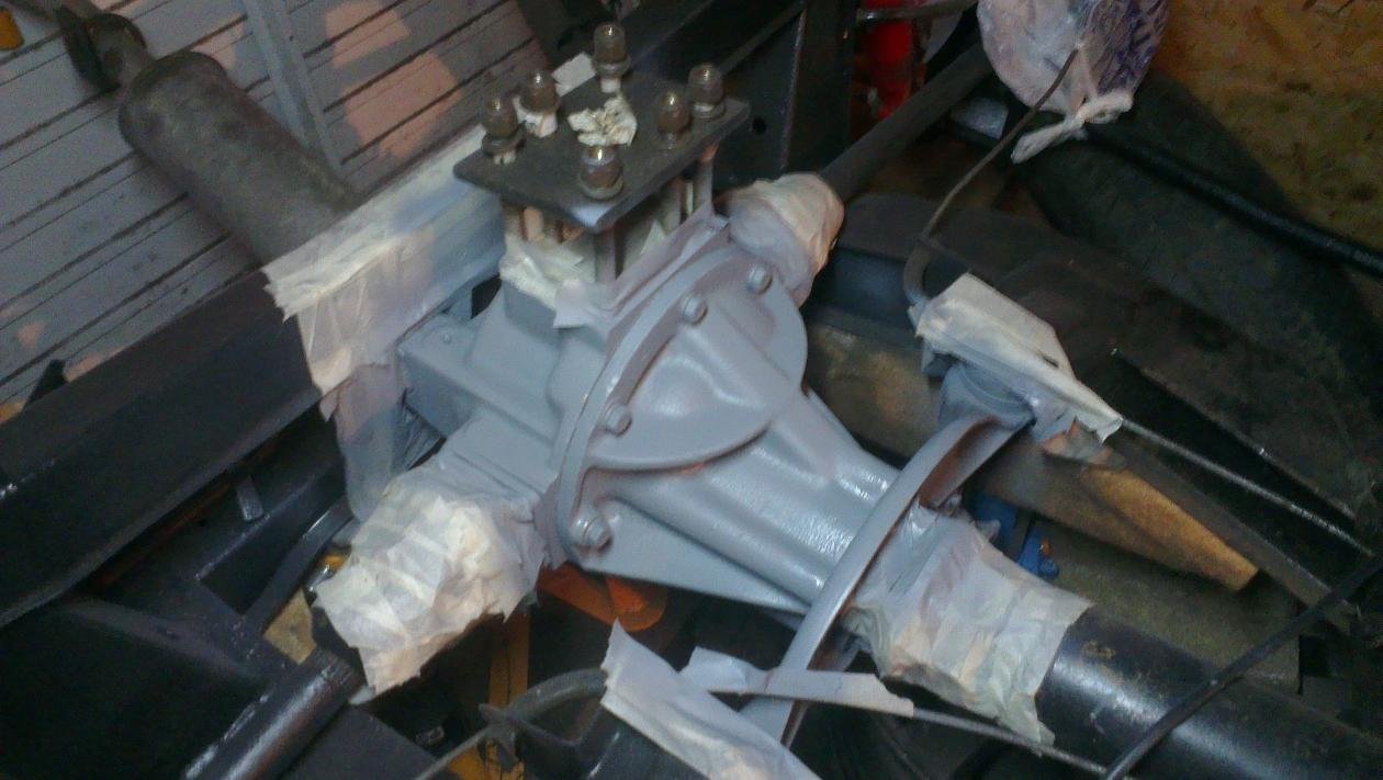

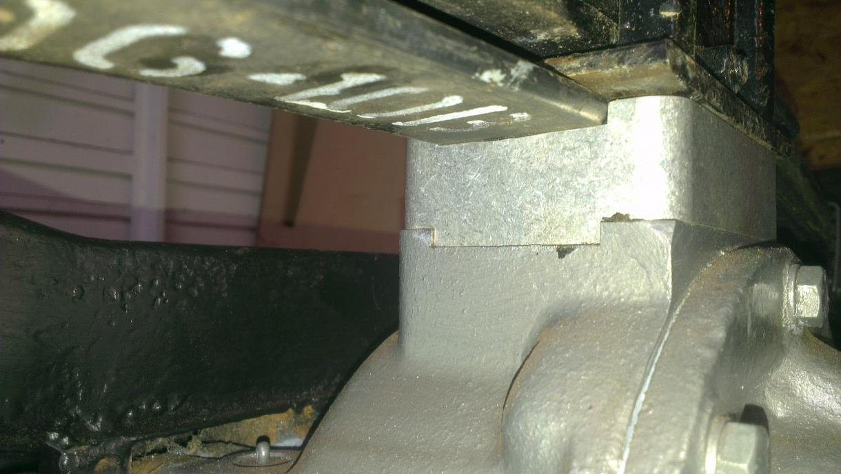

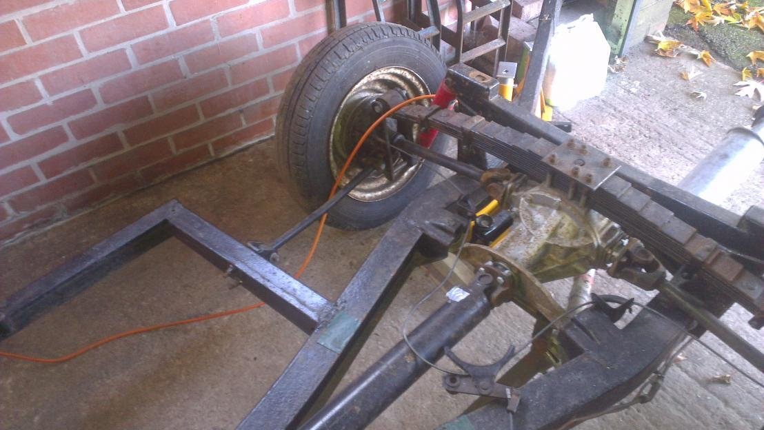

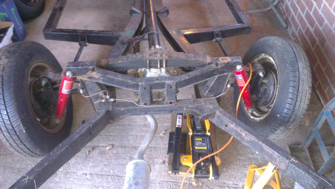

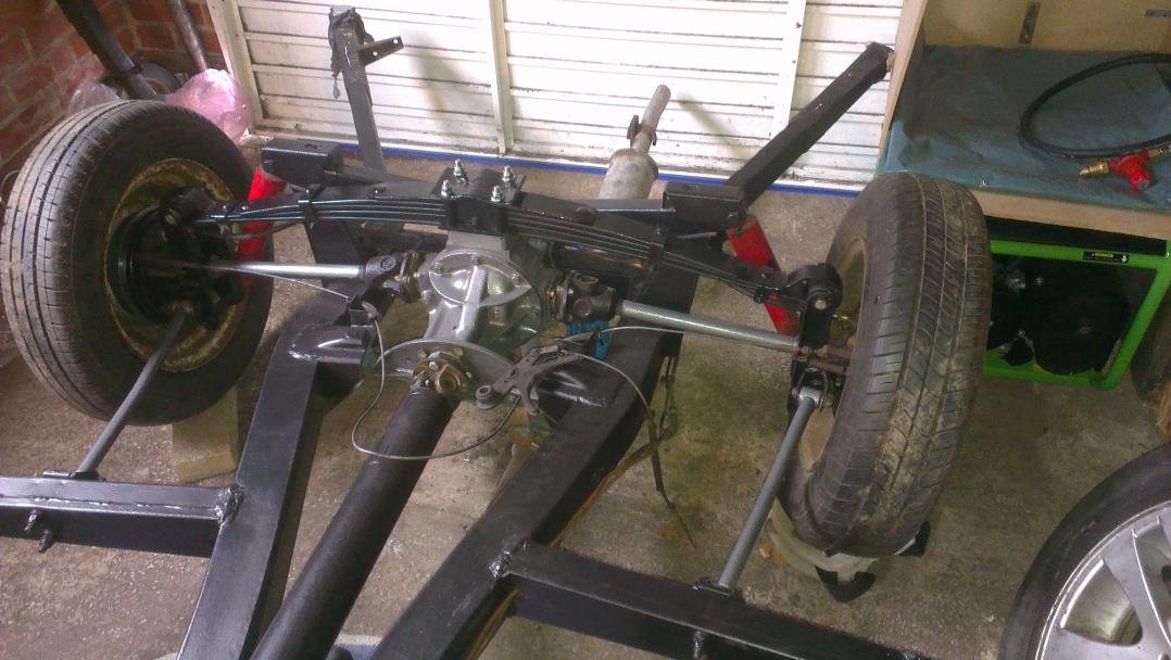

Also, installed the swing spring and 1" lowering block. Lowering block was a tight fit and needed a bit of "persuasion" with a rubber hammer, but we managed to insert it on to the diff casing.

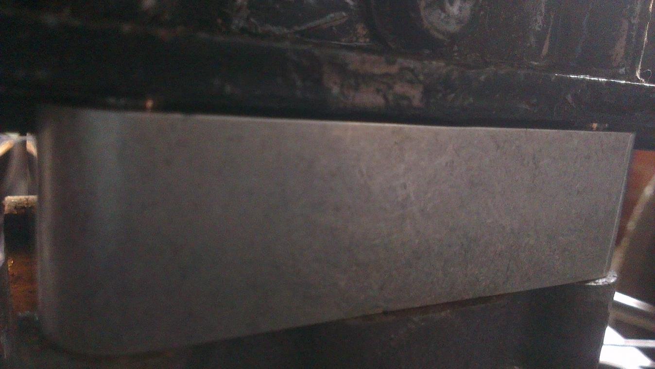

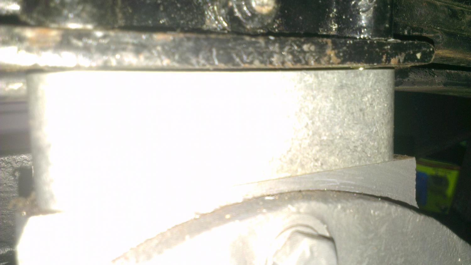

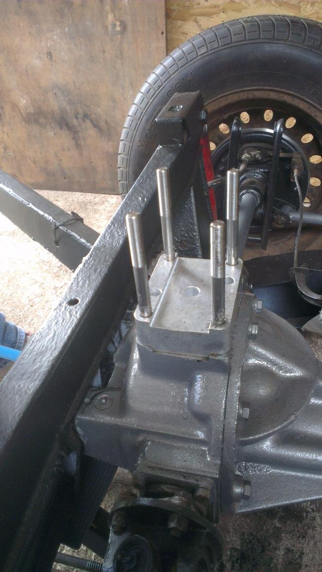

All went well, but there is one thing I am not sure about so please, if anybody can advise it would be great. I have tightened the screws as tight as it was possible but I still have a small gap between the lowering block and the bottom plate (first two pictures below), even though the bottom leaf of the spring fits quite well in the gap of the lowering block (last photo).
Nice work. Just a thought, did you loctite the blanking studs in to stop them dropping into the diff casing?

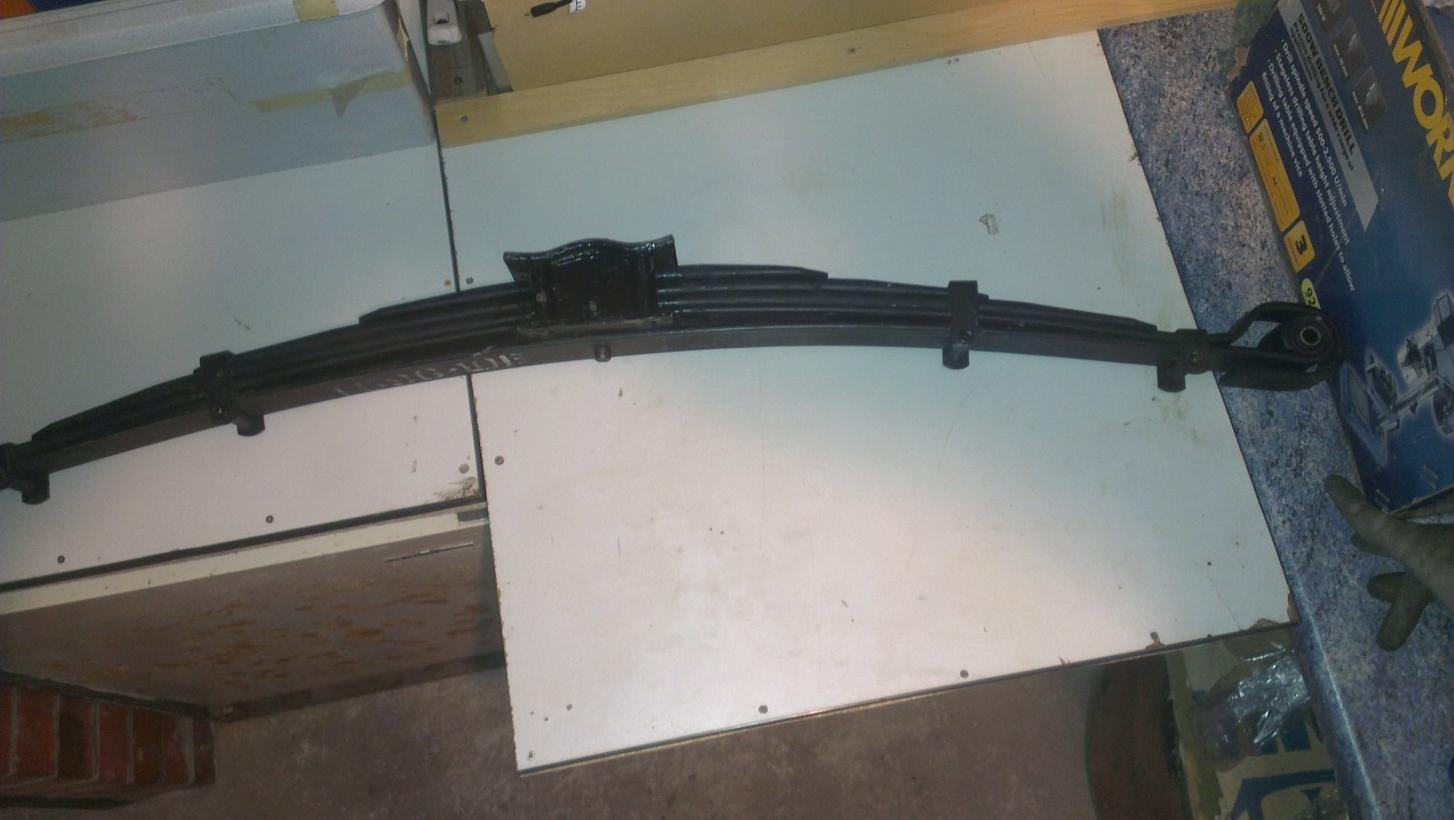

The slight gap between the lowering block and bottom leaf could be to prevent the rest of the leaves in the stack from being clamped in place and allow them to move laterally. As far as I'm aware, the bottom leaf should be fixed to the diff and the rest should be able to slide from side to side -
Mister Towed - Thank you for your reply. I did not use Loctite, so thank you for pointing this out. I've only tightened them as much as I could with mole grips, but now you've mentioned this I think I should use Loctite, as the studs are not held with the nuts above the spring like before. So, next time I'm working on the car I will fix this.
I have another question I hope someone can help me with please. I was reading in a Herald manual that the original spring has the front and the back side, and should be positioned accordingly. I've checked the old spring and I saw the markings. However, I could not see such markings on swing spring. Does a swing spring has front or back side, i.e. the side of the spring that should point towards the engine?
