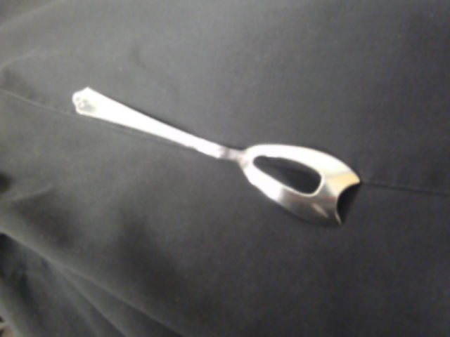

Hi there! I am building a Classic Replicas Dino in Athol Massachusetts, USA. I have made my door handles and embellishers from stainless kitchen spoons. They aren't perfect, but I have to draw the line somewhere, as I can't afford to buy everything that I want to. Here is a picture of just the embellisher. I will try to post a picture with the handle and embellisher attached on the car at a later time. All told, I came up with this for about $15.00 each. / Jon
1 Nov 2016, 12:37am
Very creative, I like it!

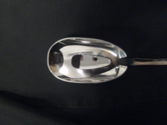

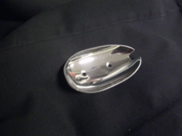

11 Nov 2016, 12:59am
Handles made from spoons
Hi there! Here are a few pictures of the handles in progress. I bent the spoon stem back around on itself and welded it, so I could drill a pivot for the handle.

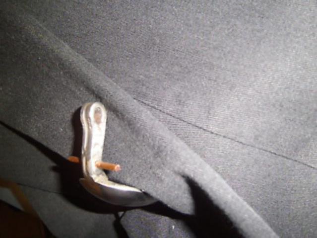

11 Nov 2016, 1:04am
Handle pivot
This is the welded spoon handle.
Hi Jon
Very impressive, did you use a dremel to cut the shape out of the spoon?
I’m thinking of copying your idea for the embellisher, just need a slightly bigger spoon!
