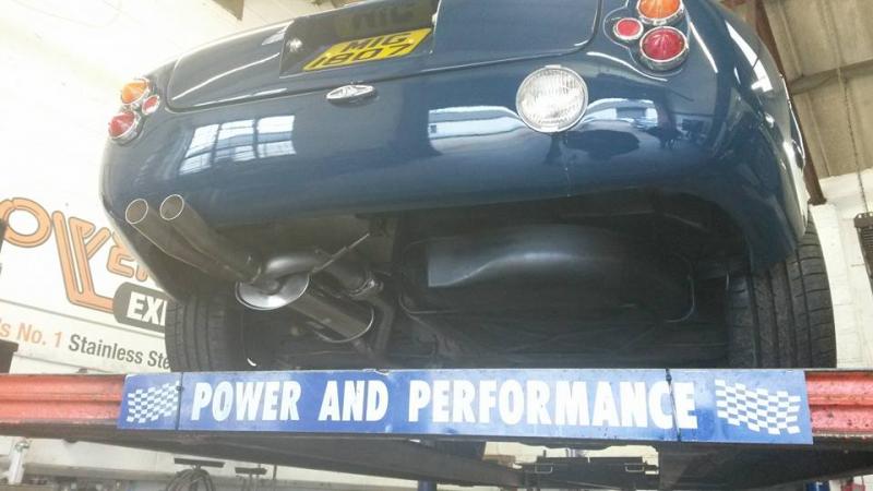

I will try to find a photo of it. A very neat installation with a 1:2 box squeezed behind the cat and in front of the diff allowing to pipes to flow unrestricted out to the back of the car. Similar to above but without the need for the two silencers.
5 Aug 2016, 9:44am
This shows the two (rusty) pipes from the engine going to the Cat. There is a single pipe about 6 inches long between the Cat and the new shiny silencer. Coming out of the customer made short silencer are two 2" pipes that are nice and symmetrical and unobstructed to the back of the car where there are some 3" upturned tips

Probably best, but just a small one.
My middle photo shows the size for mine and that is fine
