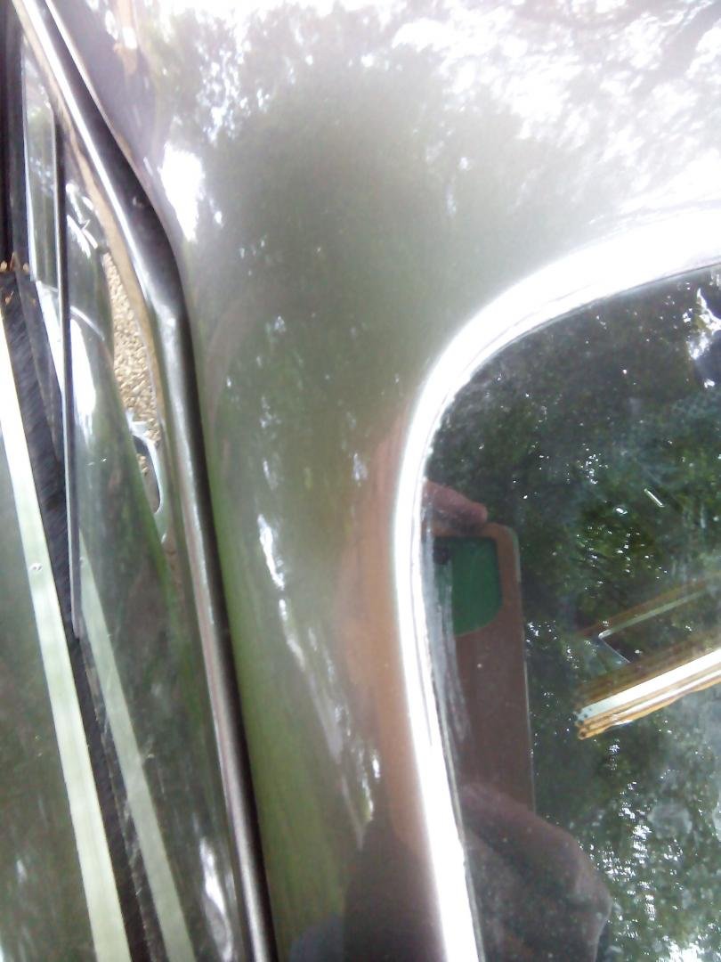

bloody typical had it in gel coat for months no problem now its painted starting to crack on top of the window screen. The car has such a high gloss finish it stands out and catches your eye. Good job I have a good understanding with the paint shop, I give him lots of money and he repairs and repaints the car..be sorted for friday :whip:

I know it would be a bit of a bodge but could the stress crack be covered with a little alloy trim? Lots of cars have a trim on the rear and I'm sure I've seen them on the front too. Sods law says that as soon as you repair it, it will happen again.

think if I did an other build the same I would cut it and have a line in it. looks like its going to be a common fault if I drove it like Stirling moss or on track days I could understand a stress crack. But this has come about when its parked on the drive for two weeks not in use ,,,,buger
24 May 2016, 1:32pm
Cracking due to heat? Had a few hot days, darkish paint?
Cut and a distinctive line would be a good idea.
I do wonder if sliding the pillar cover underneath the roof is the problem ? it puts pressure on that part of the roof.
Mine fits perfectly on the nearside, but the drivers side i have had to cut the little end piece off to get it to line up.
Good shout ref putting a slot in it, make it a feature of the car.

well better to happen now and get it sorted then after sale, typical two people phone yesterday to view this weekend put them off till next week car will be sorted finger crossed. The Z3 must have a lot of flex in the chases only time will tell with this one. andy

Have you considered the filler used on abs bumpers, it moves but doesn't crack
27 May 2016, 8:11am
I do think as at the moment there are only two cars we no of having this fault it is probably the amount of flex in the car causing the problem. stiffening the chases could work but with coil overs you will be in for a rough ride . Sheffield is full of pot holes and bloody speed bumps ever 100 yards where I live. I am not a big fan of the kit wrapping around the window screen it looks good but if you ever needed to change it you would have to trash the kit/paint work. Cutting the kit at the top of the window screen and have a 2mm gap may or may not help with the crack only time will tell but it would help getting the window screen out if a strip could be removed easily . andy

all sorted the guy I use can have his faults but he always pulls it out the bag when I need him. Would have been nice not to happen in the first place but £80 for a quick fix and repaint happy again,just need to give it a wash :party:

Sure it will not crack again? This area is under a lot of stress!
The metal A-pillar with its windscreen is very stiff and has a long lever from bottom to top where it is glued to the fibreglass roof...
I would keep an eye to this area if this is a structual problem or only a bad paintjob thing! Just my 2 cents...
