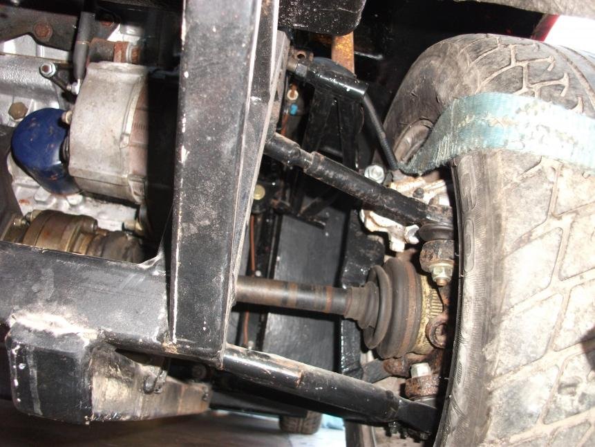

I have just purchased a part completed Classic replicas Dino with the Alfa V6 and it looks like there is an issue with the height of the engine. This is something that the previous owner was obviously wrestling with as there are no rear shock absorbers fitted as yet. You can see in the pictures how the top engine mount protrudes from the top of the engine bay
I'm reasonably happy with the current angle of my half shafts.

Hello Neil, thanks for the photos !
Yes, my Dehavilland car is fitted with the subframes from the MGTF
So I should be able to modify or fabricate a subframe to mount the V6
I guess the issue is if the engine has to be mounted lower to gain clearance to the engine cover, the drive shaft angle will increase
My understanding of driveshafts is that they should be close to horizontal at ride height so that the angle is similar in bump and rebound.
If the engine sits lower, the driveshaft angle will increase and will increase further at full bump

Another view of driveshafts ( NB is on a lift with suspension in full drop) and engine height.
A later consideration, I hadn't thought too much about at the time of this was exhaust design and clearance ie the lower the engine the tighter gas flow bends , hence does affect ground clearance

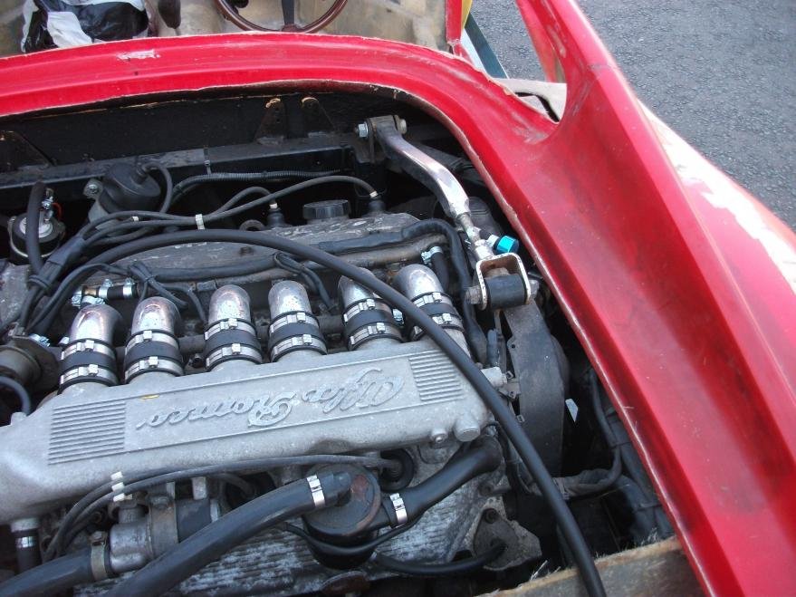

From your other pictures it looks like the Alfa V6 almost fits under the engine lid of your Classic Replicas body/chassis with engine mounted with almost level drive shafts? Is it just the engine mounting/stabilising rod (not sure what its called) that stands out proud of the engine lid? If so, couldn't it be re-routed as its location doesn't seem critical.
Unfortunately the rocker cover also stands proud of the engine lid(see attachment), it's something I need to address, not quite sure how yet.

I guess plenum chambers can be altered/replaced/repositioned but the top of the engine bank itself can only be either lowered by rotation of the engine or by dropping the engine. The latter affects the driveshaft angle too and I'm not sure how much you gain by canting it forward more. That leaves adjusting the body. Unless you want to do some major work the best option seems a hump in the engine lid.
31 Jan 2016, 8:42pm
I agree with the above post. Least expensive best alternative is to hump the lid.
