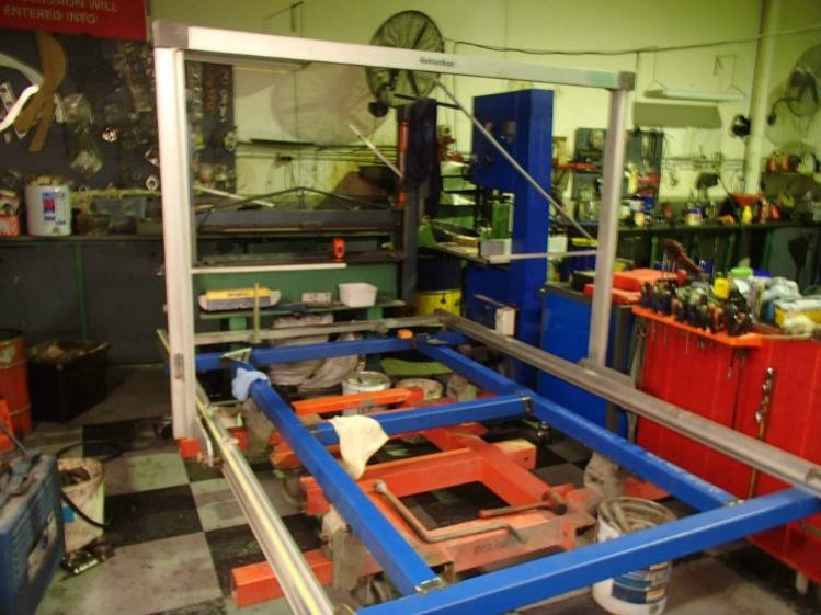

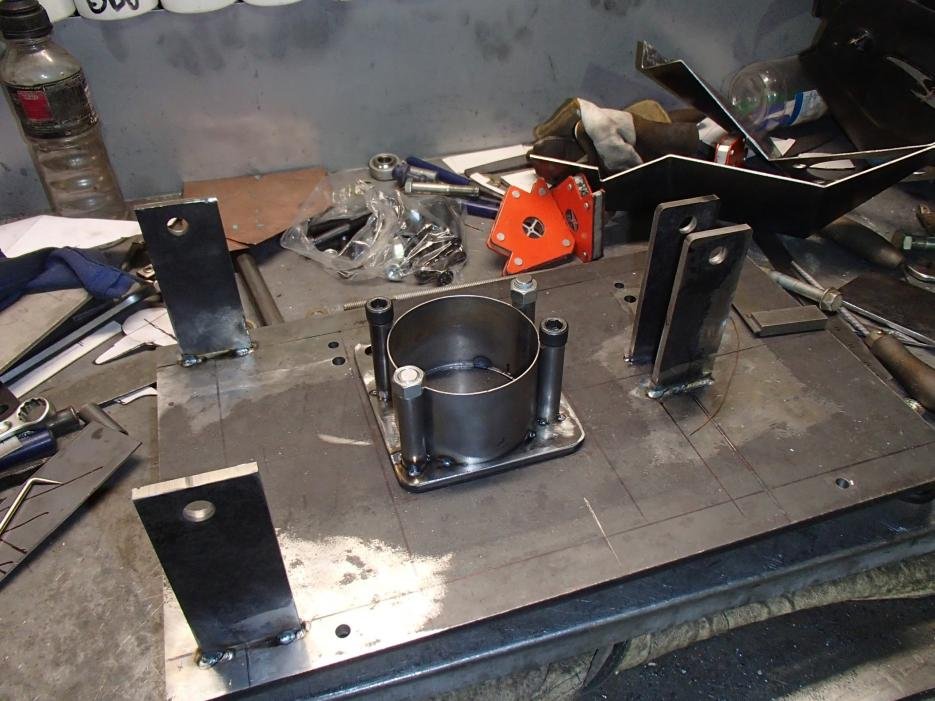

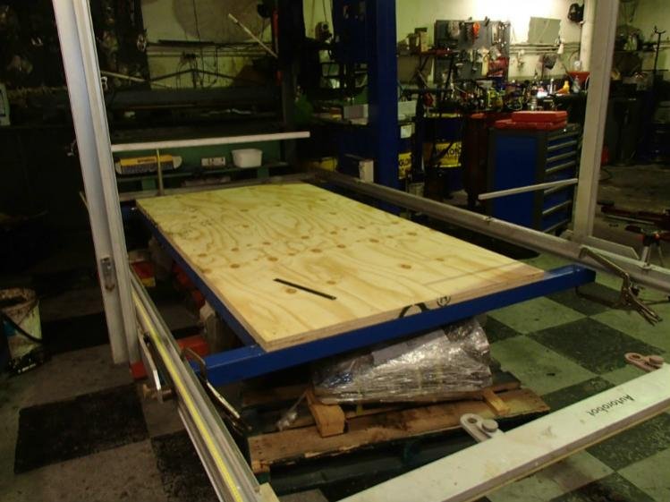

I have made a measuring table to build on.
It has XYZ measuring system.

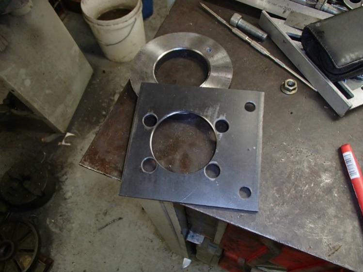

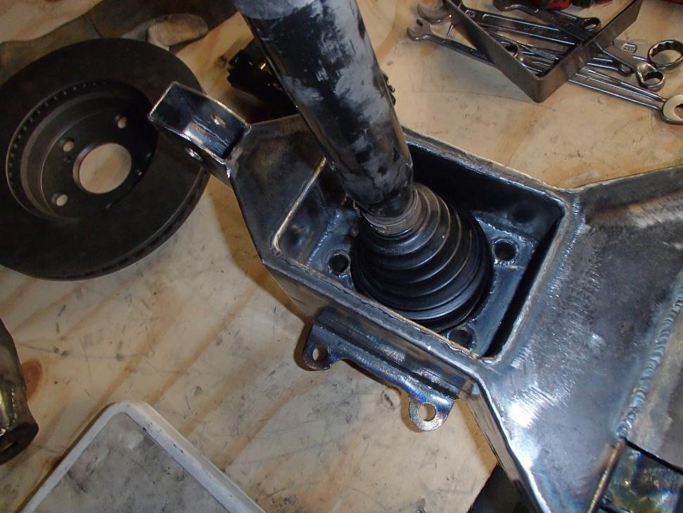

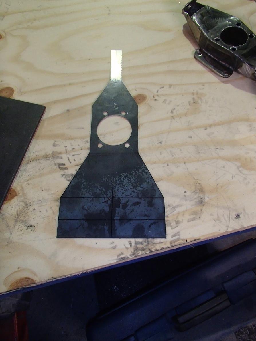

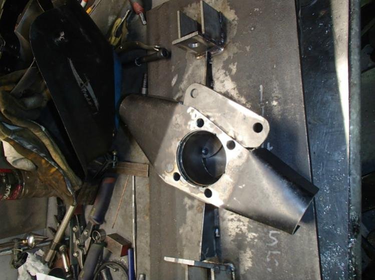

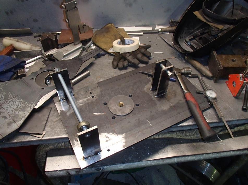

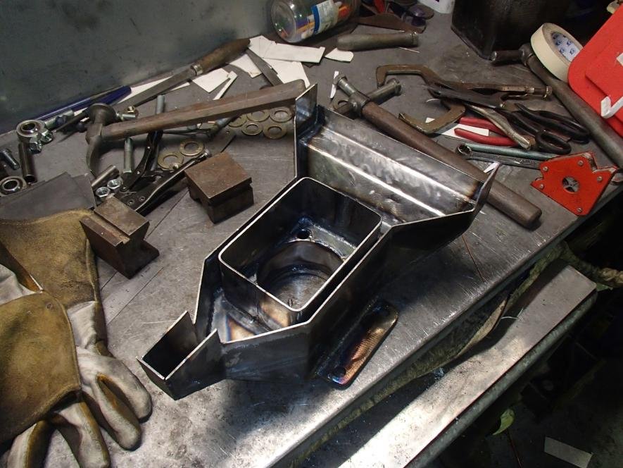

Front uprights
I made these out of 2mm hot rolled sheet.
It has a yield of 300mpa, bright mild is 200 so it 30% up.

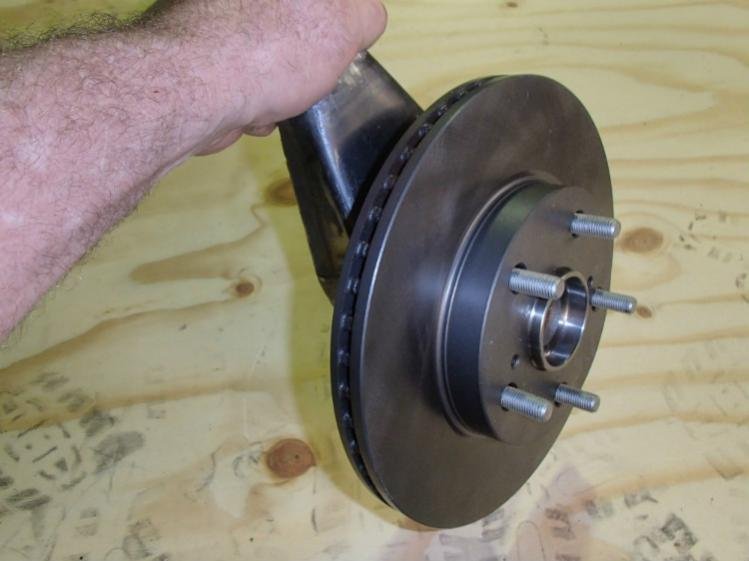

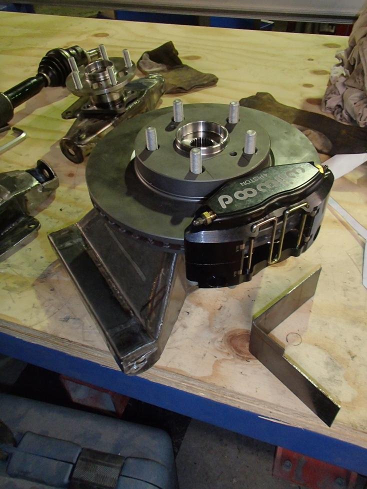

I wanted to make this build a simple as possible so I selected a Toyota Corolla 2010 as a Wheel bearing brake doner.
The 206 runs a 13" wheel so I wanted to get some brakes under it.
The original also had inboard rear disks, I am going out board.
The Toyota has a 275 vented disk, the wheel bearings are hub styles, So front bearing will go on the back and rear to front.
Front disks all round and wilwood calipers all round.
Caliper bracket is attached internally, It is built into the upright to spread the load , I did not want to mount onto any particular panel.
It is 6mm
Main sheet folded to the general shape.

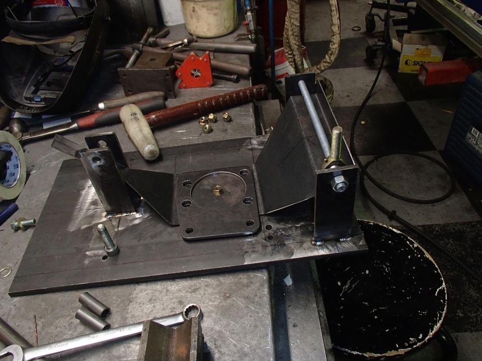

All this is fitted in and out of the jig to keep you on track with the main points
that really count at the end of day.
Center tube and crush tubes go in and fully welded
Side panels, top bottom panels, I have added an extra layer on the top and bottom that ties it in down the side but I have no pic.
20 May 2015, 11:36am
Have added to the top a bottom plates since but no pic.
Wheel bearing bolts on through the 4 holes.

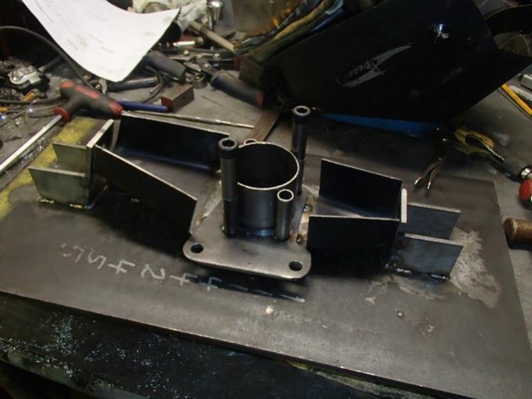

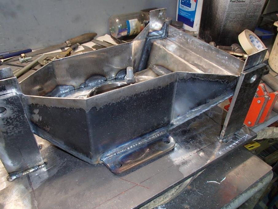

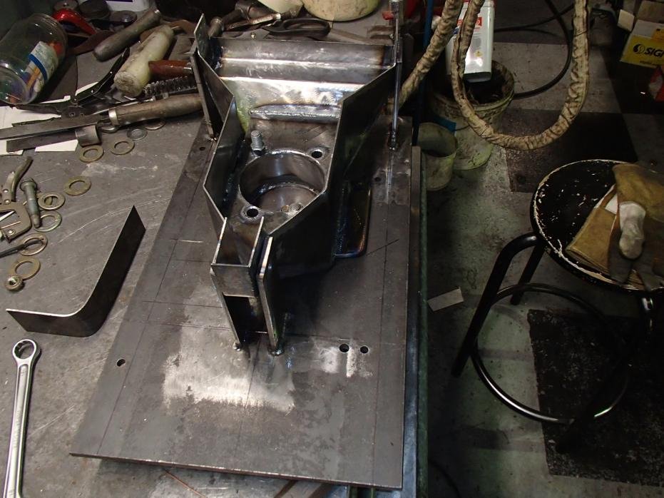

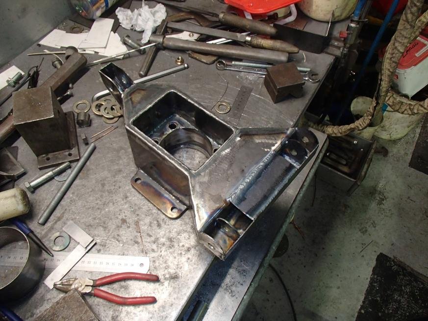

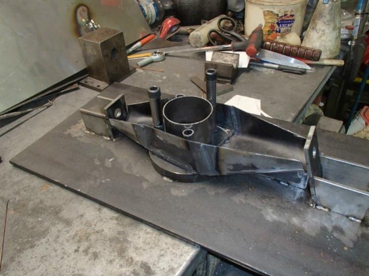

Rear upright, same it has a jig.
I make the panels by hand , I cut them on the band saw.
I dont think its worth laser cutting because you have to make minor adjustments as you go.
The floor is folded.
Crush tubes and center tube.
One side panel
The inner mid floor.
The other side panel
The center box
The back

Jim, is this Tig or Mig?
20 May 2015, 3:34pm
I would say it's TIG, I was about to ask something similar. To weld those external corners with MIG is very tricky, but in my experience internal corners with TIG are tricky too, I was wondering if Jim is planing the welding around the external corners.
Jim, do you use TIG for the internal corners, the temporary jig welds look like MIG, although it's hard to tell at the distance.
It's fascinating project, I tend to cut the metal with a thin, 1mm x 125mm grinder, I find it pretty accurate and fast. The only difficulty is narrow slot ends but I usually manage one way or another. Looking very good, well done.
20 May 2015, 9:18pm
Its all tig.
Tig is way stronger than mig,mig joins by adding material ,tig melts the 2 parent metals together.
With the internal corners you pull the electrode out further and run a little more gas if required.
I can run very short end caps on my tig handle its also water cooled so the handle is half the size of an air cooled handle, so I can run short electrodes to get into tight places'.
I also have another torch that looks like a big pen, it has a swearler in the end for the gas and you can run the electrode out up to 20 mm
The externals is just about running the right amount of amps so you don't under cut.
I use a few more amps than I normally would to get full pen.
If you go to hard the steel bubbles, it must have a higher carbon content or something.
Some welds I just dance over with a sander but I dont grind them back for strength reasons.
Ed I use a band saw to cut the sheets.
Its in pic one.
It is a wood working saw but with bimetal blades it works fine even if a little fast.

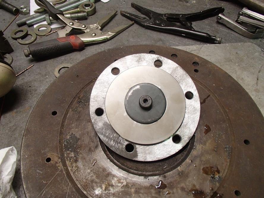

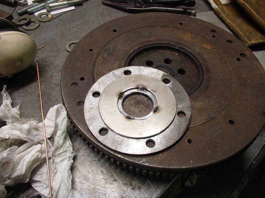

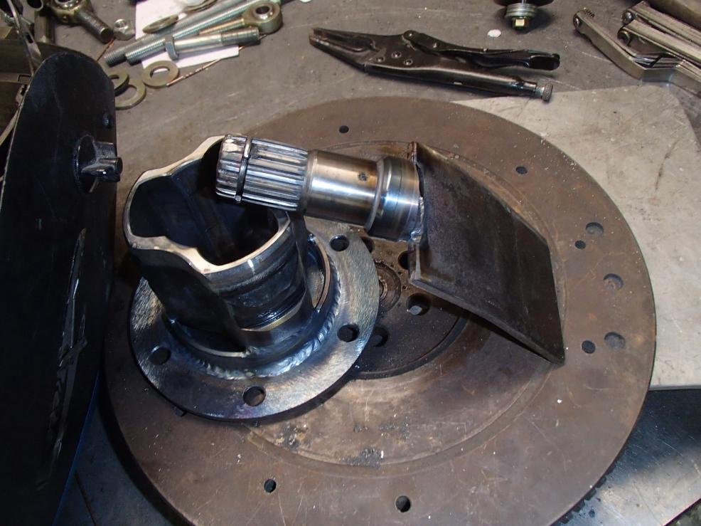

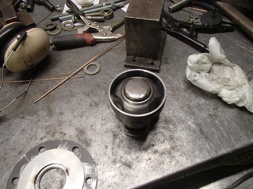

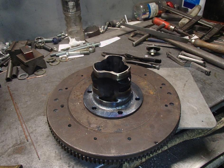

Today I built the inner CV joints.
I have 2010 corolla drive shafts as they fit the wheel hubs.
My aim with all this stuff is to keep the match up as simple as possible.
I was not sure about how to marry up to the 01E audi box as the corolla has a splined shaft on its CV to go into their gearbox.
The other day I was working on a mid 2000 VW golf and I noticed the inner CV and flange was separate, somehow it was jointed I am presuming welded.

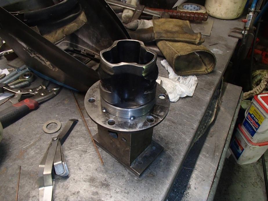

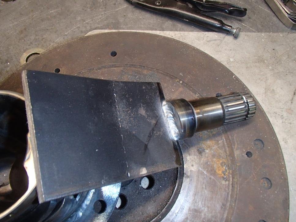

I went to the steel supplier and grabbed 4 bollard caps.
First thing was to make the base , I used a 50 cap to centre the SS cap that I have machined to a ring.
Once centered I clamped the SS ring and removed the 50.
I weld the SS ring on the inside, this becomes the locator on the 01E flanges.
I chopped the shaft of the end of the toyota CV, this leaves a 40mm dia spigot.
I then machined the center of the large disk to 40mm.
I machined a ring out of some steam pipe ,this fits between the main disk and the CV.
I tacked everything then put it in the lathe to check it then welded.
30 May 2015, 11:30am
The ring is welded to the base of the tripod joint and around the ring base.
It has a total of 550mm of weld.
I did some destruction testing prior to see if the CV material is not to brittle.
I hit it with a large hammer and also in the press, it survived.
Jim
