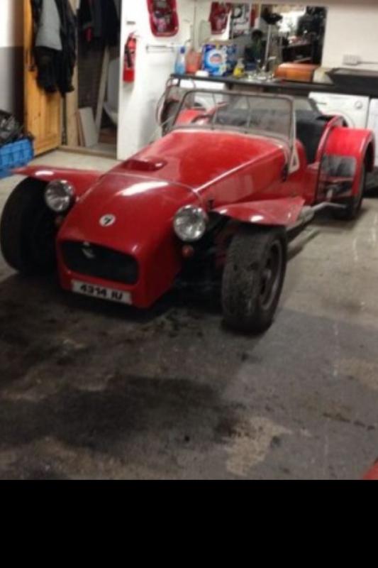

Hi, i came across a 7 replica a week ago, bought it and got it running.

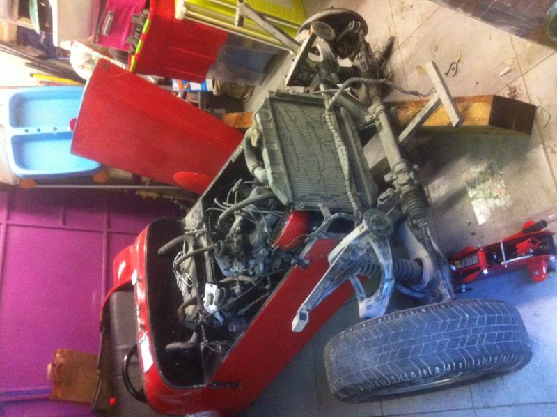

Removed wings, nose etc to check out sticky calipers.
Front suspension seems like overload and looks heavy , prob escort.
After searching for a similiar set up, i couldnt find one. Most have adjustable tubular arms etc.
Has anyone seen this set up before?
Placed pic in my album, hoping this link works
Thanks

Hi Mitch, welcome to the forum.
I have taken the liberty of spinning the car upright, make it easier to view without getting a crick in my neck!
I can't identify the car but that front suspension looks very much like Ford Cortina Mk 3-4-5 also the rack. The tie rods are from the back and coilovers have been used but otherwise I am sure the top and bottom links are Cortina. Therefore the uprights and hubs will also be Cortina.
Is there a V5? If so what does that say?
The Cortina suspension was a very common fitment in that era.

Looks like a Locust to me. Think it is known as a TJ or TG Locust.
Easy to tell as it has a ladder frame type chassis and plywood body tub with aluminium skin. Ford Cortina front suspension , Escort live axle I think and Ford XFlow normally fitted. What does the V5 say ??

No follow up? No V5? It does look like a locust, but on mine I couldn't get the radiator in there. The engine looks lower in the body .

its definately a locUst.
ladder frame chassis with cortina-subframe welded or screwed in place, plywood body skinned with aluminium
not the best desgin, especially with this front suspension.
also not really valuable.
looks like a x/flow engine. watching closer i can see a single-barrel carburetor: indicates a very low pwered 1300cc or even "only" a 1100cc engine...both not worth more than 50 quid.
i would not invest any money in such a car....any scruffy mot-ed westfield, for 3k, is doing everything better...if you are lucky you will find an oldschool sylva striker (live-axle, x/flow powered) in very-nice condition already for 3.5k

Rochdale GT. You miss the point, he has bought it. The front uses Cortina components . They are fastened to chassis fittings ,not to a Cortina sub frame. The engine may well be a 1300cc . I built a T&J Locust 20 years ago it is a fun car which will give many years pleasure . It is not nice to run down someone else's car especially from a position of ignorance. Adjustable wishbones are available and the steering rack is probably Mk1/2 Escort with spacers for the wider track. Mitch Dublin if you haven't yet done it look up the locust owners club. You have probably found how much fun you can have, pay no attention to jealous people. good luck. Dave

yes, you are right..its NOT a cortina subframe. a locust uses the cortina wishbones screwed to the chassis. even lots of people are talking about "normal wishbones are available", but why the majority of locust“s dont use them, even its clear that the cortina suspension parts do not work well on a lighter kitcar?
