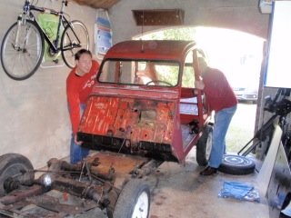

31 Aug 2013, 9:39pm

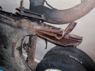

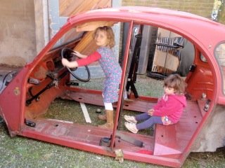

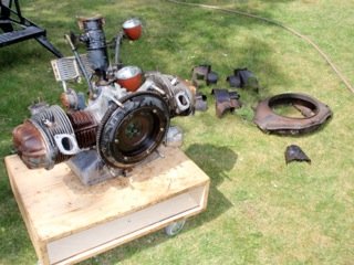

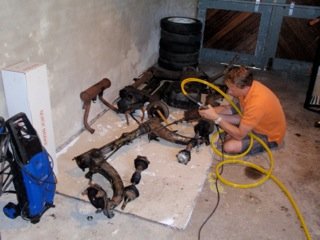

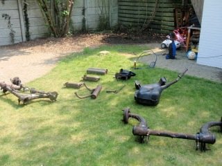

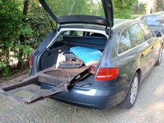

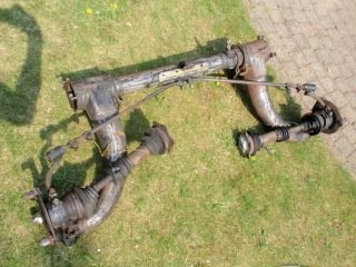

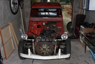

teardown of 2cv
So these are the parts which were useable..
Now cleaning up engine, taking rust of all parts, replace seals, bearings etc and repaint again..
Had to use a hydraulic wrench (700 bar)from work to loosen nuts of the drive shafts...They easily came loose....
Days of cleaning and realizing not a great deal was re-usable..

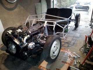

Start with new chassis & rebuilt engine
Now the easy part began - built up the chassis - I was still smiling...

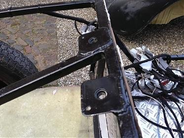

31 Aug 2013, 9:49pm
Start with putting one frame
Attachment “Image.jpg” from the original forum could not be reliably recovered.
Attachment “Image 3.jpg” from the original forum could not be reliably recovered.

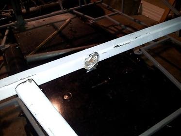

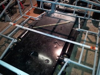

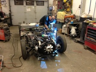

Problems with rear crossmember - have to cut it and move 5 cm back, also pedal box does not fit.. However, the mounting positions are very good and the frame is very straight!

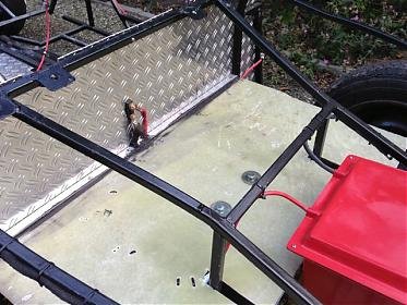

31 Aug 2013, 9:59pm

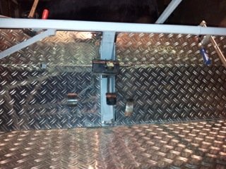

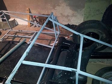

Continue with frame / floor
Nice thing about front wheel drive is that you do not have to worry about making a tunnel for the drive shaft and there is more room inside. Also the seats will be mounted in line with the humps.. Challenge is to find seats that are not higher as 47cm...
I used alu checkered plate for the floor, head and rear board and it gives a very sturdy feel to it, can easily stand on the floor without flexing it.

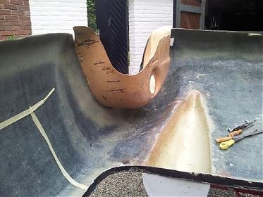

31 Aug 2013, 10:35pm

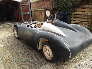

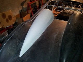

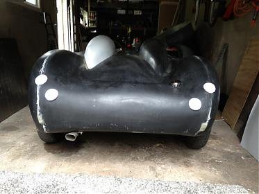

Body modifications - fenders, hump
Now that the body fits, its time to add the extra hump I got from Gary. I had no experience whatsoever with glassing, but it worked out okay - still a messy job and itchy arms afterwards..

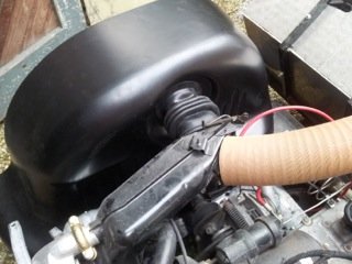

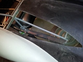

I had been thinking about the inner mudguards/fenders and found some plastic fenders from a citroen Mehari.
They fit both on front and rear, and are super light. I'm sure for the rear ones it could be a good solution for the Herald builders as well. I have now mounted them with some bolts to the sammio but will use them as a cast and glass them. Then I will take the plastic ones out and then I should have some nice glassfiber fenders which I can easily attach to the (glassfiber) floor of the rear. It will make the body very stiff I think.
Starting to look like something...
31 Aug 2013, 10:40pm

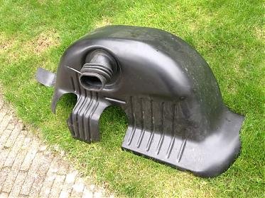

Good inner fender / mudguard
Here;s a good picture of the mehari inner fender. I have two old ones at the rear and bought two new ones for the front..
I still have to figure out how to fix them at the front as it is a bit "wobbly" and the bonnet has to fit neatly over them

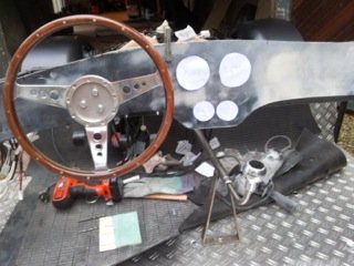

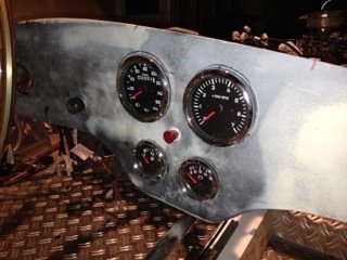

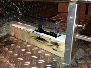

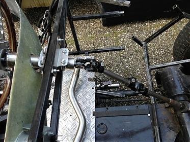

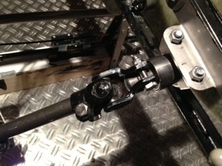

Steering, gearshift and dash
I had to make a new steering column, which had to be firmly fixed to the frame and figure a good gear shift system. I used the parts from Burton car company and they came out really nice and sturdy. I have no really good pic of gearshift system it but will post it in the future.
Also found a good solution to the handbrake - on the floor in gearshift system. With 2cv the handbrake works on front wheels. Was also able to fitt the choke control in there (chrome knob)
Also adjusted the Dash and pre-fitted the instruments
things are moving slowly with all this re-engineering / re-inventing...

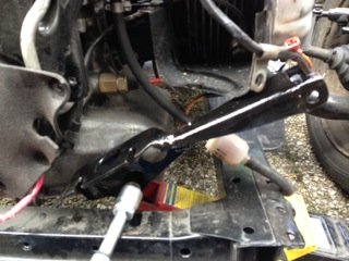

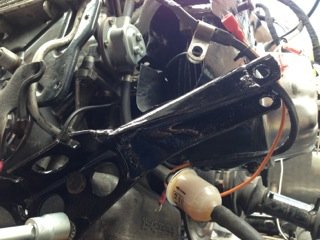

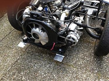

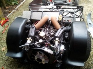

Engine modifications

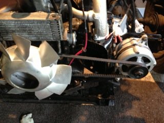

One issue with the 2cv is the height of air filter, alternator and oil filler/breather unit. I had to reposition the location of the altenator which wash't a simple operation but came out good.
I wanted to avoid the bubble in the bonnet like this one has..
and welded a bracket to the engine support
On the last pic you can see the original place of altenator and oil filler.. Hob bout that HUGE air filter.....

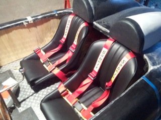

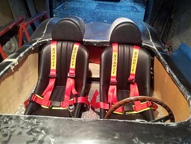

Seats & belts
I have looked every where to find low back seats. The 2cv does not have lowered floor pans - not possible as it has a straight ladder chassis - and therefore the seating position is higher. Subsequently the seats will interfere with the head rest on the humps. So the key is to find seat that are very low but still offer some comfort. You do not want to tower out above the windscreen..
In the end I called Intatrim in the UK and asked if they could supply their Apollo model seat with a lower rear height. It cost 20 pound extra I believe but they fitted perfectly when they arrived. The only thing is that the seats are really narrow while I would have had space for a wider model. Its still OK, but if your bottom is a bit wide its not that comfortable. I could either widen the seat or lose some weight (and thats what I did...) Now they sit excellent!
Also bought the Sabelt seat belts - I did have to have to weld some mounting brackets.

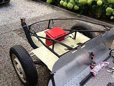

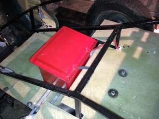

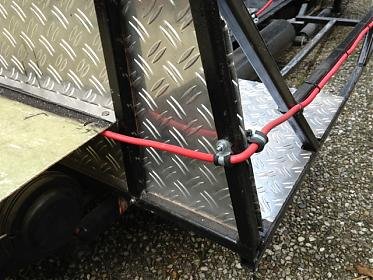

Battery and electrics
Initially I wanted to mount the battery at the front, under the bonnet, but space is limited there and I really liked the battery box solution I saw on the net. Also it improves weight distribution front-rear a bit and gives the battery a lower center of gravity.
Also had to make a main power safety switch - fits exactly between the seats.

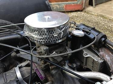

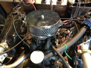

Engine / exhaust modifications
As earlier mentioned, the original 2cv engine has a HUGE air filter. After some surfing, I found this open air filter which - after some "Dremel" modifications -fitted. It will stick out through the bonnet, so I need to make a good "scoop" for it.
Made a start with the bonnet hinges as well..
Attachment “IMG_0250.jpg” from the original forum could not be reliably recovered.
Also had to cut and re-weld the exhaust as it was touching the wheel in full lock position.

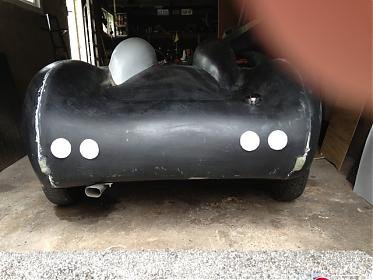

31 Aug 2013, 11:48pm

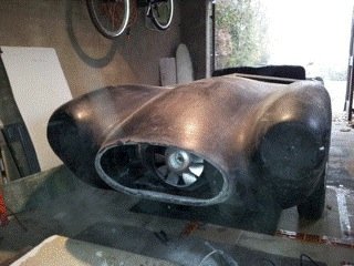

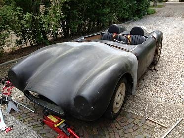

Front body modifications

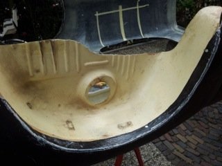

After test fitting the body again in combination with the bonnet, I found it to be really asymmetrical and found the left front to be 4cm longer as the right. How is this possible????? I hope this is fixed for new body shells..
Anyway, I cut the piece out, but it needs to be done very carefully.....
Also looking at some positions for the rear lights. I think that 2 side by side still looks the best

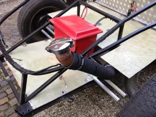

fuel filler cap
Another challenge is to find a solution for the filler cap. Could not use the citroen system. Found a nice flexible filler hose and copper elbow - all fits nice and snug and the chome cap is the finishing touch

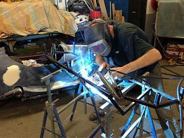

1 Sep 2013, 12:11am
Major decision..
Okay - I was going along just fine, ready for final mounting of the body and before doing so I re-checked my seating position carefully and found it to be very uncomfy.... My pedals were just too close and my knees were touching the Dash almost. Not smart to leave t that way...
I looked for a solution and noticed the frame could still move forward about 4-5 cm to the front. At the same time I could also move the pedal box a bit (3 cm) to the front and gain in total about 8cm which make a big difference. You can lose weight, but not height...
I decided to dismantle the whole dash, electrics, panels etc and then cut the 10 linking bars on the frame. The whole front was loose now - ouch! - then repositioned all and weld it again. Set me back some weeks as frame need painting again and new floor and headboard panels need to be made.
Good thing is that the seating position greatly improved with this operation...
