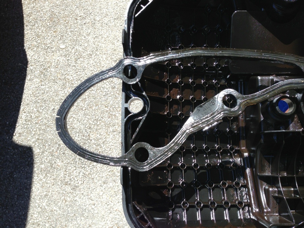

My rocker gasket has gone hard and started to crumble so changing it was a good idea:

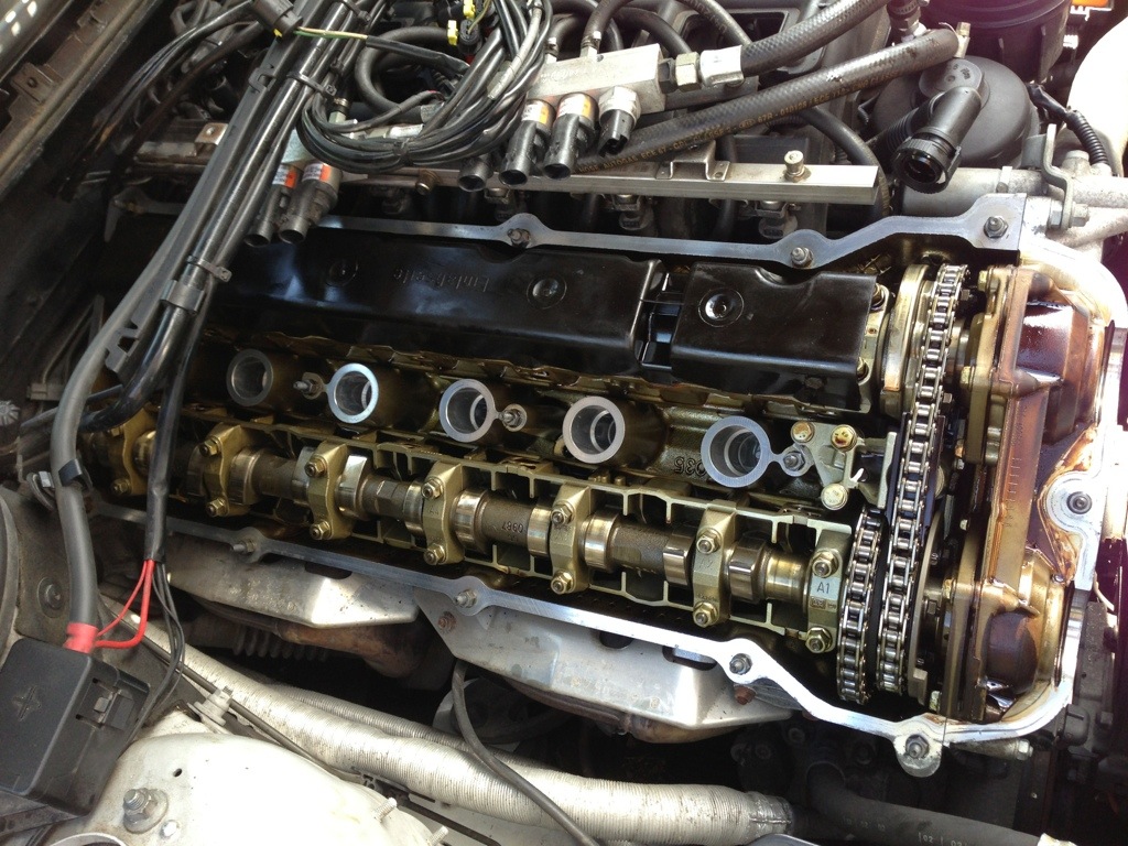

Here's the VANOS unit right in front of the cams:

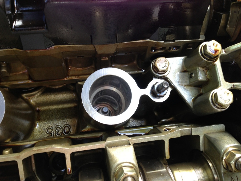

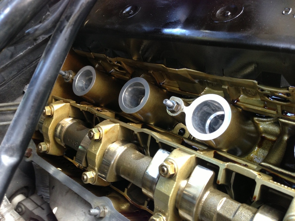

A view down the cylinder 1 spark plug hole - the gasket here was so solid it shattered while removing so you need to be fairly careful bits don't go where they shouldn't.
Cam still looks very good, like new almost

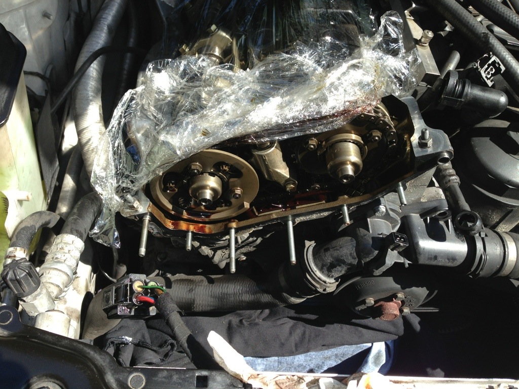

VANOS unit removed from front of engine, everything covered up to avoid dirt getting in there

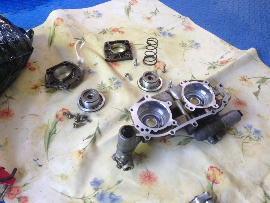

The VANOS unit disassembled

The seals are one the two pistons in the photo and consist of an inner o-ring and outer teflon ring. You need to carefully cut the old ones off, soak the new ones in warm water and fit. The telfon outer rings deform when you put them on so I used a tiny screw driver to run all the way round them and straighten them out.
