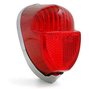

Anyone looked at the rear lights on a nisan figaro? One light for the indicator. One unit for the rear light, brake and reflector.
29 May 2012, 1:06pm
Weren't sure if they looked to big? You'd need to hold one close to car?

figaro lights are quite big for a sammio I guess but maybe a G46 could take them
29 May 2012, 1:58pm
I wonder if you can buy the housings separate to the lens? as they look diferent to each other. The top one looks more suitable as its curved. Could you turn it so that the curve is sideways instead.
