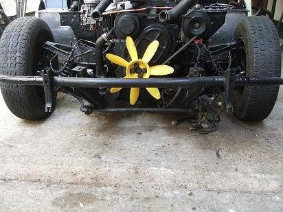

As the crank driven fan was damaged on my donor engine I replaced it with a 16" electric fan, but I had to raise the radiator 30mm for the motor to clear between the crank pully and water pump pully. Then Gary tells me I need to lower the rad by 65mm to clear the bonnet...
:jaw:
In typical Sammio style I'll be addressing this problem as and when I get to that part of the build: I've had a couple of ideas but I reckon I'll be able to make up some Z brackets to move the radiator backwards and downwards while leaving space on the front of the rad for the big electric fan. As I'll probably have to grind some of the chassis away for clearance I'm going to wait until after reclassification to avoid iva. If that doesn't work I might just fit two smaller fans or one medium sized one.
BTW, if you go down the electric fan route, don't go spending a fortune on brand name parts, the 16" curved blade one I got new from ebay was £28 and is really good quality, while the thermostat controller was under £20.
Once I get some free time (School holidays end next week!) I'll start my own build thread and post some pics.

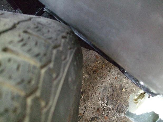

Hi Dave I find that when the wheels are on full lock the rim of the tyre is very close to the front edge of the bulkhead,I have got maybe about 20mm but this dosn't seem like alot considering the tyres have very little tread.I was hopeing to put 14inch wheels on but they wouldn't stand a chance of fitting without serious bulkhead mods.
I think your right with the ply I'll just crack on with it,I am waiting for a roll hoop from Gary before I can fit the back panel as it will be much easier to fix in place rather than trying to work through the wheel arches.
Hopefully these Pics have loaded.

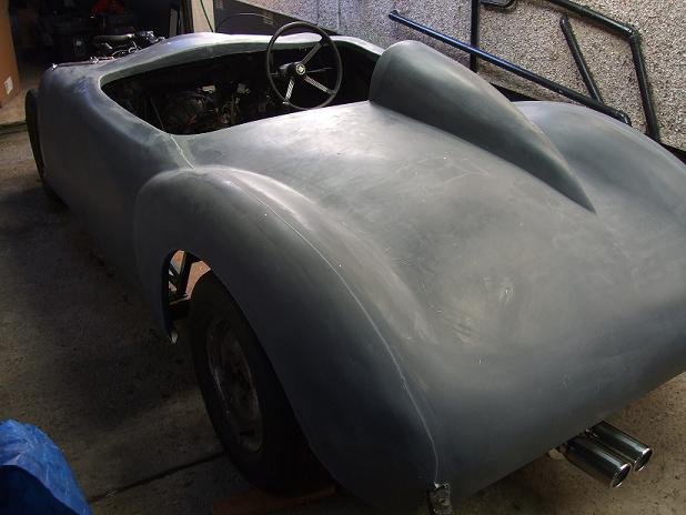

Hoop arrived
Thought I would post a Pic of my Hoop It's brilliant to get this as I can now finish off my woodwork and fibreglassing. Thank You Gary
26 Sep 2011, 8:56pm
There will be a lot of cars ready for the summer!
Looking good JW, filling looks neat.:frog:
