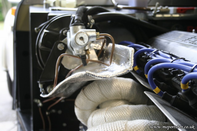

1 May 2009, 7:34pm
With regards to Mr. SVA man, yeah they will have a problem with hot exhaust near brake pipes or master cylinder. I had to put some extra heat matting in around mine in addition to the ali heat shield I already had there :)
