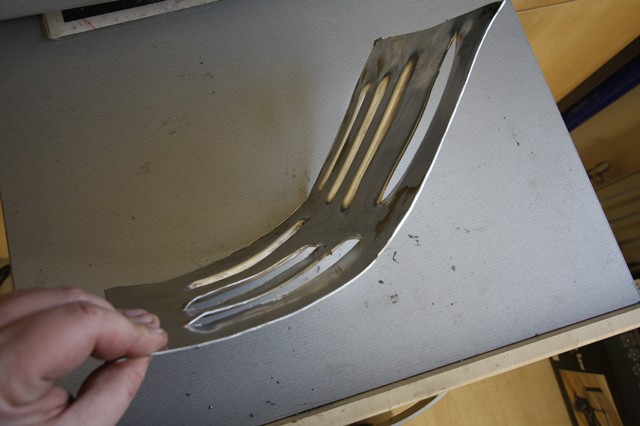

The ITB projects a bit quiet right now as we're trying to get the car ready for paint. Part of the this is a set of louvres - for obvious reasons I can't go back to the source to get these done, and I'm after something a bit different anyway!
I've probably spent 16+ hours on the lathe with these, the curves were right headache!
Test results so far are OK, but not perfect. The thing I'm have the biggest problem with is getting a nice start and finish. I think I'm going to have to make up a wooden die I can use to hammer a nice finish to the start and ends.

The chaps at http://www.metalmeet.com/forum/ have said that I'm never going to get the start and end nice with a die roller and have suggested I make hardwood die and stamp for finishing it off

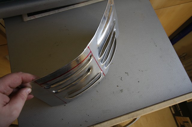

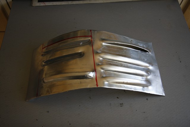

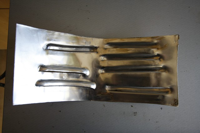

Here are some of the test pieces, not overly happy with these yet:

I didn't really want to use an insert.
To be honest if I don't get better results tomorrow I'm going to admit defeat and just get some stamped in the flat parts of the bonnet :)

After another day of mucking about I've decided if I'm going to spend the next 20 years owning the car I'm going to be pissed every time I look at a poor quality louvre, so I'm going to have them done professionally on the top flat surface! This one's beat me but the bead roller is still useful and I can always use the machine on any hidden area's that need ventilation!
