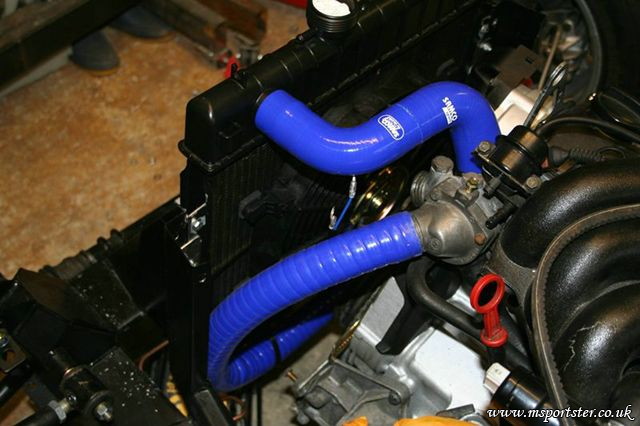

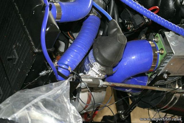

Here's my top hose:
This is the other side, instead of using the metal pipe on the front of the M20 I used a single flex pipe from the thermostat down the engine bay to the bottom connection (this has a 180 degrees pipe on it to connect it to the rad:
The connector in the middle of the top pipe (with the return pipe to the header tank) I had made by car builder solutions.
The 180 degree connection:
This is an early pic:
I've not got photos of the engine bay with the pipe in place, but here's a photo with the pipes off:

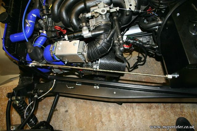

I took the same route as Robin, trying to use standard hoses since those silicon ones work out at a lot of money. If you don't have the metal 'hose' that goes across the front of the engine, you might get one from a breakers yard or maybe on eBay.
You can see it here....
http://flickr.com/photo_zoom.gne?id=154944361&context=set-72157594447011861&size=o

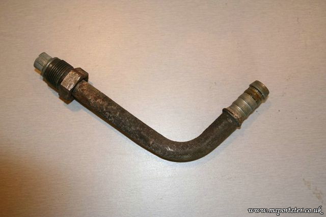

The only problem with getting a metal hose is that there are no mounting points for it on the timing case:
As you can see, my water pump has two hose inlets as well. I'm thinking that I'm going to have to change the pump to the newer style, and then sort out an inlet for the header much like you guys have done (I quite like Peter's solution - mainly for the ease of ordering! :)). Then I'll get standard BMW hoses for the rest, except for the a long flexible pipe ala Patrick to the lower rad point.
Don't think I'll splash out on silicon for that though - CBS have similar hose but in good ole fasioned black rubber. :)

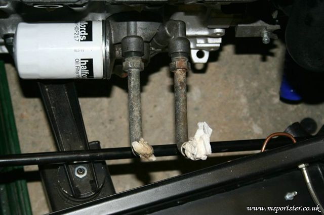

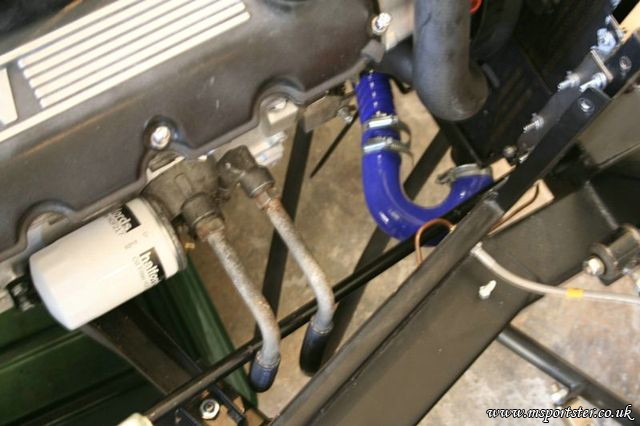

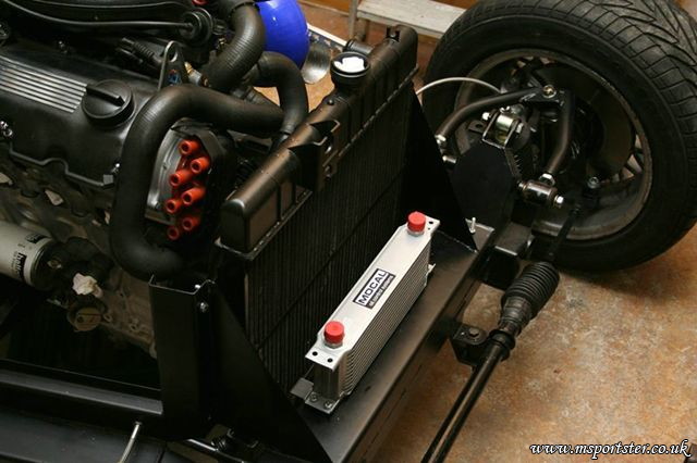

I had a productive weekend - I installed the oil cooler and the new pump.
Had a bit of a moment with the oil lines, as it looked as if the 5/8 hose was too big for the metal pipes from the oil cooler, but the double hose clamps has tightened it up around the metal nicely - no leaks, even after spining the oil pump with a drill to get the oil through the system.
