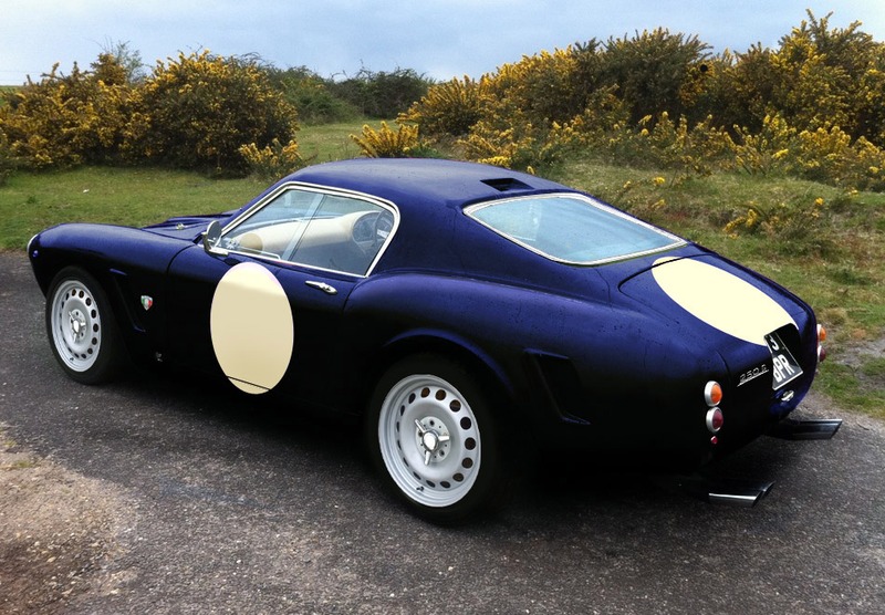

Hi Egdik,
The towers will be fixed by 5 small studs welded in the small holes originally in the wheels which line up with the 5 small holes I have drilled in the towers, these will have acorn nuts fitted.
The larger holes in the towers are there already but I have opened them out so they do not touch the fitting surface of the wheel nuts. I may put caps over the wheel nuts depending how it looks when finished.
Not quite sure what you are asking in the 3rd line but hopefully this answers it.-
The wheels are standard BMW 17" steels so locate properly on the lip of the suspension hub.
With the large holes in the tower opened up, they drop over the wheel nut mounting cones in the wheel and sit flat on the wheel face.
The exact fit of the mounting face of the tower against the surface of the wheel was then either through hours of careful planning or by good luck!

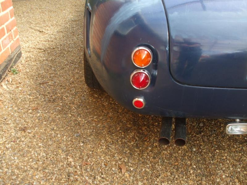

While the reflectors are fine as they are for now, I don't like them so spent a little while today making some new ones that will be fitted in with the rear light space, extended slightly, not decided how yet, I'll offer them up when the glue has dried.
They are odd bits of old car reflector cut down to fit in Jaguar window winder surrounds. As I sell auto jumble for a living I get to keep all sorts of bits that look like they could be useful one day.

If you look at the pictures on page 8 of when Chris first did the car, it's on standard height suspension and there's plenty of room in the arch (too much for my taste which is why I had the lower coil overs fitted)
Not sure what sizes are available in 17" but mine are going to be standard front size all round. The original wheels and tyres were larger on the back but changing them will only upset the speedo reading by less than 1%.

With Spinners
I like the style of the wheels but the tyres look too low profile. I'd go for 65 or 70 profile tyres for that period look.

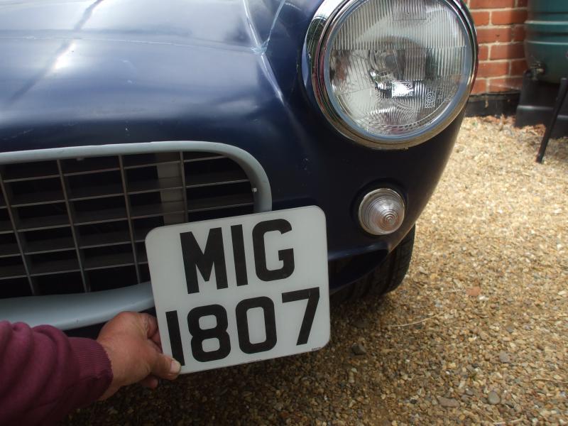

I've bought a square number plate to offset at the front and from reading the DVLA site (if I've got it right) I have to have 11mm of plate around the numbers so it's been cut down. I'm currently making some brackets.

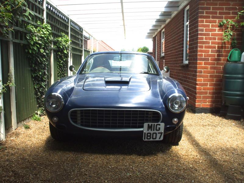

'Very Andy' kindly altered one of his photoshop pictures to my colours and wheels. Lovely job and very like my plan.
Got round to finishing the brackets and mounting the new numberplate today.
