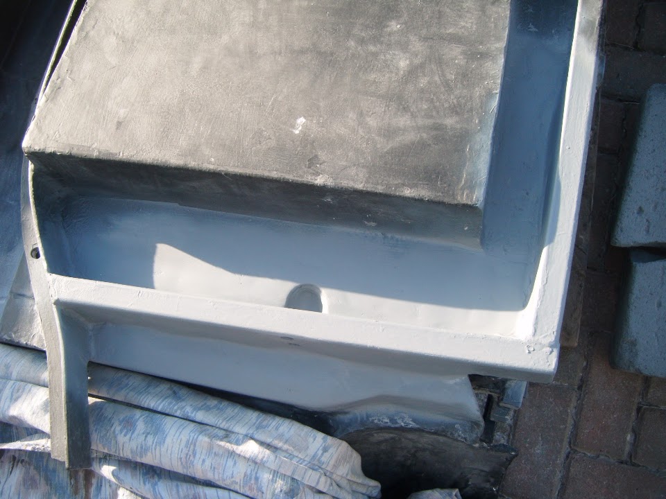

I used the original Cordite rear framework, but added a "hollow" to the floor for the arm bracket bolts.
And this is a recent photo showing the radius arm holding the hub in place.
With hindsight, clearly adjusting the radius arm would change the position of the wheel in the arch. :icon_sad:
What Next?
If I get the chance, I will add a skim of normal body filler to the bottom corner of the rear passenger arch.
As if the whole arch is actually in the wrong place, re-doing a small bit of filler work would be the least of my worries.
That might be a convenient point to down tools for Christmas and worry about everything else another day.

I added a layer of normal body filler to the bottom corner of the arch.
Then skimmed the return edge to help soften some of the current undulations.
Once that had set sufficiently, I sanded it all down.
Before giving it a dusting of etch primer.
Whilst the thought that the wheel position may change still haunts me, at least it looks good for now. :cool:
[Glass Half Full] Plus my plywood template technique worked well too. [/Stiff Upper Lip]
