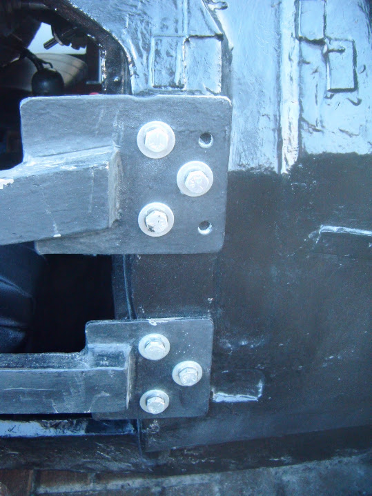

20 Oct 2015, 2:23pm
My plan is to build a continuous tub (no views of the road beneath!) with sides that are 2/3 or the full height of the body, and then sit the strengthened body on this.
Imagine your floor pan (which is very smart) with sides and you will have a rough idea.

I then used it to "entomb" the bolts holding the framework to the bulkhead.
( As once the body shell is bonded into position, these two sections will never be separated again. )
The bonding paste turns from a bright blue to a light brown very quickly, which makes me nervous.
But, thankfully, it can still be "shaped" when it is this colour, so it doesn't set as soon as the colour changes.
I used just under 150ml for this little job, so I will need to mix up a HUGE amount when the time comes to bond the body shell on. :eek:
