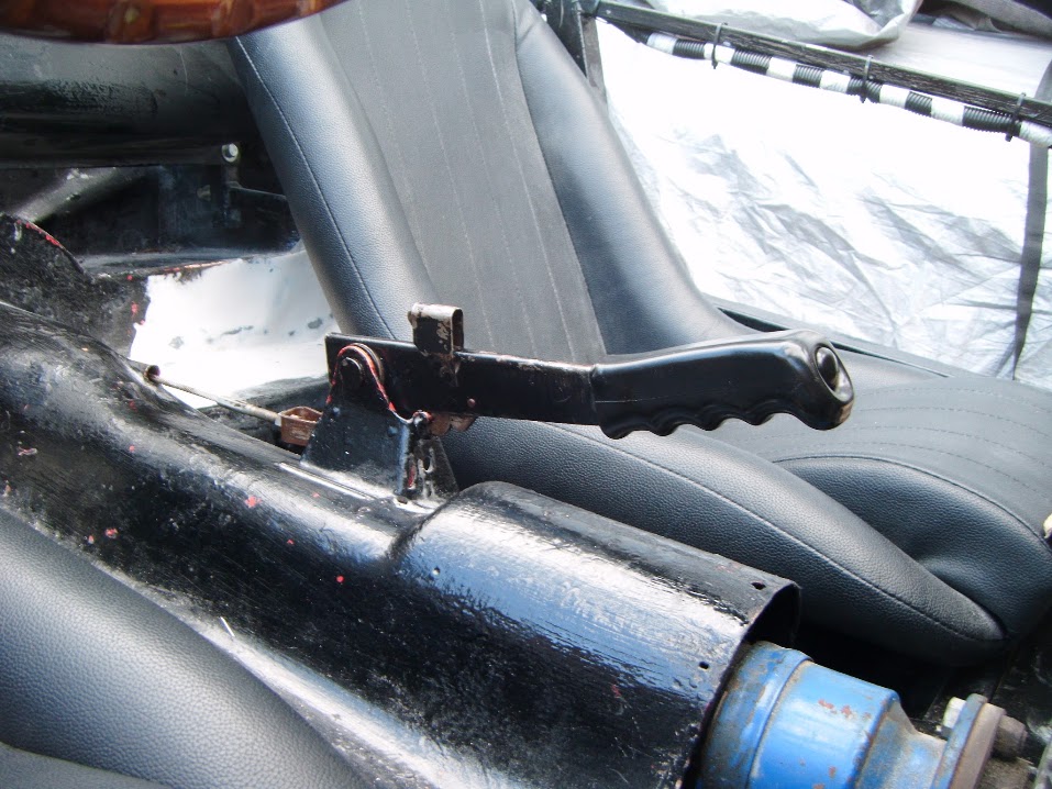

Got the hand brake refitted, but not properly adjusted yet.
This was a bit of a pain to do when I dropped it and the spring loaded button popped out. :rolleyes:
But eventually I managed to get all the various bits to line up and it does operate the way it should.
