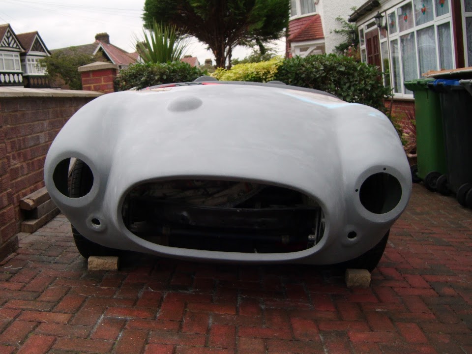

The angle is easier on the eye then the step and doesn't interfere with the cars lions as much
29 Aug 2015, 12:11pm
Roadster, Rene & RedRatBike - Thanks for all the feedback, comments & suggestions, I really appreciate it. :cool:
The step in the bonnet opening is linked to me trying to fix more than one problem at the same time.
Originally, the Cordite body shell was supplied with an integrated bulkhead.
I cut this fibreglass bulkhead out completely as part of my decision to use a Spitfire bulkhead instead.
However, this means there is currently nothing to tie in the sides of the body shell with the bulkhead.
So the horizontal cut is there to allow me to tie the sides of the body shell to the "shelf" in the bulkhead.
The next part of the puzzle is transferring part of the bonnet to an extension of the body shell.
Mac actually built his extension out of alloy and then firmly fixed it into position like this.
Whereas if I follow the sketch for the line from the bulkhead shelf to the wheel arch...
Then I will only need to support the extension for an inch or so beyond the vertical face of the Spitfire bulkhead.
Therefore there should be no flex in the front sides of the body shell.
So I guess that is a very long winded way of saying the design of the bonnet has more to do with the body shell, than the bonnet itself.
However, by the time I actually get this built, the cut angles in the sketch will be replaced with some gentle curves.
A bit like the cuts through the outside edges of the aero humps.
I really hope this makes sense and that the finished design doesn't look too bad.

As hindsight was not available at the time, here is the current sorry state of the 'sunny side' of the passenger corner.
I actually couldn't face taking a photo of this yesterday as it was such a mess.
But given all the horrors of this build so far, what is another maimed section of fibreglass between friends? :icon_wink:
The first job was to grind away all the joins, high spots and the rough bits of fibreglass stuffed in the gaps.
( Which is just a temporary way of getting a better join on the other side. )
I also counter sunk the screw holes.
Then I added the first two thin layers of fibreglass matting into the joins.
I also added a patch to the centre of the bonnet, where I had ground out an air bubble earlier.
Once this was set, I then ground away the fibreglass matting I had added to the outside of the wheel arch to fit shape.
This allowed me to clean out the slits and apply fibreglass filler to these gaps and to the screw holes.
When this was set enough, I was able to sand the filler down to leave me with the basic contours.
If you follow Ed's (A Big Scary Monster) advice from the other day and squint, you can just about see the final shape developing.
( Well, at least on the passenger side. )
I then added a 3rd layer of matting along the joins.
But no sooner had I taken the photo, when I felt a drop of rain.
So I added some blocks to the bonnet to keep the covers from touching the fibreglass.
As it happens, I had too many other things to do today, so that was a handy place to stop.

Jones - Hi Ian, sorry if my rambling posts haven't made the basic plan clear, but your reply sums the general ideal.
As I started with a gap between two separate fibreglass sections.
Then bridged that gap by using fibreglass matting on the underside, covering a large area either side of the join in overlapping layers.
Whilst this creates a pretty solid section on one side, the original gap is a potential weakness on the sunny side.
Rather than just use filler, I ground this out on either side and then added more matting wider that the original gap to add back strength across the join.
At this point, the bonnet has effectively become a single unit with no "fault line", just needing some filler to hide any evidence of the "surgery".
However, in this case, the bonnet will get some extra work, just to be on the safe side, given that it can be left in the (less supported) open position.
So I will be add some fibreglass bracing across the full width of the underside so that it holds its shape better, reducing any natural flex.
Also, once the body shell is bonded to the internal framework, I will add a extra layer of matting along the rear bonnet edge.
But whether this matting is on the sunny side, underside, or a mixture of both, depends on how well the scuttle & bonnet actually lines up.
Then the final body work shaping can take place until the body shell & bonnet look like they form part of the same car.
Overall, I am really pleased with how this is coming along, as I had no idea if I could actually pulls this off when I started. :cool:
I guess my frustration with the passenger corner is linked to all the recent rain delays. :icon_sad:
But the simple fact is I couldn't think of a better way of doing this, so even though it is slow progress, at least it is still progress.

That Friday Feeling - Part 1:
First job of the day was to check the fibreglass work I had left setting under the tarpaulin had cured properly.
Thankfully it had. :cool:
A quick trim off the edges left it looking like this.
Currently, the passenger corner is still a bit "bumpy".
However, this was Swifty's "standard" join, before he started to even the differences out.
The scuttle tapers in more on the passenger side, compared to the driver's.
So part of my plan is to build up the scuttle at the same time as I try to blend in the bonnet.
Then it was time to start fixing the driver's side.
After trimming a bit off the bonnet and a bit off the new edge, I had this.
Note:
The angle of the photo makes the gap look a lot bigger than it actually is.
Part of the reason that this corner is not as bad as the passenger side, it that this side was completely cut off and rejoined a while back.
So the area of the original cut & shut work has left this extra gap here.
After cutting a couple of slits, I could fix this section into position.
It was a similar story at the outer edge.
So the first fibre glassing session fixed the two edges of this section in place.
When that was set, I could then have a look at the remaining gap.
I cut some slits and increased the gaps at some ends to help me bend it to the right shape.
An assortment of brackets held it all together.
Before the second fibreglass session of the day bridged the gaps on the underside.
At this point I was buzzed by a Police helicopter. :eek:
You can also see the clouds overhead, which seemed to come and go and constantly threaten rain.
End of Part 1...

Part 2:
I didn't add any matting to the sunny side of the arch this time, so I will leave all the brackets in place over night, while it all cures.
Then I can remove all the screws in the morning and finish off 'glassing the underside.
However, I did wait until the matting was set hard, before I lowered the bonnet and took these photos.
( After putting a tek screw in to hold the bottom edge of the bonnet to the body shell. )
It should be possible to get a nice transition from the body shell to the bonnet at the side.
Similarly, once the filler work is done, this whole corner section should look a lot better too.
Unfortunately, the sloping driveway makes an "across the bonnet" photo a little harder to line up.
But is is currently something like this, which should improve after some sanding / filling.
Roadster made a valid point about how far out the body work of real 1950s racing cars could be.
This is good news, as it means my overall bonnet design will be in keeping with the period. :icon_wink:
Jokes aside, I had no idea what I was doing when I started chopping the body shell in half and removing the scuttle completely. :eek:
But through luck, rather than judgement, I have ended up with a completely unique car, that I think will really look the part. :cool:
( Especially when the front arches are pulled in a bit. )
I'm definitely over the worst of this build now, so if I can keep plugging away, it should just keep getting better.

Yesterday I took a lot of positives from how quickly the driver's side corner progressed, compared to the rain delayed passenger side.
This fix was helped by simply accepting that the profiles of both bonnet corners will not be identical and it really don't matter.
( Especially given all my other symmetry issues I have to live with. )
Also seeing the bonnet close properly by itself (give or take a bit) was actually a significant milestone after all these years. :cool:
As when I first test fitted the kit, the Spitfire bonnet brackets prevented the Cordite bonnet from reaching the body shell.
When the Spitfire brackets were finally removed & my home made hinges fitted, the rear edge of the bonnet came up short. :rolleyes:
Mind you, at that stage, that was a minor problem compared to the fact the driver's side wing was missing! :eek:
Looking back, I have clearly made great progress in a lot of areas, not just the bonnet, which is a good thing.
But the source of my frustration is the simple fact that most of this work should not have been required in the first place.

Every Little Helps:
Not much car time available today, but at least I was able to inch along a bit further...
Removed all the screws and various brackets.
Note:
After cutting the slits to get a much tighter shape, I didn't squash the arch that much in the end. :rolleyes:
Cleaned up the underside around where the screws had been.
Added some more fibreglass matting across the screw holes & the join.
When that was set, I ground out the join on the sunny side.
( As I wanted to strengthen the main join on this side before I started tackling the shaping of the wheel arch etc. )
Then covered the join in 3 layers of matting, increasing the width of each layer.
So not much, but better than nothing.
