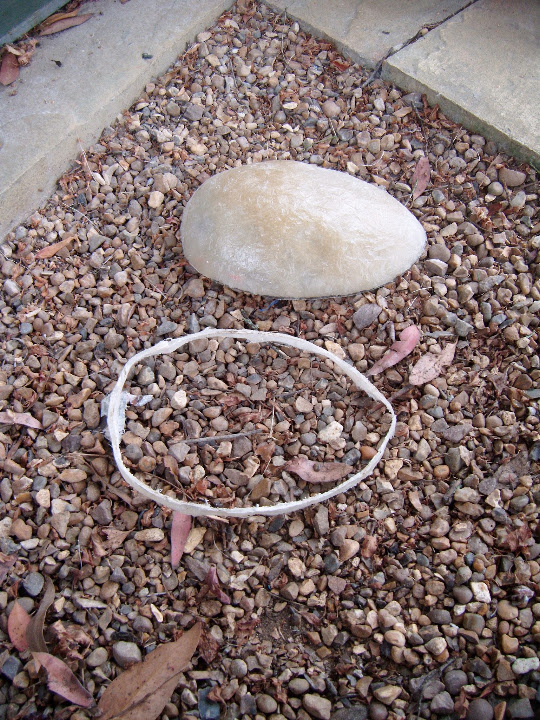

I wrapped the mould in some cling film, a trick I'd seen Swifty & others do.
I them proceeded to make a complete pig's ear of putting some matting on. :rolleyes:
But after a particularly messy session, at least I finally had a decent starting point.
I then left that to set while I got on with other stuff.
When that had set hard enough I gave a rough trim to the bottom edge to make it easier to remove from the mould.
Then I marked the bottom edge of the bulge on both the mould and then the fibreglass before the next round of trimming.

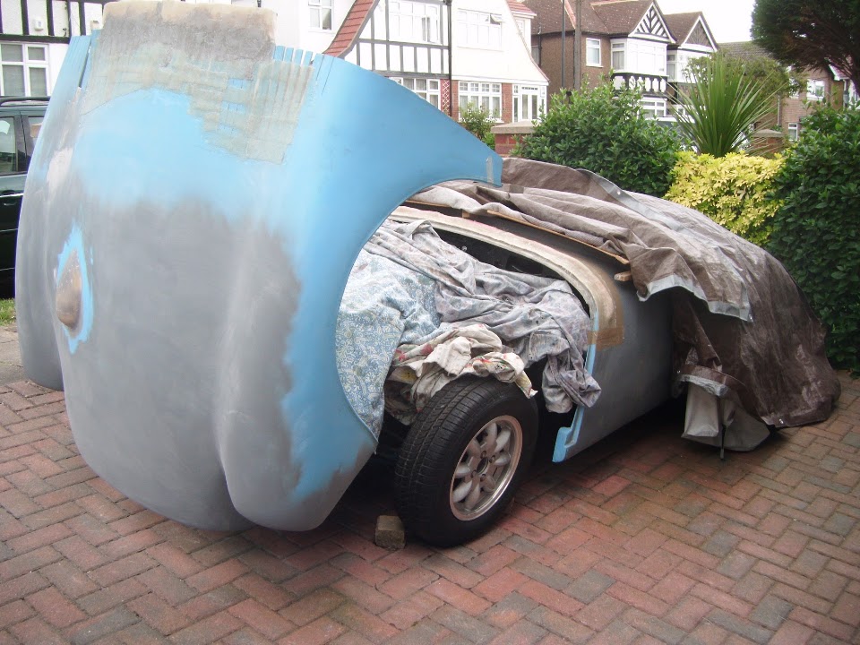

Friday - Part 1:
Bit of a stop/start/do other chores type of day, so the following updates are not in a strict time order.

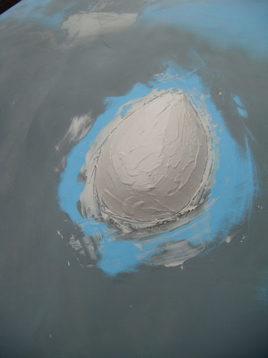

Bonnet Bulge
A layer of normal body filler was added.
Then sanded down.
A coat of etch primer made a big difference. :cool:
So here is what it looks like now.
In an ideal world, the new radiator would have fitted without the need for any extra work.
Having said that, I am really pleased with how well this new addition has blended in.

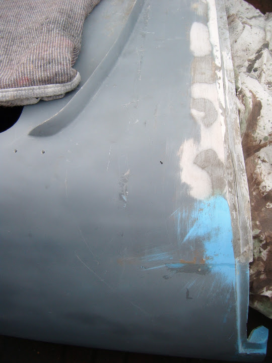

Bonnet Wounds:
I ended up mixing too much filler for the bonnet bulge, so spread the "left overs" on the inside of the bonnet to avoid waste.
Note:
I have no intention of creating a smooth surface, I just want to "soften" the evidence of where the cutting & shutting took place.
So a very rough sand down left me with this.
But this is something I can come back to another day.

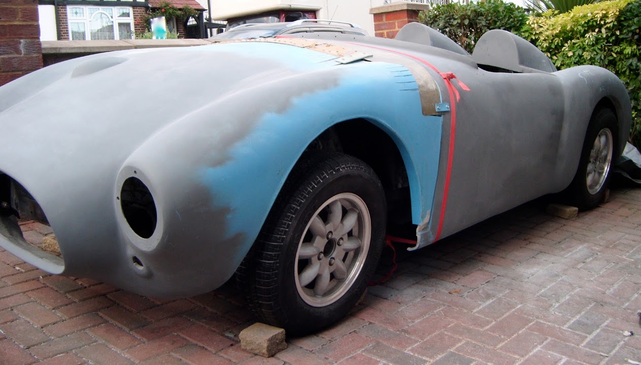

Front Wheel Arches:
Forget working outside, the biggest pain I face when build this car is my sloping driveway. :icon_sad:
It is constantly playing tricks with my perception of what is "straight".
So in my head, the slope of the drive was setting the wheels at significantly different heights relative to the arches.
Passenger Side:
Driver's Side:
( Sorry the front wall stops me taking a matching photo. )
So how could I be sure where to measure the new arches from?
Thankfully I worked out a simple solution involving a bit of cardboard.
As the key "level" for me is the flat edges of the Spitfire bulkhead.
This is the line I want to use as a marker for the top edge of the body shell extension.
So my simple "system" allowed me to take the cardboard to the driver's side and mark that for comparison.
To my utter amazement, the bulkhead to tyre level is with in a mm (or so) on both sides, practically spot on.
The next question was what size of a gap do I need to leave around the wheel.
I quickly checked my Mondeo arches and they have a 3" gap.
I then made another cardboard template cut at a 3" gap, but with a 2" gap marked in red.
The widest gap in the photo above is 1.5" from the arch to the cardboard (or 2.5" to the red line).
I might actually split the difference and re-set the arches at 2.5" as the car is not at full "racing weight" yet.
Either way, any reduction in the current "gaping hole" has got to be a good thing.
In addition to adjusting the size of the arches, the front edge needs to be "tucked in" a bit.
As the "return" is not at 90 degrees at the front of the arch, compared to the rear.

Front Wheel Arches - Take 2:
I went back to my cardboard templates and extended the lines from the bulkhead "levels".
So even if I set a 3" gap, I would still need to make a "drop" join between the body shell and bonnet.
Which is similar to the way Mac did his.
Thankfully I spotted something else today, that I had missed yesterday.
I need the body shell extension to cover the Spitfire bulkhead and a 3" gap wouldn't cover it.
A bit of masking tape around the bottom corner and a cut in the template makes this easier to see.
So the maximum gap can't really be bigger than 2", which lead me to have yet another look at other cars.
Swifty's rear arch gap (seen in yesterday's post) is 40-45mm, which is 1.5 to 1.75".
I also would estimate that Mr T's front arches' gap is around the 2" mark.
Although Barry & Phil seem to have even less on their cars, again see photos in yesterday's post.
I even had a look at photos of Spitfire 1500s and they do not have large gaps all round.
So the bottom line is that a 2" gap should be more than enough, even allowing for a bit of a drop when fully loaded.
I marked up what this would make the extension panel look like.

I spent a lot of time looking at the rear arches of modern cars in the area as I was going along.
Whilst the gap between the tyre and arch varied, they all had one thing in common, a nice round arch profile.
So if I go back to this photo for a minute...
"Just" bringing the front arches in to that red line would still make a HUGE improvement over what I have now.
The other thing that occurred to me is that if I build a 2" gap, fitting larger wheels would still be an option in the future.
( I am sticking with the brand new 13" wheels & tyres that came with my donor for now. )
The other thought that I had requires one of my dodgy sketches.
I built a new scuttle section over the top of my Spitfire bulkhead, which makes it higher than Swifty, Mac, etc.
So it might be better to make the body shell extension shorter, thus making the join with the bonnet "chunkier".
What do you think?

Whilst the primer was drying, I separated the new rear bonnet edge from the mould.
Before giving all the edges a quick trim / tidy.
Then it was time to see how close this was to the final rear bonnet edge profile I need to achieve.
Early indications are that I am at least in the right ball park, as the edge will sit a bit higher when a rubber strip is added to the scuttle lip.
Although at this point the outside edges had not been trimmed to match the angled profile of the scuttle.
So trimming the outside edges were the first cuts I needed to make.
Then after a bit more cutting and trimming I was getting closer.

Bonnet Butchery - Part 2:
Because as soon as I cleared one area, something else would get in the way. :icon_evil:
I had to hack a bit off the front edge of the passenger side body work.
Although having now cleared that, the rear edge got in the way and needed trimming. :rolleyes:
Eventually the bonnet looked like this.
Which gave enough room for the new edge to be joined to it.
Although I still had a few undulations to deal with.
At one point I though it would be easier to create the "dips" between the wheel arches and raised bonnet centre.
Thankfully, I remembered that whilst this would work on the passenger side, the master cylinder is in the way on the other side.
So I simply cut a number of slits along the rear of the bonnet.
These will allow me to lower the centre section a bit, and then raise the edges either side of this section a bit too.
I temporarily screwed in both ends of the new rear edge to the body shell.
Before joining the two sections together along the centre of the bonnet.
As with previous "cut & shut" work, I will cover the gaps on the underside...
Before grinding out the "scar" and adding extra fibreglass along the join on the sunny side.
The good news is that the undulations in the middle of the bonnet have now been tamed.
The bad news is that both ends of the bonnet are currently a complete mismatch. :icon_sad:

Bonnet Butchery - Part 3:
When the foam is removed, the bonnet edge will drop slightly.
I will also be adding fibreglass / filler to improve transition from flat (ish) scuttle to sloping bonnet.
Even though this is clearly still under construction, the final shape is starting to appear.
By the time I've finished with the bonnet edge, wheel arches gap & body shell extension it should look pretty good. :cool:
If the weather holds tomorrow, I will at least make a start on healing the wound.
Until then, take care, Paul. :)
