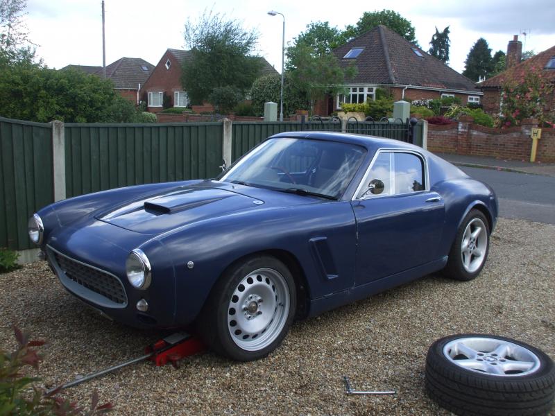

Your car looks great lowered,
Please can you state what is written on the front and rear wheels regarding the ET, the rear 17 x 9" style 18 wheels were fitted to 5 series e39 cars and have an ET of 26, the z3 was fitted with 17 x 8.5" rears with an ET of 41
Many thanks
Bill
Hi Bill,
Quite right,
The rears are 8 1/2 x 17 1092508
Fronts 7 1/2 x 17 1182732
The new steels are 7 1/2 x 17 EH2 6783330 176001 34/10
Hope that helps a bit.
18 May 2015, 7:18pm
Thanks Bob
Having pictures of your car to bounce ideas off is great,
I'm planning to fit some fondmetal 7 x 15" Jaguar alloys with an ET of 20, they will be 15mm wider at the front than yours and 23mm narrower if I swap to the Z4 hubs to bring the rear track in
18 May 2015, 7:25pm
Nice looking wheels, if you can get them to sit in the arches nicely, they'll look great, especially with the spinners.
Bob.

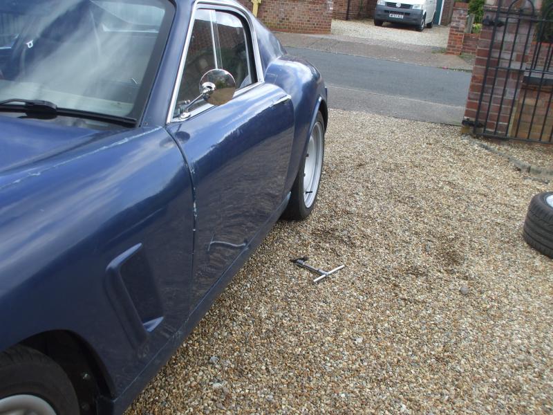

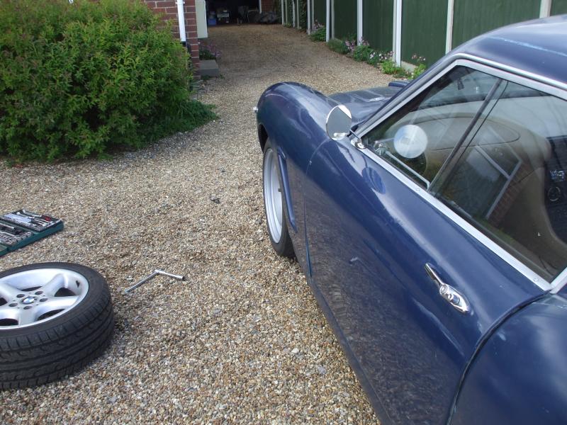

19 May 2015, 10:17am

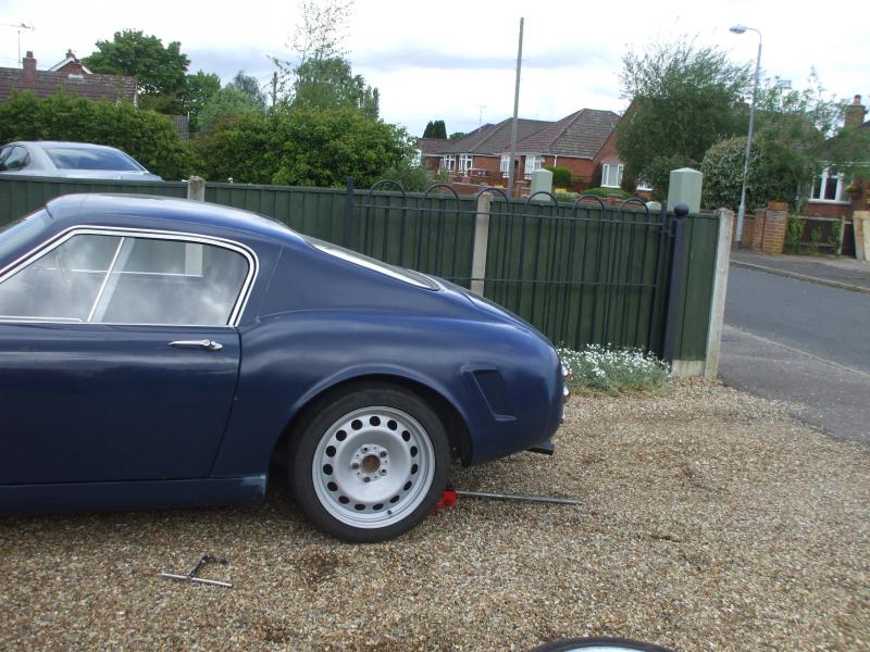

Trial fitted the steel wheel today.
I'm happy with the appearance and the way it sits in the arches so these are what I'm going with. A mix of modern tyre sizes and traditional looks.
Next job is to start adapting the centre towers to fit with the spinners.

now I could be wrong but they do look like VW T5 steels I had them on my bus when I first got it they are 5x120 fitting
19 May 2015, 1:53pm
The steel wheels look period correct and absolutely nice!!!
19 May 2015, 4:39pm
I've always believed that the wheels "make the car", and this is certainly very obvious here, they look fabulous.
19 May 2015, 4:42pm
Agreed, they really look the part and will keep people guessing about the origin of the car. Will look even better with the spinners fitted. :)

Thanks for your comments guys.
They do look very similar to VW T5 steels but are genuine BMW wheels, usually sold as winter wheels.

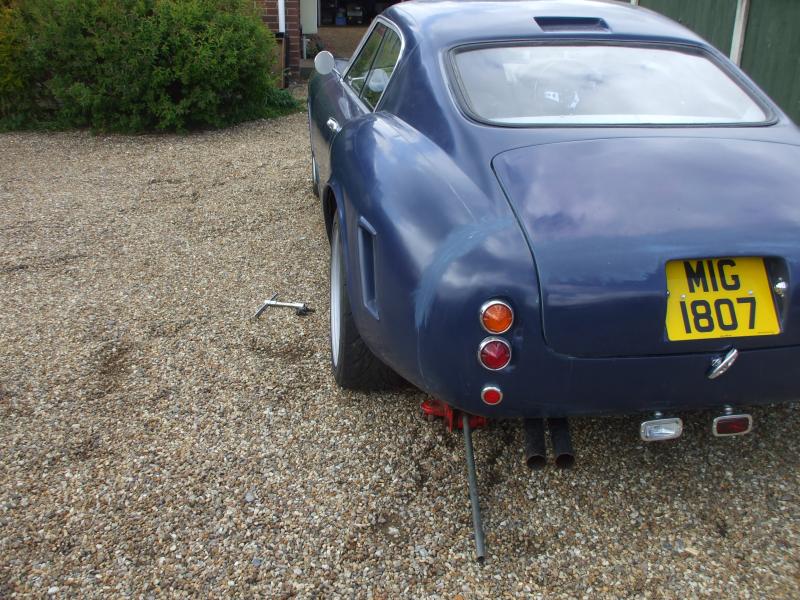

22 May 2015, 4:36pm
Hi all,
Just a little note to say that I'm pleased with the lower suspension but after a very short distance one of the rear s/abs top mounts, which looked fine at the time, has failed. I've had both sides replaced to be on the safe side and would suggest you consider this yourself if lowering.
cheers, Bob.
22 May 2015, 4:41pm
Do you think the mounts have broken because your new suspension is firmer than standard, or is it so low that it's bottoming out and transferring the load to the shell?
22 May 2015, 5:07pm
It's not been bottoming out so i assume it's a combination of firmer suspension and being pulled about when things were changed.
It's had genuine BMW replacement mounts fitted so hopefully it won't happen again.

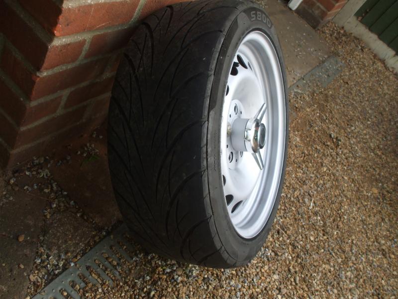

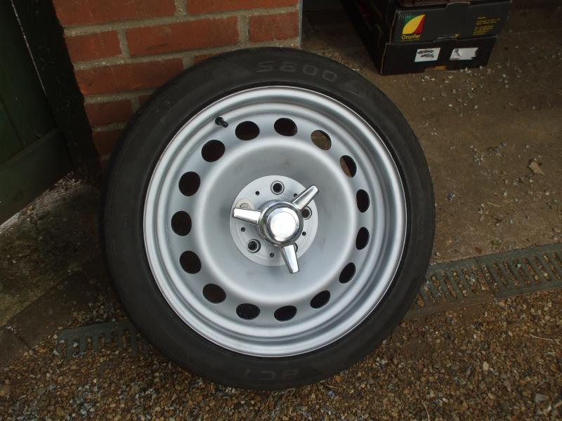

I'm progressing with the wheels.
I've cut down the spinner towers and sleeved them inside and out to regain the strength. On the outside with a piece of alloy tube from a scrap light fitting and on the inside with guttering downpipe, and fixed with body panel glue.
The 5 large holes were opened out and will surround the wheel nuts but not interfere with them
The 5 smaller holes were drilled to line up with the small holes in the wheel. Short studs will be welded into the holes in the wheels and the towers will be held on with acorn nuts.
A bit of adjusting and some better paint and hopefully they'll look ok.
