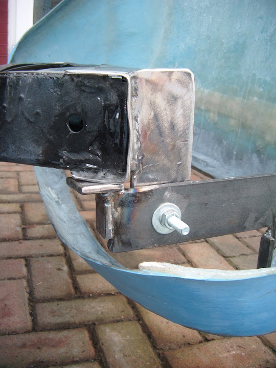

I shamelessly stole/copied the ‘scissor hinge’ design that Mister Towed used on his Spyder.
There were two parts, one attached to the framework bonded inside the grille opening.
The other was welded to the chassis (in line with the re-body bracket rules).
I know there are differences between the Spitfire and Herald chassis,
But I added a "bonnet stop" to the bottom of my hinges.
Here are some more photos of the hinges in action (I did fit a shorter bolt eventually :rolleyes:).
Event today, I still enjoy opening the bonnet on hinges I made myself. :cool:

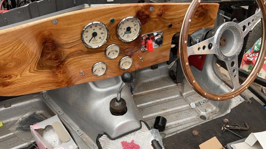

slartibartfast - Now this is what I call a wooden dash. :cool:

I have used Smiths instruments with a magnolia face which I purchased from Europa Specialist Spares. I now have the tacho and fuel gauges working but need a little advice on the speedo. This came with a XS108B3PAL2 proximity sensor which didn't come with any instructions. I'm fairly confident on mounting this close to the bolt heads on the prop shaft but wondering how I should connect the 3 wires. The brown wire is positive, which I'm guessing should go through a fuse. The wires are all very thin and I'm thinking of something like a 1 or 2 amp in line fuse. I've done some on line research but can't seem to get any answers. Can anyone out there offer some advice. ?

been having some good productive time in "the office". All dials working including the speedo.
