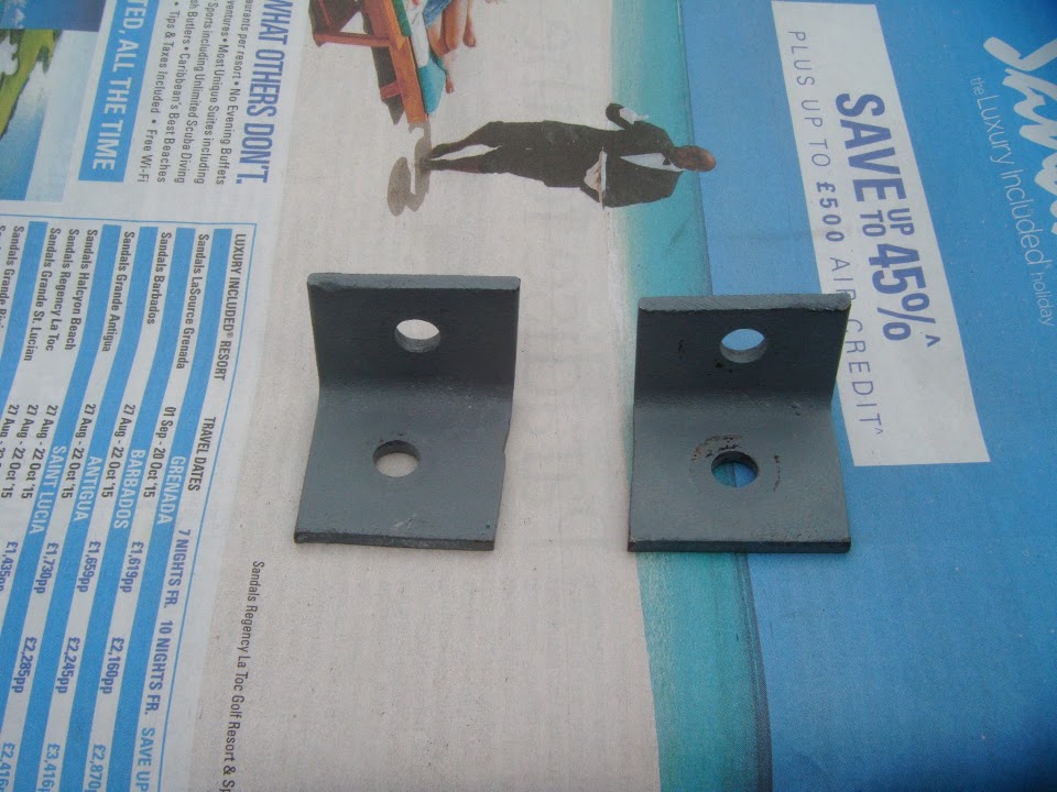

Removed the brackets that hold the tail pipe rubber mounts to the boot floor support bracket.
Gave them a few coats of stone guard.
