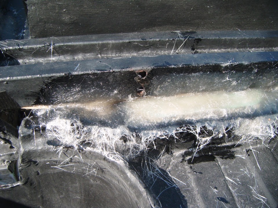

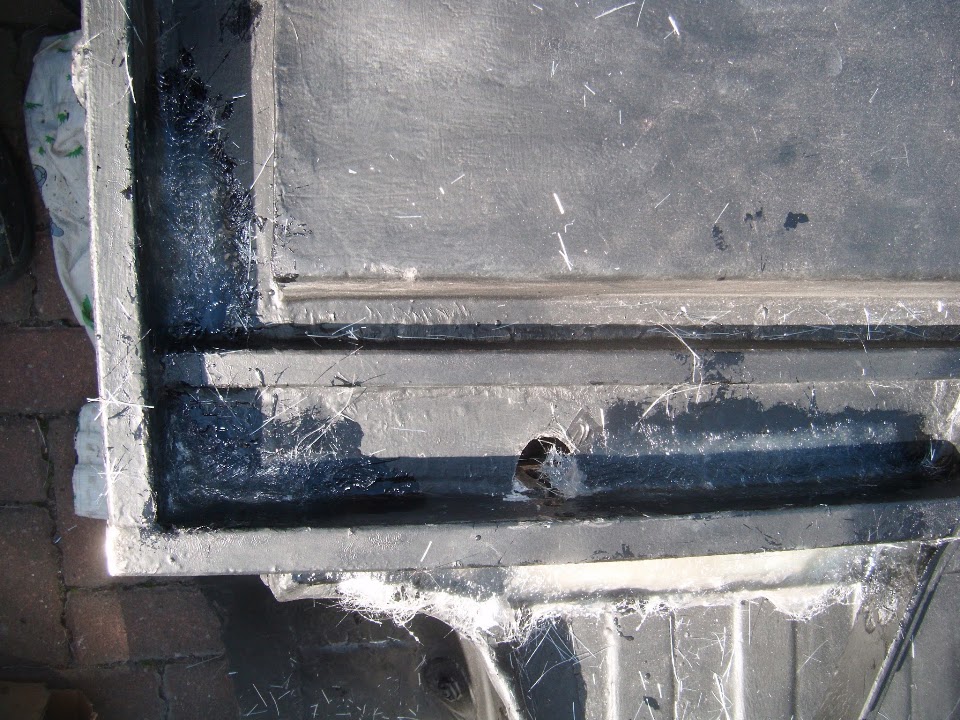

Floor, Frame Work & Rear Wheel Arches:
I removed this bracket so I could start working on the passenger side.
It was a straight forward job to prepare three of the holes for fibre glassing.
But I then spent ages trying to work out a way of preparing this hole, using hardboard, cardboard & yoga mat.
In the end my solutions were getting more complicated by the minute. :rolleyes:
Until finally it dawned on me that I don't actually need a solution that sits "flush".
Instead I could make an oversize piece like this that would sit on top of the "hole".
So I then cut out a section from one of my fibreglass off cuts.
That slotted into place like so.
Unfortunately, I forgot to reduce the catalyst mix for the first batch & it set too quickly in the heat. :rant:
So some matting & resin was wasted and I had to quickly peel off some matting that wasn't going to stick properly.
Thankfully the sunshine helped this first batch to set quickly and I could sand down the rough edges.
I adjusted the second batch to suit and that went on with no problems.

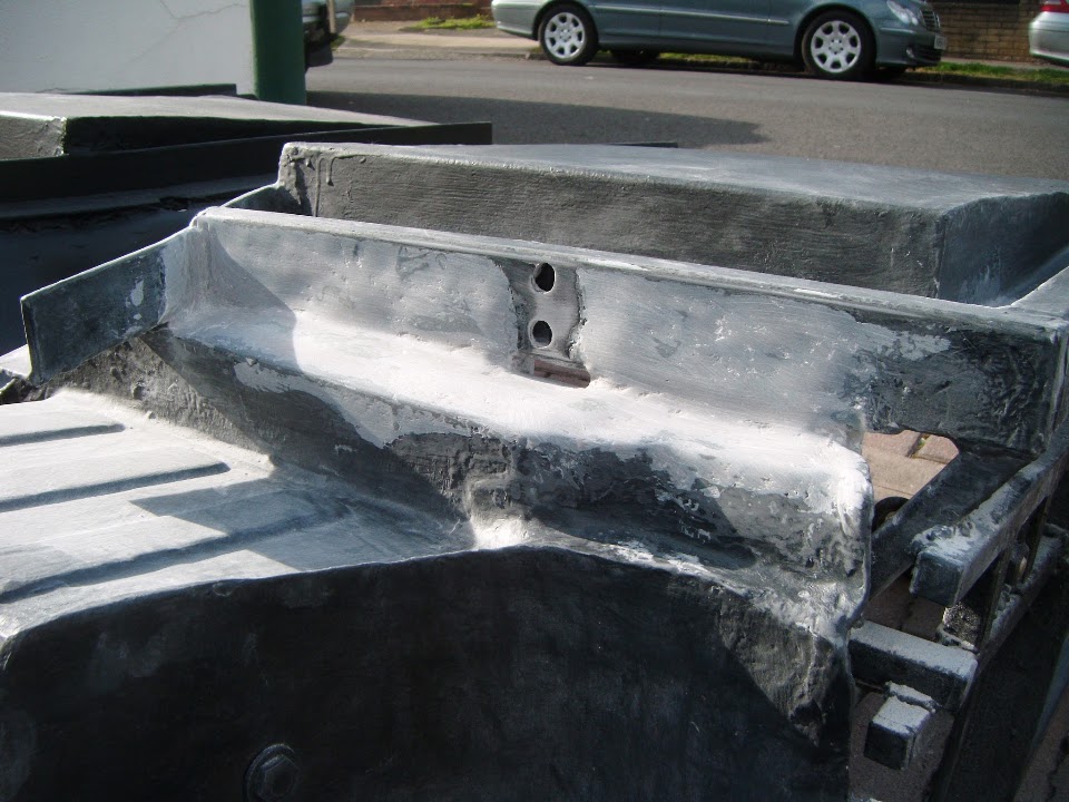

I removed the "formers" from the inside of the gaps in the passenger side floor.
Then I tidied up the fibreglass that I used to seal the gaps the other day.
Before adding a layer of fibreglass filler over the top.
Note:
I've left a gap around the area that I need to add the cut out section.
The last job of the day was to start sanding down this filler work.

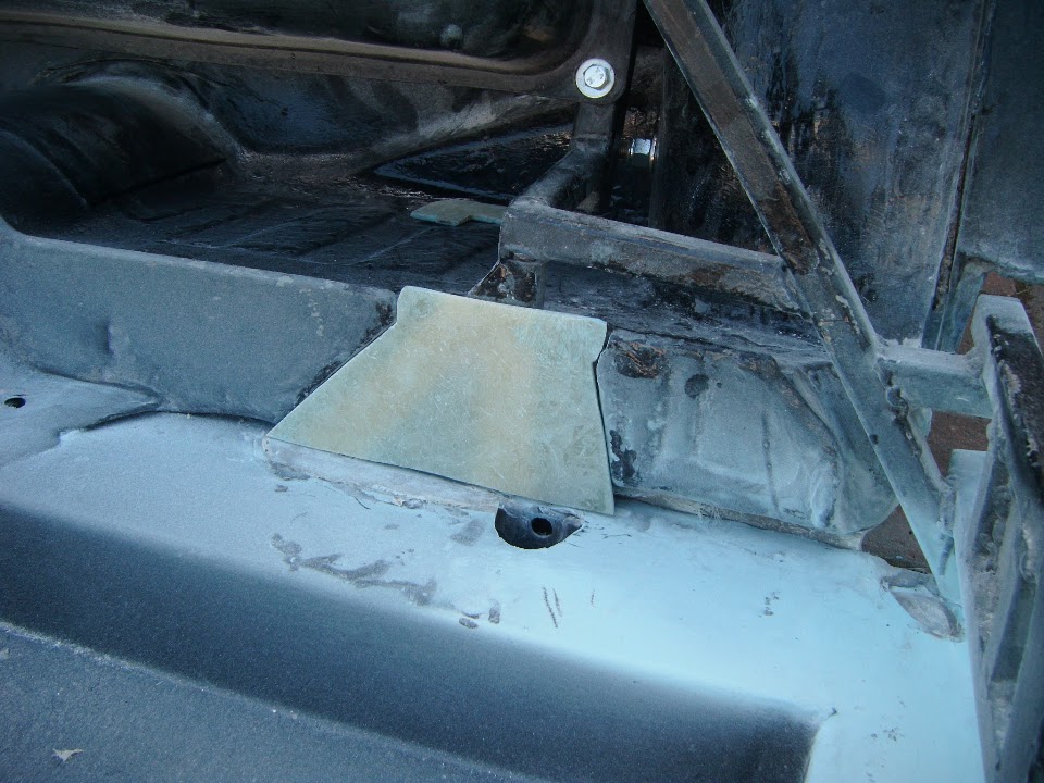

I also marked up the cut out section on the driver's side floor.
And drilled / cut / filed that shape.
The gaps in the floor on this side a lot smaller.
But there is still the big hole where the rear arches were cut around the framework.
Although this time I just had to "flip over" the cardboard template I made for the other side & trim it to fit.
Hopefully I will be able to cut out a section of fibreglass tomorrow and start sealing up this side.

Cut out a section of fibreglass to bridge the big "hole".
But before I started any fibreglass work, I cleaned up the edges around the open end of the framework nearby.
Then I cut the "cap" to shape and welded it into place & ground it down.
For now, the other end has been left with the plastic end cap in place.
( As unlike the other caps this size, this one actually stayed in place & didn't fall out. :rolleyes: )
The welded cap got a coat of etch primer.

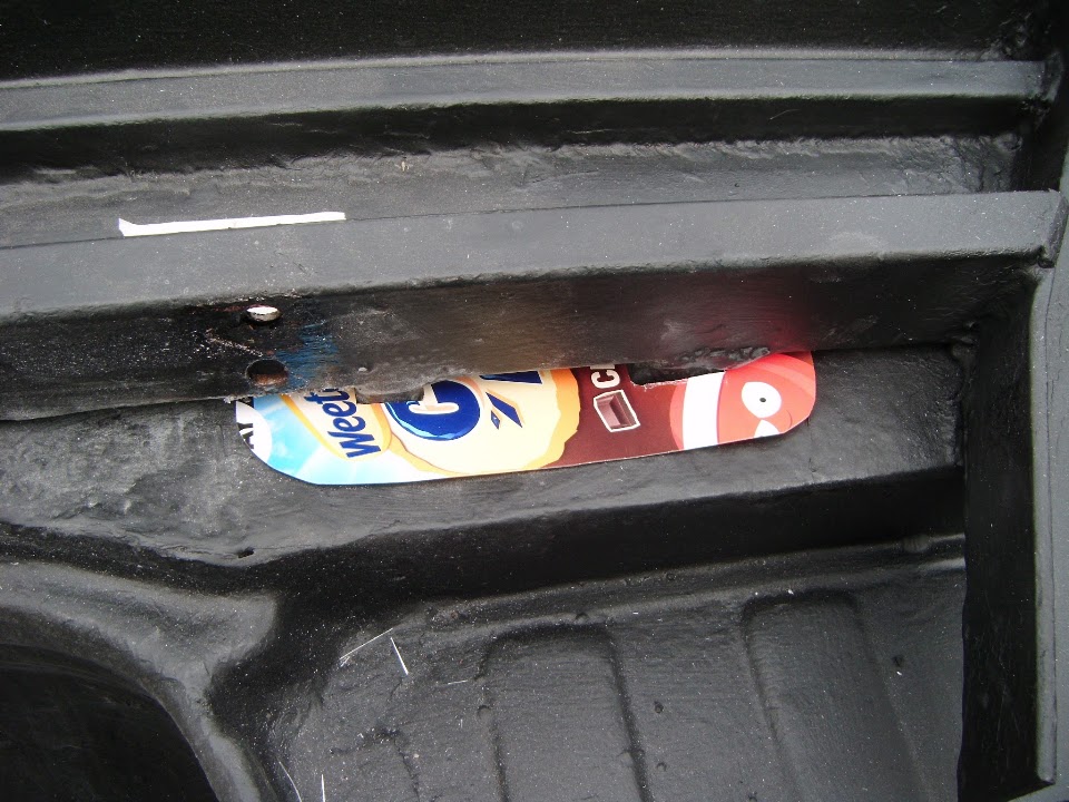

The formers for the small gaps around the floor were simple sections of cardboard covered with parcel tape.
Two sessions of fibre glassing later, and the gaps in the floor were sealed.
Plus the big hole was covered.

The area for the hollow on the passenger side just needed a bit of fibreglass filler in a small gap.
But the driver's side needed to be sorted out from underneath, as some matting has covered the top bolt hole. :icon_evil:
I was planning to leave this fix until tomorrow, but ended up making it the last job of the day.
I just needed to prop up the frame so I could get some power tools into position.
Now you can see / reach both bolt holes.
So I just needed to mix up another very small small batch of filler.
Which means I am now finally in a position to start the job I thought I would finish today. :rolleyes:

Change of Plans:
Today's work was hampered by an April shower and my wife just telling me her niece would be coming round tonight.
However, it started well enough as I sanded down the filler near the bolt holes in preparation for adding the "hollows".
I also made some more cardboard templates to extend the "face" of the rear arches on both sides.
Cut these templates out of what remains of the fibreglass front foot well.
It was hard to get a decent photo of the problem, but the passenger side is a bit "wonky".
So I've made a panel to sit in front of this and cover it completely, rather than an in fill panel.
Added parcel tape to the outside of the egg moulds and held them in place from the underside.
By using strips of matting it was easier to maintain the shape as I started building up the layers.
I had just finished the second fibre glassing session of the day when the shower arrived. :rant:
So I quickly got the cover on.

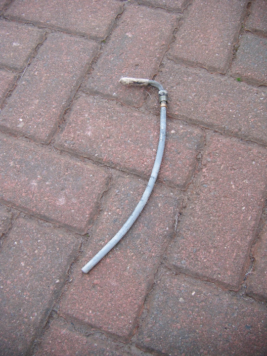

Petrol Tank:
Currently the fuel pipe points the wrong way.
Due to the fact the petrol tank is turned around to fit in the frame.
A very long time ago I bought a new "olive" so I could turn this pipe around.
I'd also bought a 8mm compression "stop end" for the vent pipe.
As my understanding is the tank is vented via the petrol cap & this vent was designed for the US market.
( Although please correct me if I am wrong. )
In the end I had to removed the fuel gauge sender.
So I could remove the pipe completely.
And refit it facing the other way.
This allowed me to work out the best route for the new flexible fuel line.

Frame/Arches/Floors:
There were a few small gaps around some parts of the framework like so.
So I added some fibreglass filler around the horizontal edge to seal them up.
Before adding a skim of normal body filler to the front edge.
Late on I was able to give that a rough sanding down.
Not easy to see in the photo, but the "hollow" has worked out really well. :cool:
Note:
This whole area still needs a bit more tidying up, but my main priority is the other side.
So there was another round of huffing and puffing to get the frame work upside down again.
This allowed access to remove the "egg" moulds.
There was still a gap on the passenger side (which is now sealed on the other side).
Plus I never got around to adding some filler over the fibreglass patches on the driver's side.
End of Part 1...

Mind The Gap - Part 2:
So a big batch of fibreglass filler was required to:
- Blend in the edges of the hollows.
- Fill in the small gap.
- Cover the fibreglass work on the driver's side.
Last job of the day was to sand this filler down.
Which did create a bit of a mess. :rolleyes:
So with a bit of luck, I should be able to start the painting process on this side tomorrow.
