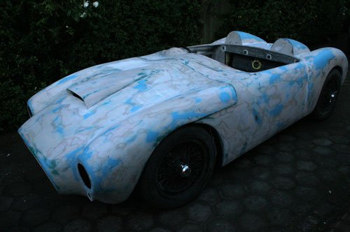

Ohh the filler issue may be a problem for me, i was not aware of the expansion issues so may be in the summer i will have problems.
Could be problems ahead :peep:
If the filler has been put over the Gel coat and not old paint then you should be ok, modern polyester primer surfacers, and 2k primers have come a long way in the last 10 - 20 years.
Shrinkage tends to happen when you prime over old paint, the solvents in the primer eat in to the edges and soften the old paint causing it to shrink.
Cellulose was very bad for this which is why most body shops will not entertain it anymore.
Making sure the primer is fully cured is also very important, more so with Polyester which should only ever be dry flatted, never wet.
I totally agree with the comments regarding heat will bring any air bubbles to the surface, this is why fiberglass bodies are never baked in an oven.
Dampness is also an enemy of paint work, micro blister in paint is 99 times out of 100 due to moisture either in the air during priming, Primer being left too long before paint being applied,( primer is porous) or moisture in the air line.
Hope this helps ?

Thanks Jeff for the good advice. So is it a good or bad thing to 'cure' a fibreglass bodyshell in a heated spray booth before prep and paint?
Also, referring to your polyester comment, and assuming a polyester resin is being used rather than epoxy resin, are you recommending that prep is done dry rather than wet?
Cheers, Steve
28 Feb 2016, 3:32pm
Steve,
The polyester primer is a spray filler, it is designed to fill pin holes and undulations in the filler work, so in the same way that you would not wet flat body filler, it is recommended that this stuff is dry flatted.
After this is applied I then use normal 2k primer, this is also a dry flat system but can be wet flatted without problems provided you don't leave it wet all over
ie, wet flat one panel then dry before moving on to the next.
I have very limited experience with moulding Techniques,( I am a panel beater/ painter) I have taken moulds from car panels and reproduced them with a reasonable amount of success.
I always thought that the longer a panel was left in the mould the better it cured, saying that I have painted race car panels the next day from the mould with no problems.

Okay let we help with the confusion over painting and prepping GRP.
The problem is 99% of bodyshops in the UK work with metal or plastic parts. GRP has to be treated in a different way. There are many old wives tales but this is from my experience.
You should not use water with wet and dry when sanding GRP. Dry sand only. This is because the GRP can absorb moisture which will hide under the paint till it has a car cover put on it (and moisture collects underneath the cover which seems to draw out the water under the paint skin) or the sun comes out. This will cause micro blistering. The water expands and stretches the paint and no amount of T-cut or popping them with a pin or heating with a hair dryer will get rid of them. This also happens if you spray outside with a high moisture content in the air. As the paint droplets fly through the air they pick up microscopic water droplets. This is another cause of micro blistering. All you can do is sanding off and repaint.
28 Feb 2016, 6:49pm
Now the air bubbles WCA was talking about is a completely different problem. These are caused at the manufacturing (of the GRP) stage. It the GRP is mixed and applied too quickly to the mould, air pockets can form in the mix. The same can happen if the GRP is mixed when its too hot.
Once this has happened its a ticking time bomb. Usually you paint the car and it looks stunning. Then when the sun comes out (rare I know) the air in the pockets expands stretching the paint even more than micro blisters. It looks like rust under the paint. Heating it up with a heat gun or popping the air bubble (so water can get in when it rains or you wash it) isnt going to help. You then have to 'dig out the pockets and fill with fibreglass paste (NOT normal filler).
To stop this happening either put the car in the sun for a few hours or a spray booth on heat to 30-40 degrees for an hour or two. If any appear fill and then primer.

Now the comment which caused all the fuss in the first place concerns filler on GRP.
From my experience no matter how modern or expensive a filler is, it will not contract through hot and cold to as much a degree as GRP. Filler on a metal wing for example there is virtually no expansion and contraction so the filler stays put. The GRP seems to 'breathe' in and out. The thinner it is the worse this gets. The solution is to use where possible fibreglass filler (which expands and contracts closer to the GRP panel) with the thinnest of regular filler to smooth the surface. To be fair the Tribute products are fairly thick (especially the Z300s) but still stick to the process above and you will not get any heartaches.
Another tip is always squeeze the hardener tube from end to end a few times to thoroughly mix the hardener before use. So few do this and it does have any effect (obviously) on the quality of your filler and ultimately the final finish.
