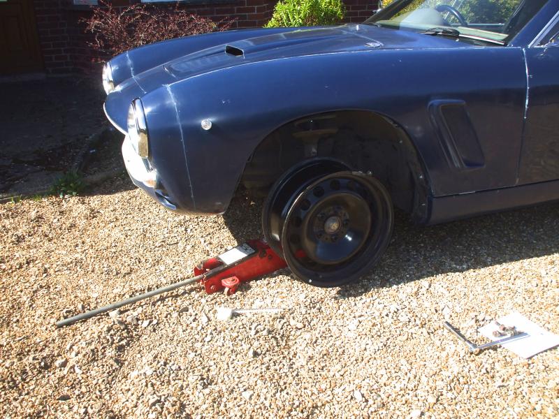

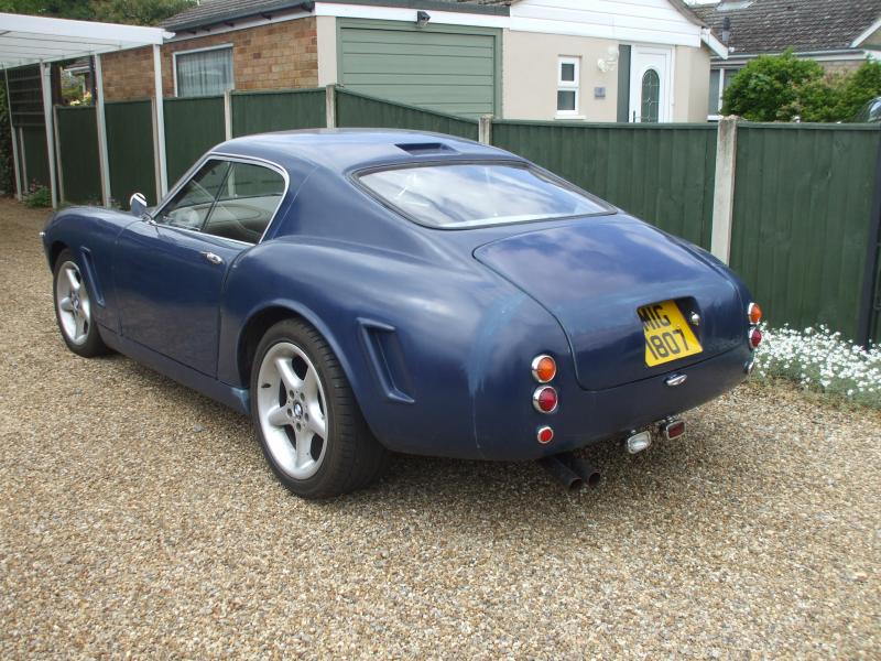

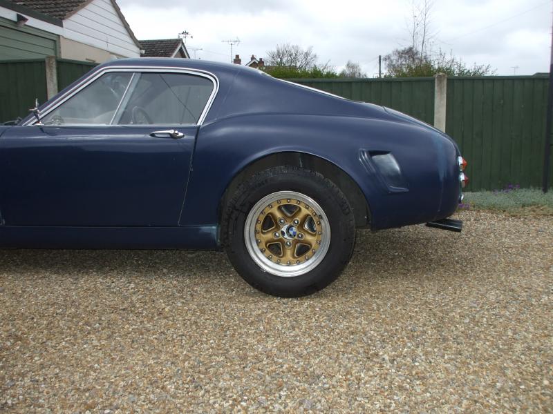

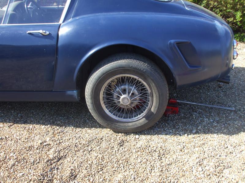

1st picture is how the standard alloy sits in the rear arch.

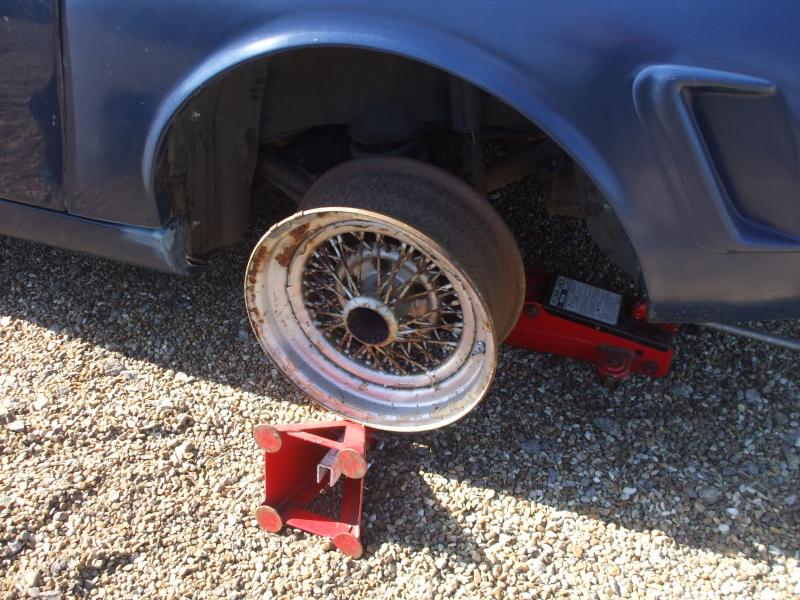

Jaguar 15" wire wheel, balanced in as would need longer bolts.
American 15" wire wheel, one of a set of 4 which may be for sale. Ideal for 'rat look' car. Again, balanced as longer studs needed.

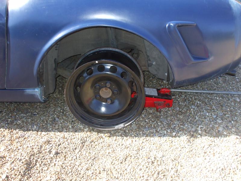

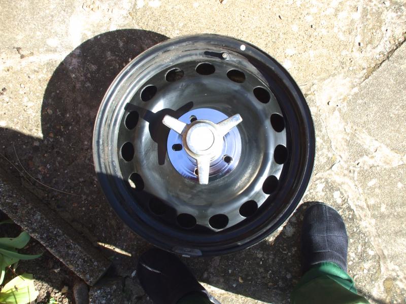

17" BMW steels.

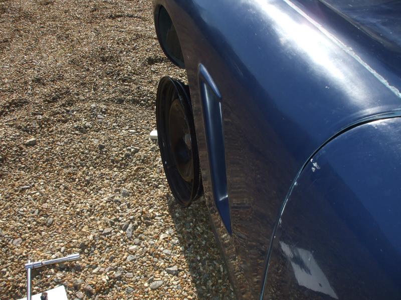

A nice fit under the arch in my opinion as they have the same outside offset as the alloys. I'll use these with some new tyres as my rear ones will be too wide.
Outside offset and overall width on the front is the same as the alloys.

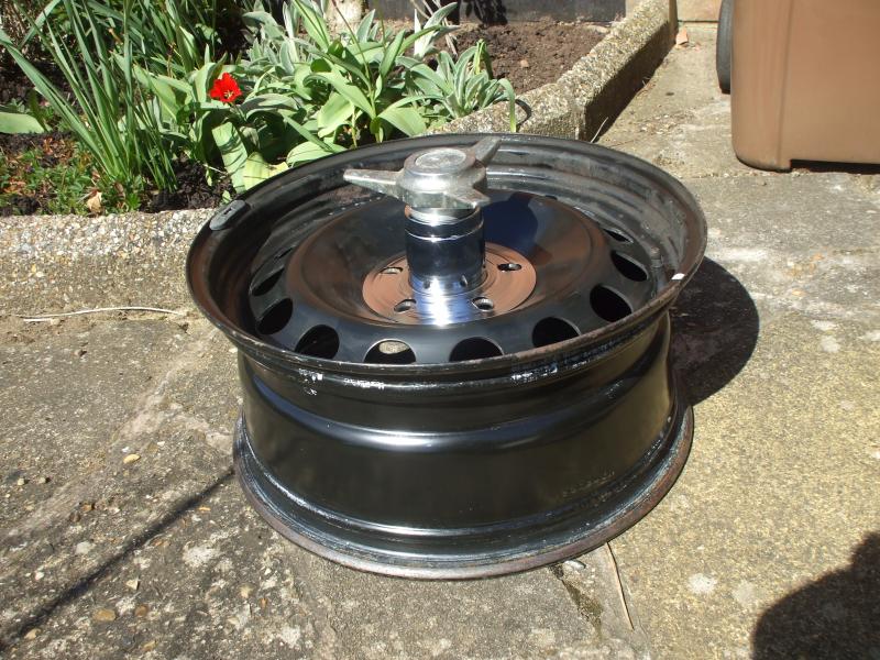

Not sure what to do about spinners yet as the wheels are a snug fit on the hubs so there may not be room to fit a tower in between.
I've mocked up fitting them to the outside of the wheel and they look good
and they should keep pedestrians away!

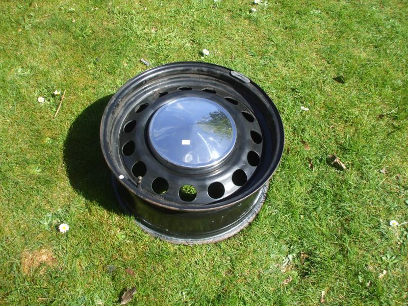

A couple of other options, both fairly unlikely.
Or maybe spider caps.

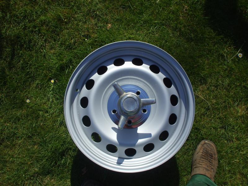

Wheels are sorted. I'm settled on the 17" steels. We've worked a way to bolt the (shortened) towers on and I'll get some better spinners.

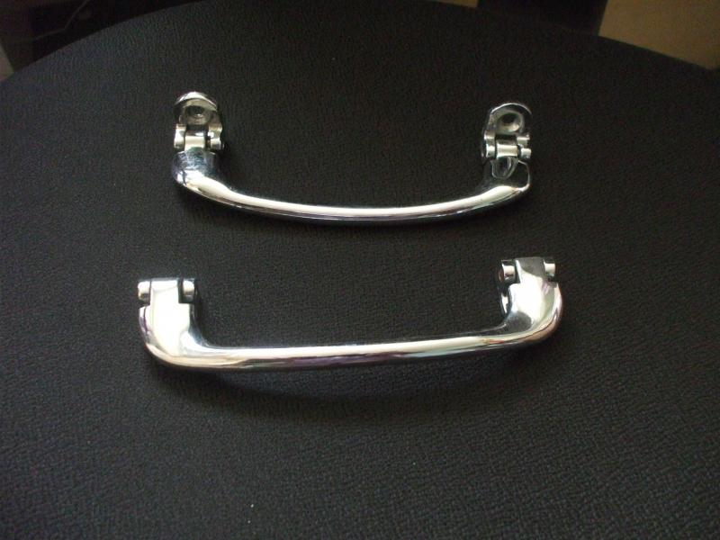

As I buy and sell auto jumble for my living, I'm always on the look out for nice little bits for my project cars. A couple of pairs of these interior handles where in this weeks buys and I'll keep a pair in my "things to possibly use when I do the interior" pile along with some nice perspex sun visors and old style interior light. All these are from a Rover P3, I think.

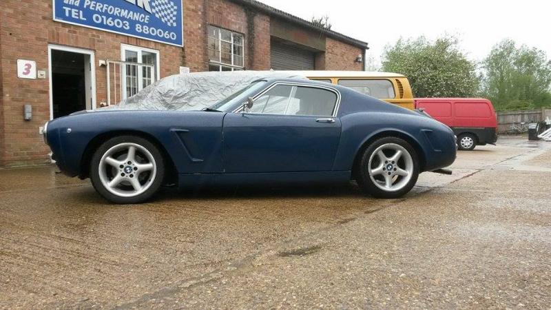

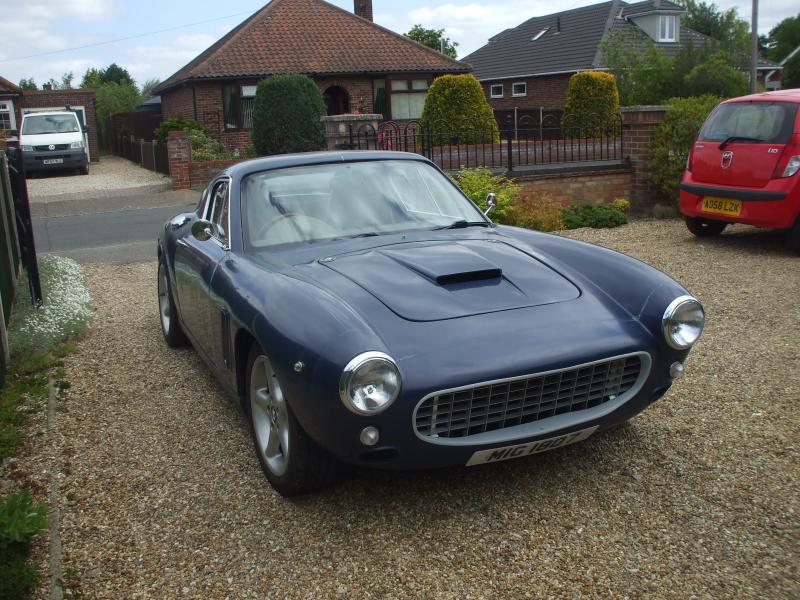

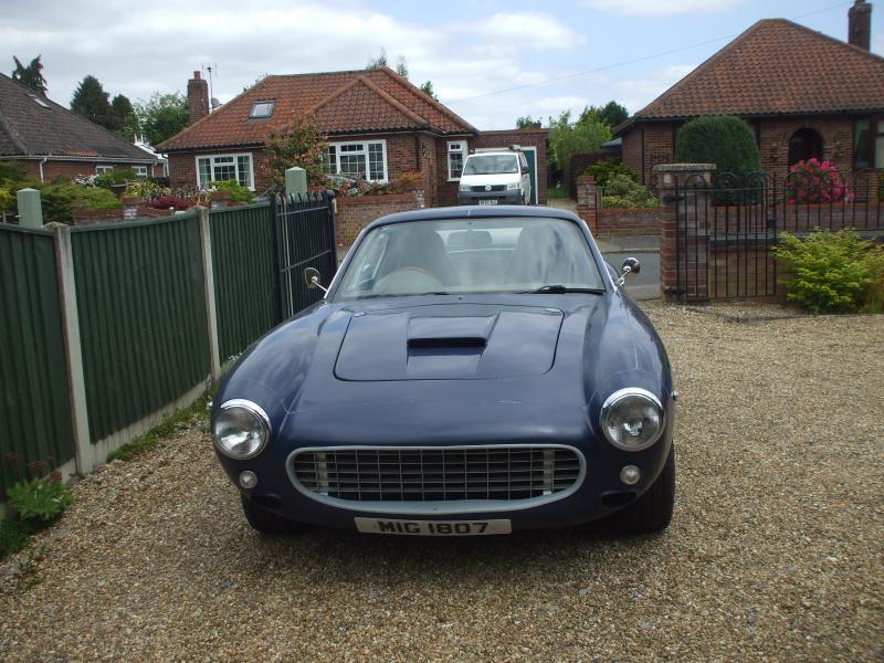

While I've been away on holiday this week the adjustable coil overs and steering wheel have been fitted by Power and Performance.
I'll pick the car up tomorrow and hopefully the suspension isn't now too hard.
Woodrim will be fine for now but will probably be replaced when I'm sure I can get comfortable with a larger one.

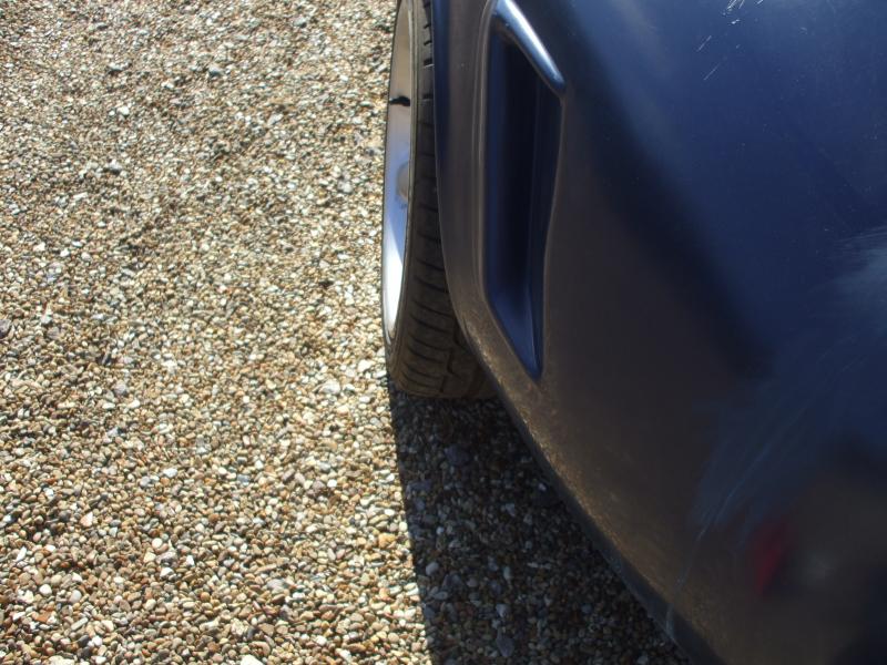

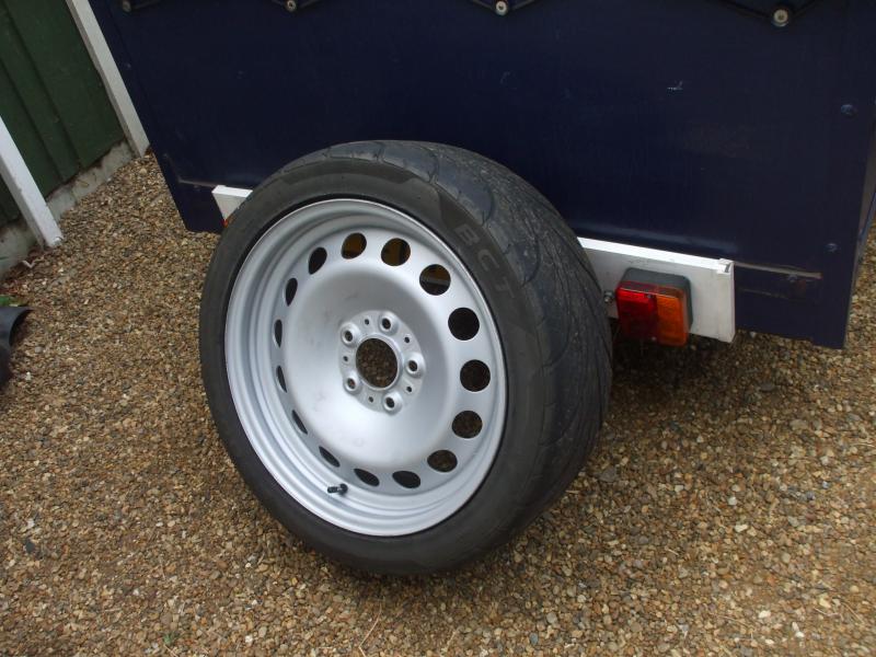

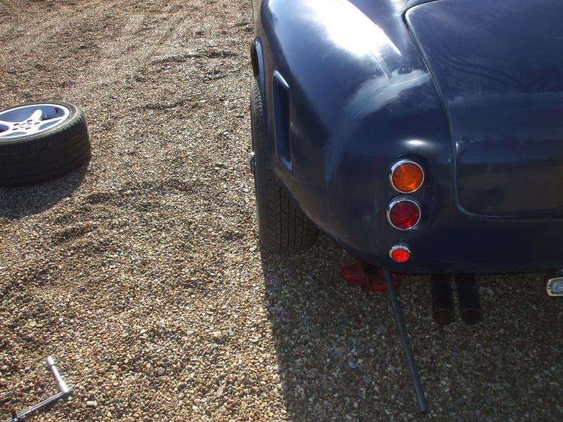

My local tyre dealer has put a scrap tyre, of the same size as my original front ones, onto one of my 17" steels so later this week I'll try it on the front and back to see how it looks (my rear alloys were 9", the steels are 7 1/2")
I'll post photos of the results so all can like / discount the idea from their projects.
I'm pleased with the lower look but will now have to take large speed humps over one edge. Hitting them full on, even at low speed, did cause a nasty scrapping noise. Oh well, no pain no gain.
18 May 2015, 6:24pm
Bob
Your car looks great lowered,
Please can you state what is written on the front and rear wheels regarding the ET, the rear 17 x 9" style 18 wheels were fitted to 5 series e39 cars and have an ET of 26, the z3 was fitted with 17 x 8.5" rears with an ET of 41
Many thanks
Bill
18 May 2015, 6:51pm
The car definately looks more purposeful lowered
