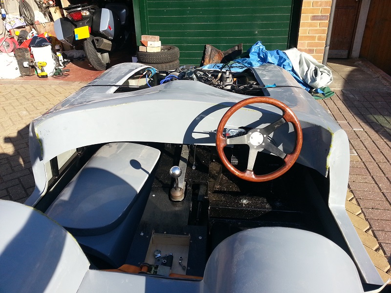

The body arrived today...
Fits well, after cutting the slots for the rear outriggers and steering column. even the wheel arches seemed to line up.
but... my eagerness to get things done before the body arrived may have backfired a little as the battery access is now non-existent and the steering column needs to be about 50mm longer :twitch:
Anyway, I will have a go at some of these bits over the next few days, and hopefully if the weather stays dry at the weekend, I might get it all bonded on! :icon_mrgreen:

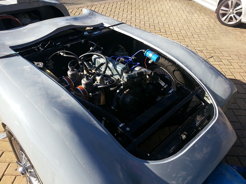

I am envious have you cut the front springs looking really good dave r:amen:

yes, I cut the front springs down by 70mm and not lowered the rear at all yet. I might get the 25mm lowering block for the rear - that should be enough..
