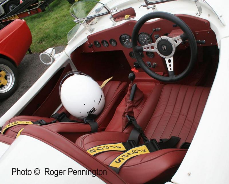

The white G46 had a nicely finished interior.

The white car certainly has a nicely finished interior but I plan to go for a much more basic 50's racer style.

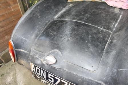

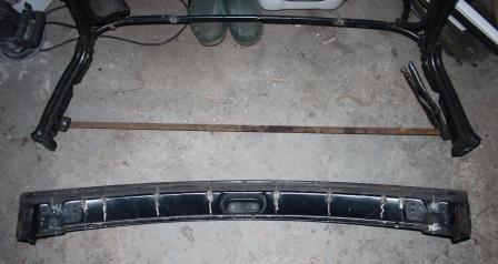

I wanted a bigger boot to get the spare wheel in so put the rub down on hold.

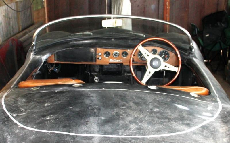

I have also be at those unseen jobs, such as finishing the rear inner wheel arches, making sure the bonnet fits flush at the top, aligning the doors, fitting the behind the seat trim panels. Adjusting the steering wheel height and position. Trimming the door opening and flowing the shape of the dash into the doors.
Boot Before
Boot After
It's MOT is due again this week so the photos show how little time I have spent on it.
House maintenance has taken priority so just a few drives through the muddy countryside.

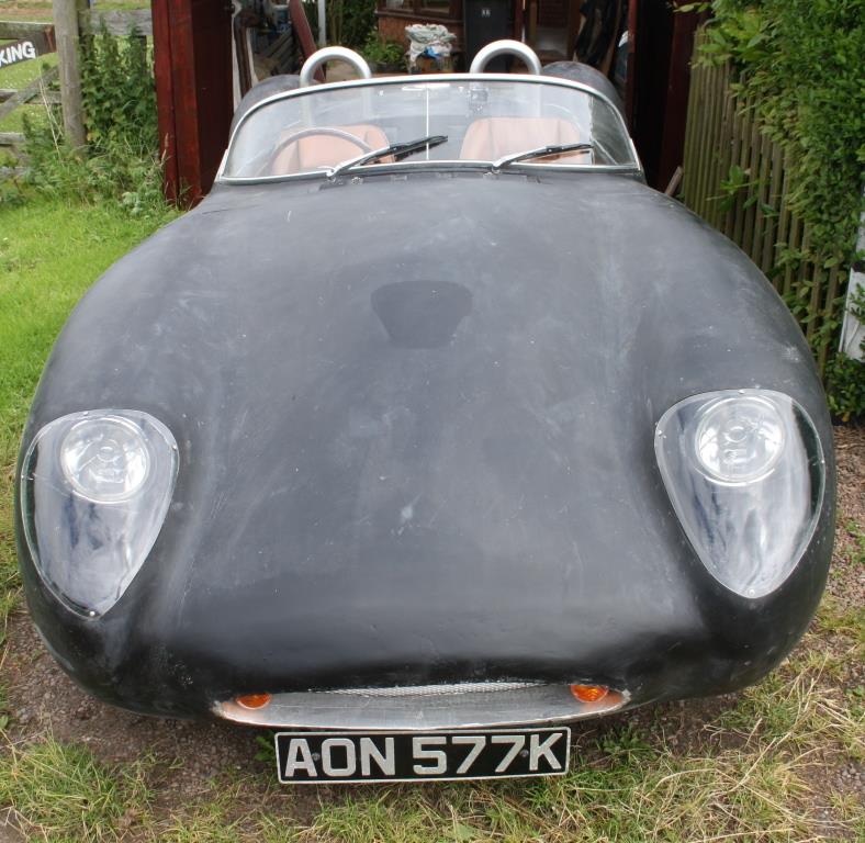

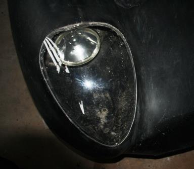

It does now have lights covers so the bowls don't fill with water!
but the engine has developed a troublesome habit of stalling on the overrun with very low oil pressure at idle and I think it will have to drop the sump over the winter.

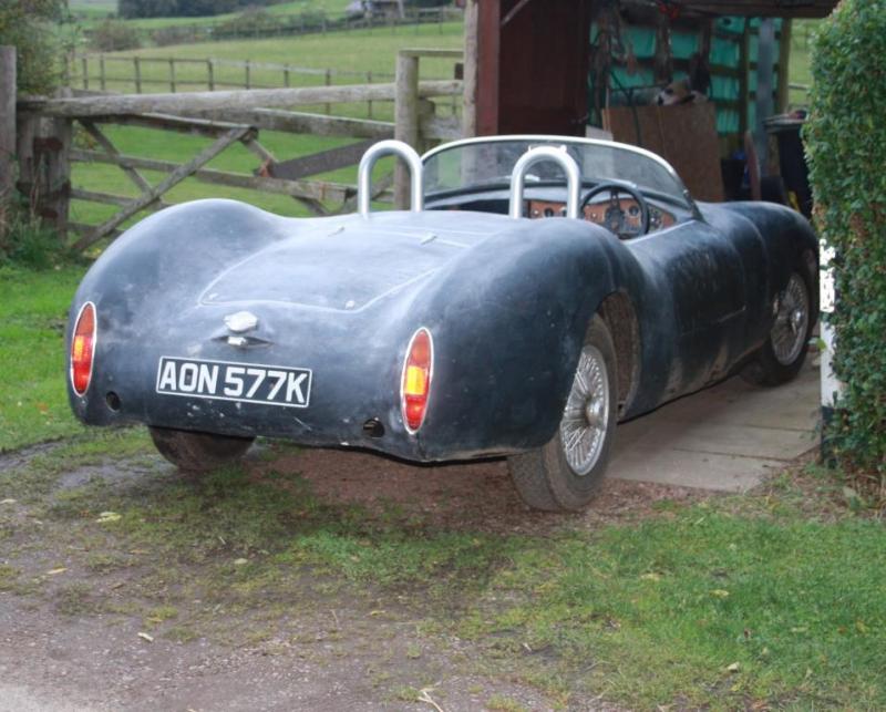

Without Hoops
With Hoops

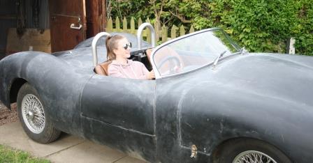

Someone else, however feels quite at home in the Spyder.
She cant wait to pass her test, so I have a dead line for the paint job of 2020!
She has offered her services for the photoshoot provided we go via McDonalds! :popcorn:

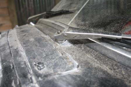

In my dreams I have a plan for a hood, so I am still working on the metal work behind the rear seats for fastening the hood loops.

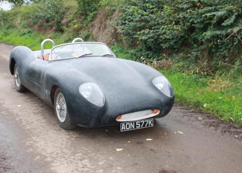

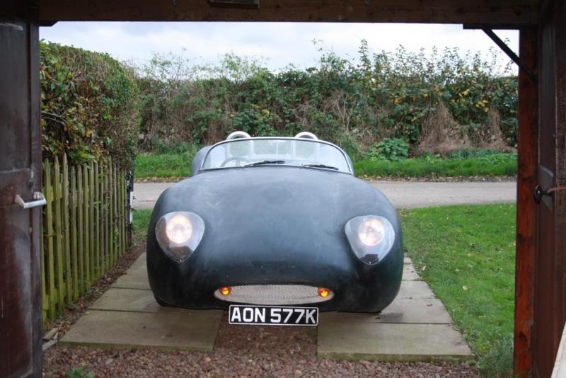

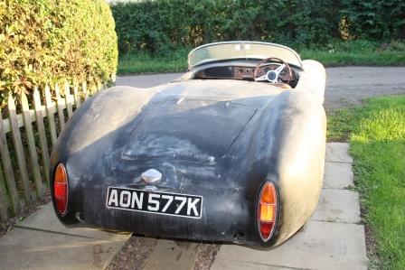

2018 Summer Update

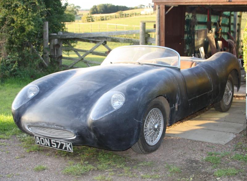

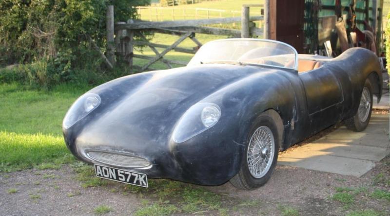

Year six and still no paint job.
MOT passed again with just more headlight adjustment to do.
New big end bearing shells fitted with the engine in the car by dropping the sump seems to have sorted the low oil pressure problems.
My wife is convinced I keep delaying to put off doing jobs inside the house.
I think that I will never be happy with the appearance of the body and tinkering at little things is just keeps me happy.
So below is lots more picture with very little changed.

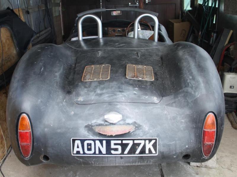

New steering wheel birthday present from my dad

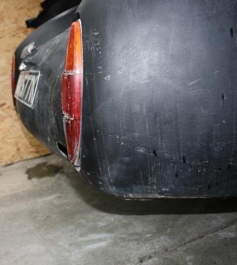

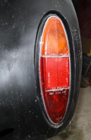

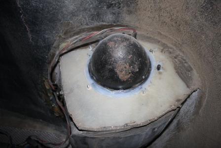

Finally modified the rear lights so I can get them out.
I had bolted them onto fibreglass backplates then bonded them into rear arches. The flush cut out was not big enough to get them back out!

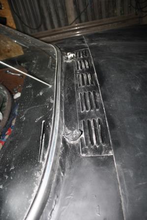

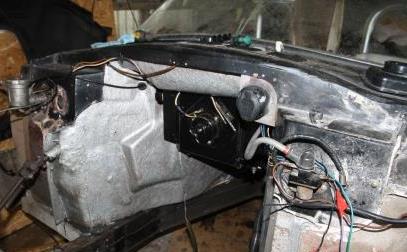

heater inlet grill was blanked off so no air got into the heater matrix, now sorted and nice cosy warm feet and slightly heated screen

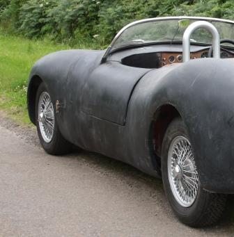

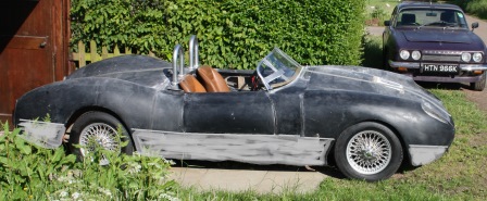

Passenger door alignment was bugging me so I have built up the body with fibreglass matting for a better fit.
The side skirts were always a little wavy so I took out the angle grinder and chopped them level with the scimitar sills. I am not sure this was a good idea, but at least i can lift the body off over the chassis rails now
drivers side sills before
passenger side sills
Driving around the muddy roads up north highlighted the back of the headlights were letting in brown water into the bowls and onto the covers so good old silicon sealant sorted that.
I have finished levelling the top right boot were the original mould had a head fairing so I am certainly near getting it sprayed now.
Yesterday I took the video camera for a ride so hopefully a little clip (10 seconds) of the beast in motion to follow.
HM

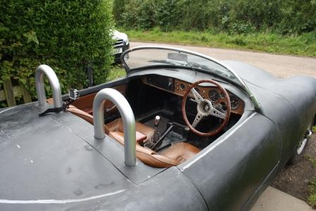

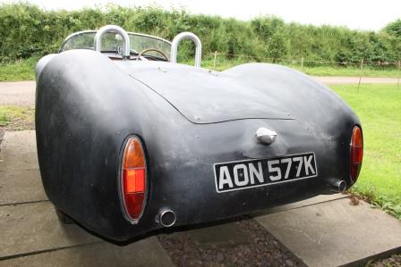

2019 Update
Another year and still no paint job.
However, I have put a few miles on during the summer.
Even managed to run out of petrol on the A1 going to the petrol station. :doh:
As I had to leave it at the road side while I walked with my empty petrol can.
It was not long before I got a lift from a curious petrol head who wanted to know about my 'jag'.
Fortunately they also had some jump leads as the battery went flat turning the V6 to fill the filter and carb.
It was a relief to hear it fire up and make to the the pumps.
Electric fuel pump now on order!
Fettling has involved:
Greasing rear wheel bearings which where noisy or right hand bends.
Re-tightening gearbox mounts to remove some vibration.
Replacing the master cyclinder and adjusting the brake pedal height/brake
light switch.
Raising the steering wheel to give easier access.
Fitting nice shiny exhaust ends
Modifying the dash switches so I now have:
Overdrive and wiper switches by the steering wheel.
headlightlights and heater fan by the passenger.

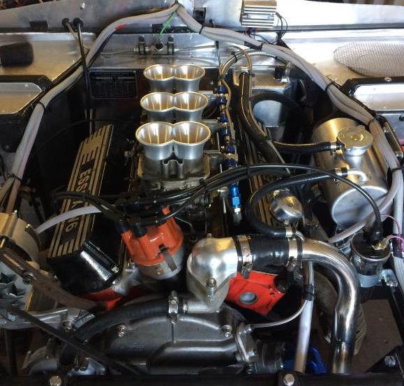

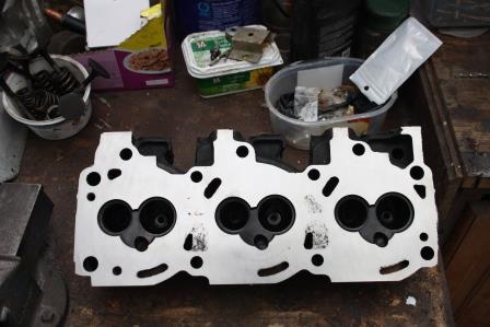

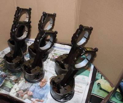

Oh yes, I removed the engine in the winter
Rebuilt it with new skimmed heads
new piston rings/honed bores and all lower bearings
So I know there will be no problem down there to worry about.

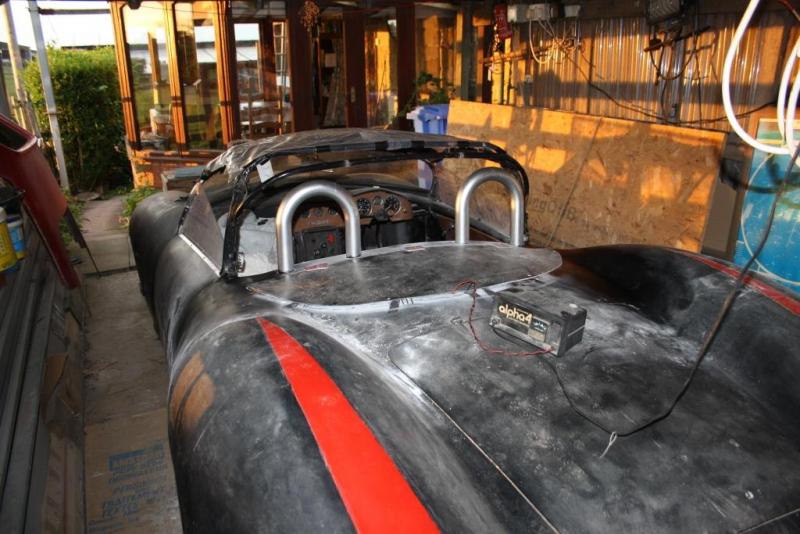

I am still messing around with an MX5 soft top to mount in the roll bar hoops.
I have reshaped the header rail to match the curve of the 356 screen and extended the door bars so I now have a frame.
But it is work in progress to get it to fold tidily.
Anyway that's all for now.
Maybe a paint job before next September..:flypig:

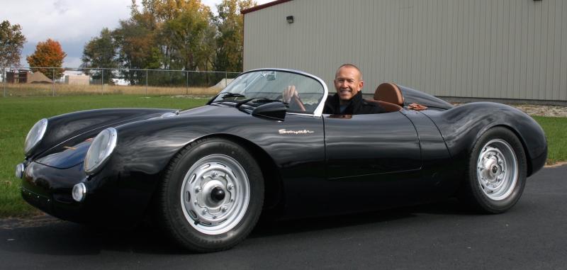

But with that porsche 550 windscreen i know silver will look great so i considered some barbecue additions
Maybe even a 2 tone

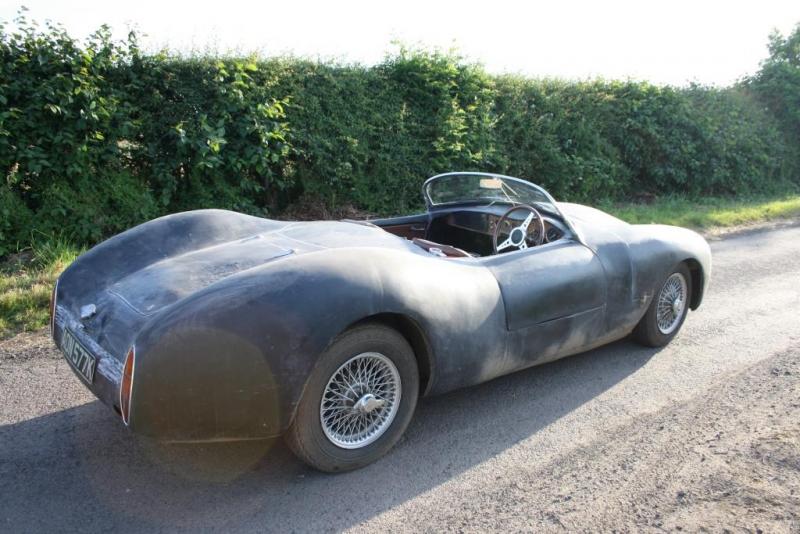

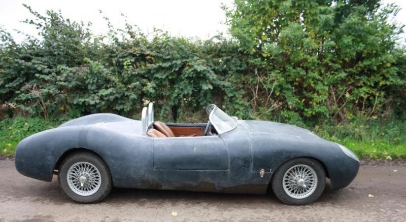

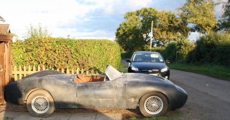

Finally got round to open that garage and take a Sunday drive.
Still no paint job apart from a couple of test spears on the rear.
I thought it might be called "big bastard" :icon_lol:
Parked by a prancing horse
Off for a drive on some empty country lanes :whoo:
7 Sep 2020, 10:20pm
HouseMartin – Good to see you out and about. :cool:
I probably already know the answer, but was the convertible top hard to do?

[IMG]c:/documents[/IMG]Should have my ex WCA car on the road this spring, rebuild has taken longer than hoped, work was hectic up to July when I managed to retire! Many other problems with the original build meant I ended up restarting from a bare chassis.
Now has steel body frame panelled in aluminum, twin circuit balance bar brakes, triple carb larg valve engine, rear disc brakes etc.

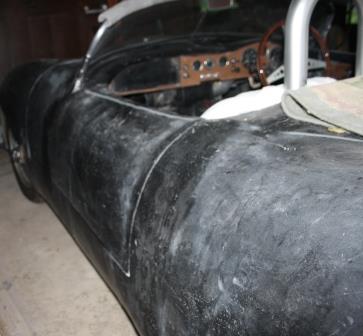

Paul, The soft top is still not done.
I have had to cut and stitch panels myself to make the mx5 cover fit.
When I am happy with the way it looks it will be used as a template for a professional cover.
My trial and error method is not recommended. :doh:
Steve, you have done a very profession job on that engine bay and interior.
Tripple Webers no less certainly make a very sexy engine. :tea:
You just need a ferrari tessa rossa clear engine bulges to show them off!
How much over 200bhp are you expecting it to put out?
I was very interested to see your frame bracing behind the rear seats.
What you are doing about the seat belt shoulder mounts with the body being so low at that point.
Maybe you have avoided that problem with the flat floor.
I have my battery behind the passenger seat so wondered if you have done the same?
Nice idea to have the external battery connector on the passenger bulkhead.

I look forward to some pictures of your dash

I reckon to be around 250hp with the engine spec.
I have full harness belts so shoulder straps are mounted to the rear cross member where the floor lifts up to boot level.
Battery is in the box visible in the rear bulkhead jpg.
