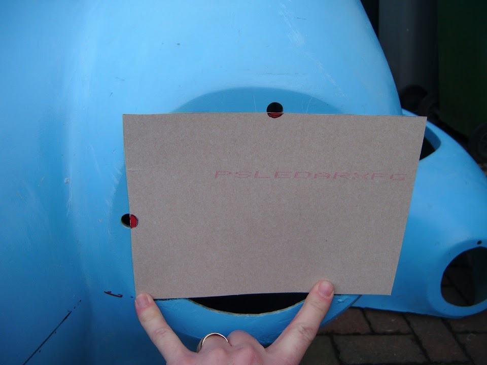

Because the other day Swifty had cut out the grille hole in his bonnet...
This allowed me to see that his front cross member is roughly in the middle of the hole.
So his bonnet nose sits lower that both Mac's & the original Ribble Cordite demonstrator.
Clearly Swifty has achieved this by cutting a hole in the bonnet so it drops down around the engine.
However, if you look at my bonnet, the hose opening is in a similar position without a big hole in the middle.
Despite mentioning clearing the radiator in my reply to Scottie above, the light bulb took a while to dimly glow. :rolleyes:
You see my bonnet will sit at a steeper angle than other Cordite\Navigators because my bulkhead is higher!
Which means that my nose is now at a slightly more aggressive "angle of attack".

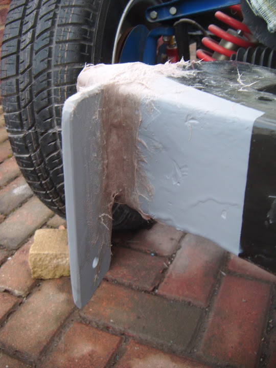

And here is a close up of one of the "bonnet stops" in action.
I might add a rubber "cushion" to the chassis for a bit of extra protection at some point.
But this flat surface will do a lot less damage than if I'd just left the side edge of the flat bar to hit the chassis each time the bonnet opened.

Added some fibreglass filler to the outside edges of both sides of the front cross member.
Plus either side of the welding on both hinge brackets.
Note:
The red streaks you can see in some photos is actually ink from the cereal box I was mixing the filler on, not unmixed hardener.

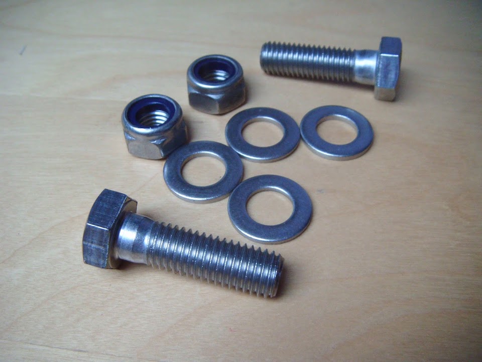

The "chunky" M12 bolts I ordered for the bonnet hinge pivot point have arrived. :cool:

Didn't get a chance to do anything on Friday and it was the afternoon before I got going today.
I spent ages checking & changing the marks on the bonnet nose relative to the chassis.
Then eventually I reached the point where that would have to do and I committed to a line.
Then I made a template to match the nose profile and head light distance.
Initially I marked the line on inside of a headlight rim so I could transfer it over.
But then remembered that the headlight areas were not mirror images of each other to begin with. :rolleyes:
So I made another template to link the "chassis" line with the headlight adjustment holes.
As I had already drilled these in a "best fit" position many moons ago.
This allowed me to match and mark up the horizontal line on the driver's headlight area.
