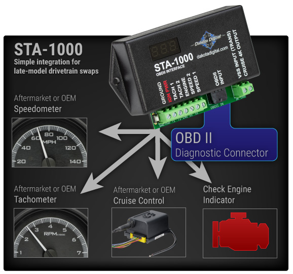

That looks doable, now can you find me some repro gauges that will work with the STA-1000
23 Feb 2017, 4:31pm
Make sure your Z3 has the OBD2 connection. Mine has the propriety BMW 16 pin type. You can still get aftermarket connecters but not much in the way of dashboard and dial controllers
23 Feb 2017, 9:09pm
It wouldn't be hard to retro fit old style gauges with matching sender units. The choice is endless.
